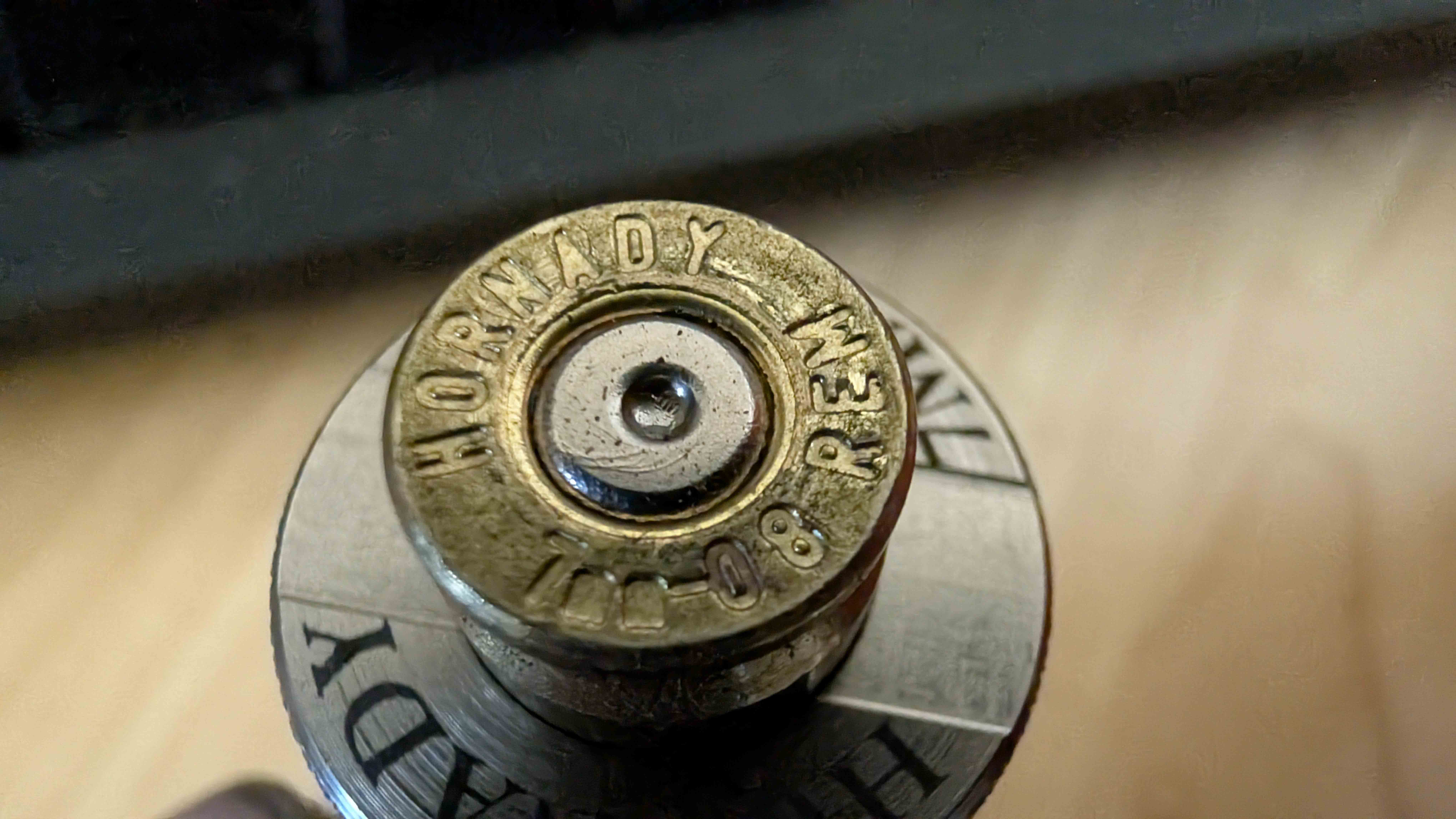

Next I checked the case length and compared to the Trim Length from the Hornady book (being its Hornady brass). Interestingly while I checked the 11th Ed. ADI book it listed a trim length too, surprisingly they matched.
I busted out the new case trimmer (this Hornady mini "lathe" with a mouse wheel handle that s**ts you to tears after two cases. Im buying the drill version for sure) and proceeded to trim them down to the Trim Length. First one was a complete disaster and I ripped it back like a foreskin at a Jewish brit milah. Lesson learnt there.
After that they were all spot on mouse wheeling away, very happy.

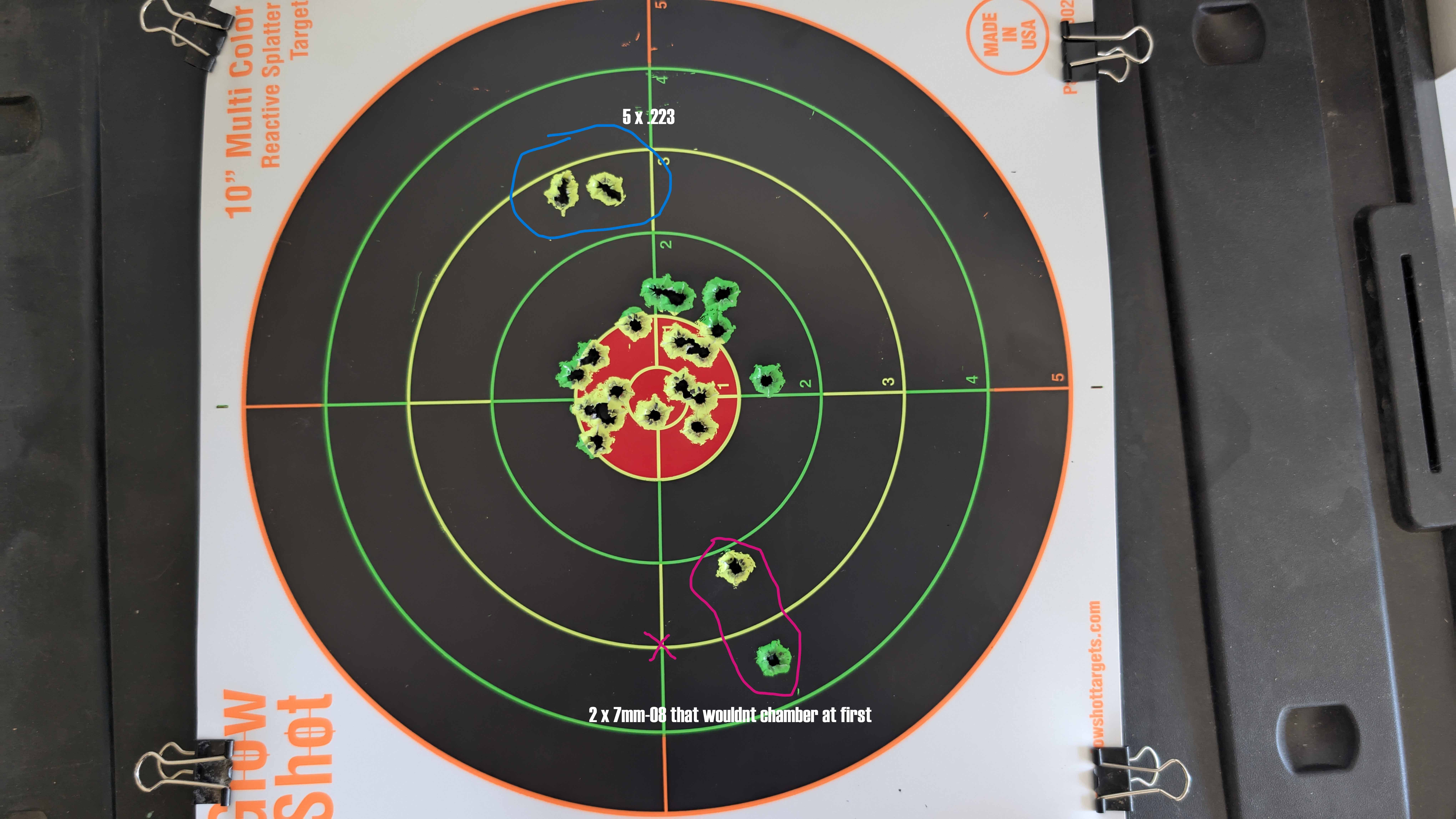

I made 5 of each from the starting load incrementing at 0.5 grain increments for 20 loads.
I then moved onto the .223. I was using old Winchester brass I had (cheap and chips. Dirty out of the box, totally see where they annealed it, looked nasty but shot ok)
Ran through the full resize and things were good. I decided some might need a double pump on the resizing die...yeah that made then stick out 0.5mm of the SAAMI case checker, so I didnt do that any more.
Cleaned the primer pockets perfectly and then went to insert the RUAG/RWS primers I had. First off I thought something was wrong (compared to the 7mm-08/308 primers) that just slipped in like butter. These wouldn't go in so I gave it a good crank on the universal RCBS primer tool and it went in but, it looked like the high pressure symptoms I have seen pics of. Flat, smeared and nasty. I did one more and called it quits, it scared me, it wasnt right.
I grabbed some new Hornady .223 brass I had (it was my backup) and tried a primer. In like Flynn. Perfect fit, firm but not stupid pressure and I could see the rounded edges of the primer.
Next was the powder and projectiles which seemed to go great. I only made 5 at the Starting load, What concerned me thought is the case fill (they call this headroom/space or something?), it was way up the top. I didnt hear any crunches or crispies when pushing the projectile in but if I shake it, I cant hear the powder. At that point I didnt want to do any more until I checked with the gurus.
Fast forward to today and I thought I would double check my work. I have my glorious completely loaded but empty round I could use as a datum/zero/tare. So I put it on the scales and zero it, then start putting my rounds on ... all over the shop (but not over max loads).
Im guessing I should just wipe off the marker of 39.0, 39,5, 40.0,40.5 and just write what im measuring? ive sorted them in order and its a great progression but I really wanted a few rounds on each set load.
Or do I just pull the bullets on the lot and start again?

The brass with tight primers most likely has a crimp. There are tools for this.
If it's only a few a sharp knife if used correctly will do it or toss them I guess.

Couple of things - tight primer pockets may not be because of a factory crimp just as likely as they could be. Check for the tiny circumference pressed around the fired, still seated factory primer first, to indicate if a crimp is there. You can also see it on an unfired cartridge.
A lot of factory rounds coming from the US now in 223/5.56 have crimps. You don't see it much in 308 unless you buy cheap military spec ammo, I notice ADI has a 147gn FMJ load that is crimped lately.
It becomes immediately obvious forever onwards, once you have seen it.
You can go out and buy a primer pocket uniformer too that will remove it (just ensure you use it carefully and turn it squarely into the pocket to make sure you don't enlarge the pocket).
This tool is great to have in your kit and doesn't cost much.
Alternatively, you can carefully use a sharp drill bit, by hand, to chamfer the primer pocket to remove the crimp. Or, if you have a "countersink" in your workshop, that will do it probably easier and smoother. These are great to use on a slow speed in your cordless drill.

Post by jezzab » 18 Feb 2025, 3:58 pm
I'll take a pic of the target, it's just one. I'll be embarrassed but that's fine (and the $44 Bunnings folding bench I got this morning. *Insert Other Excuses Here*). Still getting used to the bigger calibers and recoil. I shoot 22LR at home daily plinking and im getting "ok" at 60m over the back of a chair/fence (and better on the bench). Just need to work out how the hell to upload pics without it not liking me. I had some primer pics as well I tried but I gave up

Re: My reloading journey..
Post by jezzab » 18 Feb 2025, 4:12 pm
Fingers crossed (reduced with Photoshop)
EDIT: Ahh its a 750kB file limit
target annotated.jpg (714.3 KiB) Viewed 8721 times

Post by jezzab » 18 Feb 2025, 4:17 pm
7mm-08 39.0gr Primer:
7mm-08 - 39.0gr Primer.jpg (479.63 KiB) Viewed 8719 times
7mm-08 40.5gr Primer:
7mm-08 - 40.5gr Primer.jpg (501.13 KiB) Viewed 8719 times

Post by Oldbloke » 18 Feb 2025, 4:28 pm
Primers look normal to me.
Post by Oldbloke » 18 Feb 2025, 4:30 pm
I always use a new target for each load. Then write the load on the target. I file them in a lever arch folder for latter reference.
The 223 looks good.
Suggest u check the case length of the tight ones.
Post by jezzab » 18 Feb 2025, 4:40 pm
Oldbloke wrote:I always use a new target for each load. Then write the load on the target. I file them in a lever arch folder for latter reference.
The 223 looks good.
That's a great idea, I'll do that next time re: new targets per load.
Ok I'll check the case length, that makes sense.
