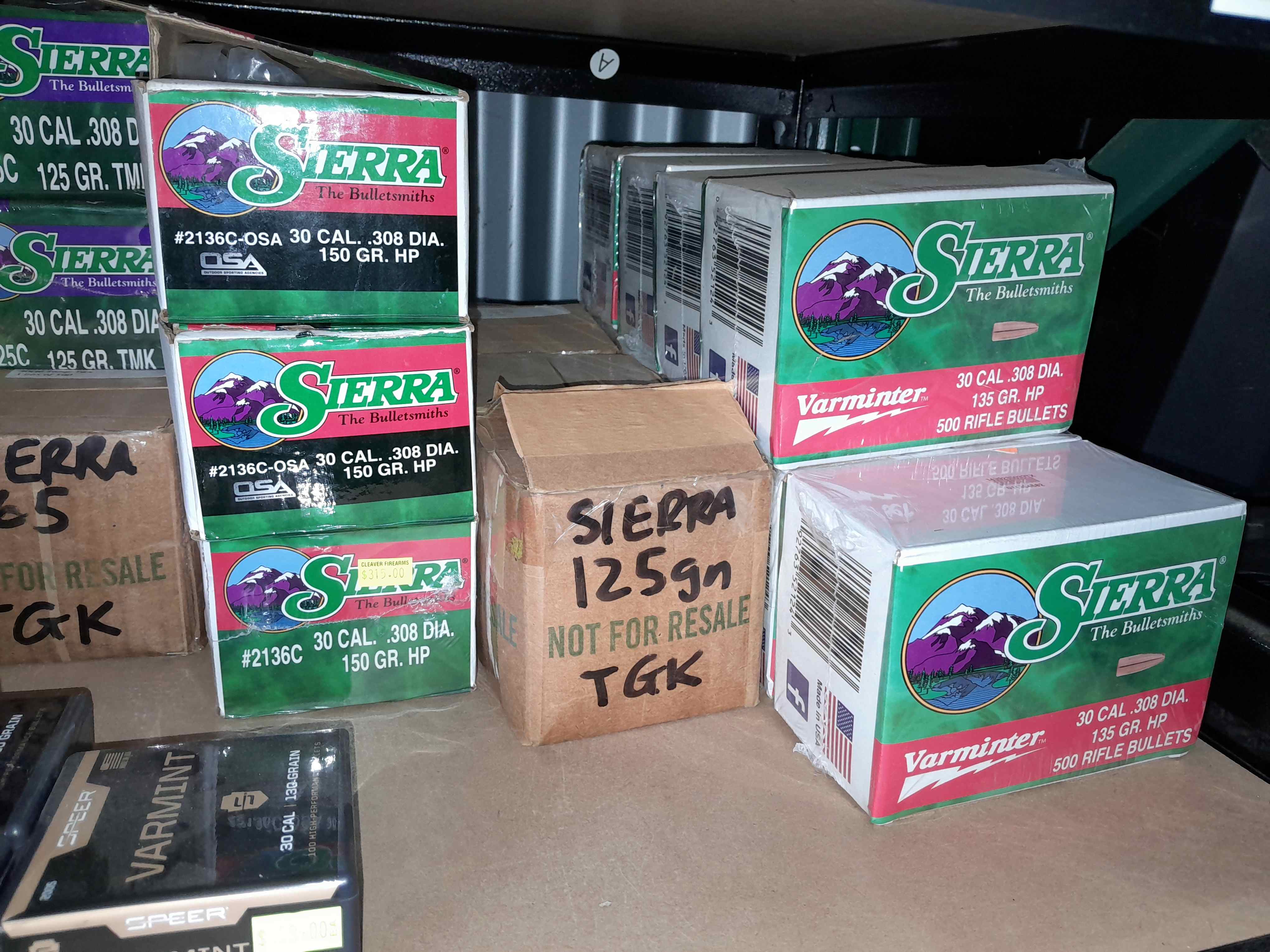

Post by Wapiti » 12 Sep 2025, 7:56 am

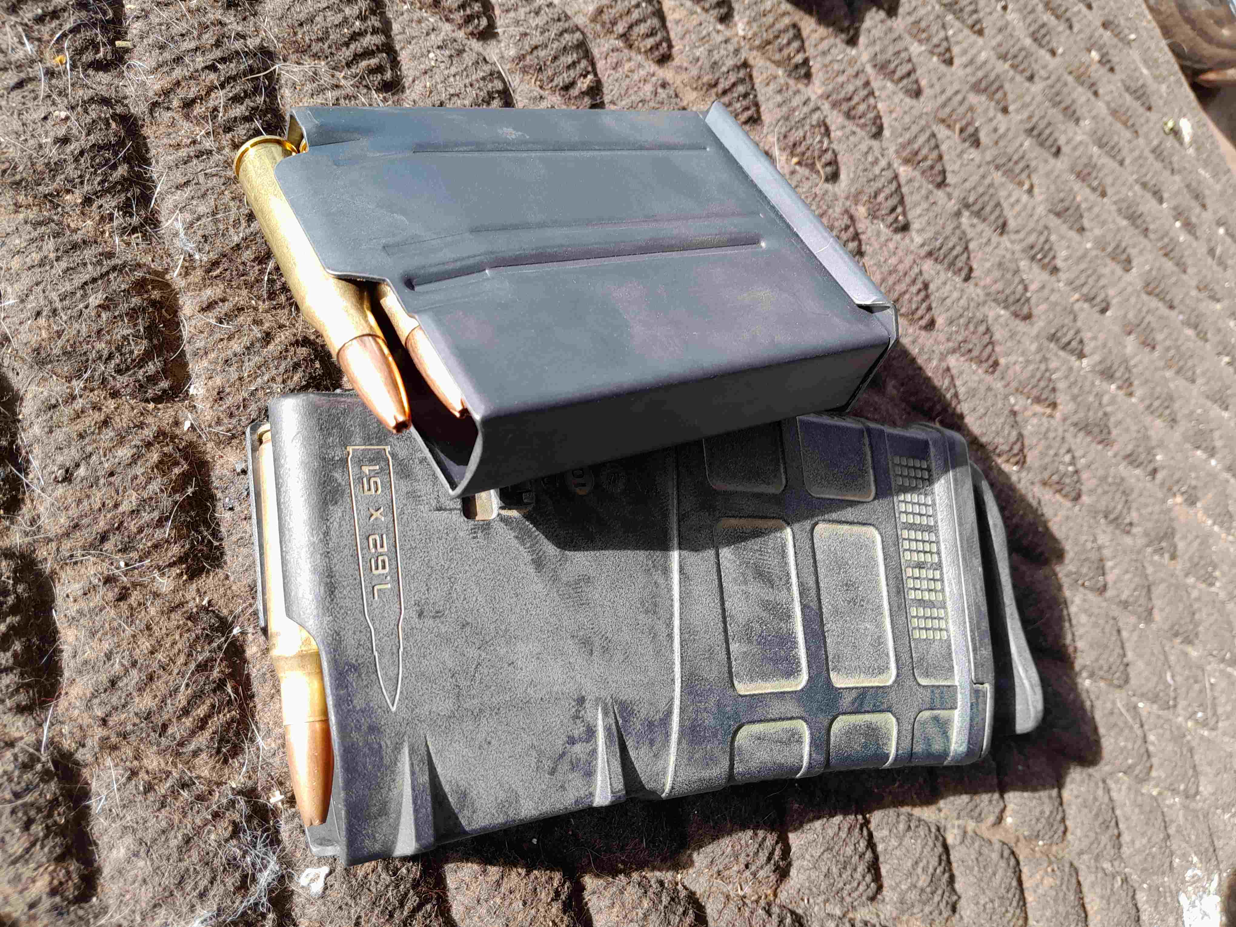

A few pics to colour the place up a bit.
As you can see, we are fans of these projectiles for what we need them for.
Posts: 3163
