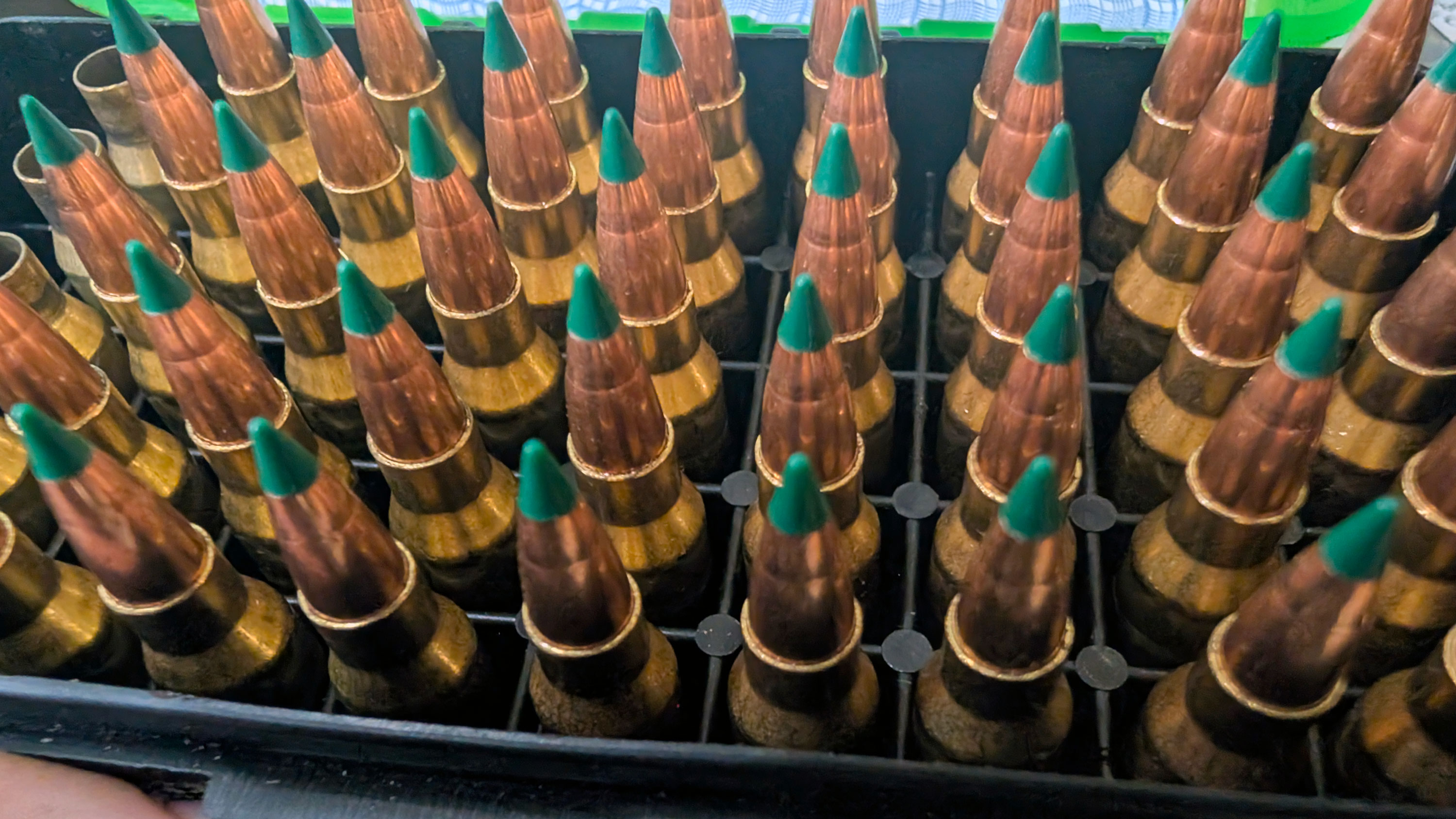

Post by madang55 » 01 Oct 2025, 10:53 am
223R 69g TMK. Book says COL 2.235". 25gr AR2206H. So far, so good, however, seating these javelins causes the seating stem to dent (circular around the tip) the projectile. I have 2 different RCBS die sets so I changed out the stems, but the dent still occurs, albeit a mm or 2 higher. I even have a graphite/lead shot mix and coated the inside of the necks. I reload 6.5 creed and those die sets come with different seating stems (Hornady) for different shapes of proj. but not my 223R sets. Seems the proj. themselves are very soft on the ends?
My wife knows me well.

Post by jezzab » 01 Oct 2025, 11:03 am
I use these exact projectiles in my 223 and the same happens on mine. Apparently its just the shape of the cup in the bullet seater and it should be a different one suited to the longer ogive but I couldnt find one for my Hornady anywhere. I thought about widening the cup out a bit but decided not to in the end because I wasnt sure if it would cause problems on other projectiles that are fine
By what i've read it doesnt effect anything (other than my OCD)

Post by madang55 » 01 Oct 2025, 11:09 am
I'm tempted to tempt fate and see if I can expand one of the stems. I have 2 and can always get another...maybe

Post by jezzab » 01 Oct 2025, 11:13 am
I was wondering if the Hornady custom die 22 Cal .224" 75/80/88/90 gr. Part: 397100 would work
EDIT: Stuff it, i orderd one. Worst case I can butcher it

Post by Wapiti » 01 Oct 2025, 11:57 am
You don't need to order anything, you can just polish out the internal chamfer in the seating stem to better match the typical projectile ogive, with a pointed diamond burr or a mild steel pin coated in valve grinding paste.
Try doing a test with/without these compression marks, they do absolutely nothing to your groups or results on game.
I get these indentations on all sizes of projectiles, for me they are particularly deep on Nosler Ballistic Tips which are quite soft, and very noticeable when
forcing a projectile to pack down powder when using compressed loads.

Post by madang55 » 01 Oct 2025, 1:37 pm
I will try that. Seems general consensus is the indentations don't effect much

Post by No1_49er » 03 Oct 2025, 9:24 am
Have you tried seating a projectile (of the type with which you experience indentations) WITHOUT powder. That will establish with certainty whether or not you are compressing the powder.
If you get indentations WITHOUT powder, then it's to do with the shape of the ogive not matching the seater die.
If not, then you're probably compressing the powder. Is that really a good idea, or even necessary?

Post by madang55 » 03 Oct 2025, 9:42 am
Working on that one. Do I want a compressed load in a 1:8 barrel when the data is for a 1:12? Not really.

Post by bigrich » 03 Oct 2025, 5:28 pm
deye243 wrote:You blokes must be running a hell of a lot of neck tension
it'd be my guess the loads are compressed and the projectiles are marked cause of the amount of pressure on them when seating to get the COL right . that's the only time i've gotten indents on my projectiles , not as bad as in the pics but . a nice accuracy load for my 12 twist 223 tikka is a 55 vmax with 25.3gn of 2206h in adi brass , and if memory serves me right it's slightly crunchy when seating . try to squeeze a looong 69 gn projectile on top of 25gn and i'd guess it's compressed .
but i could be wrong .... ;)
edit- re the COL the op listed. i just looked at my current sierra book and the COL given for sierra 69gn TMK ( part No-7169) is 2.260" . so the COL being used is definitely too short resulting in a compressed load . hope this helps , cheers

Post by madang55 » 03 Oct 2025, 9:46 pm
Thee be correct. 22gr of 8208 works fine. Just have to see it down range

Post by saljer » 05 Oct 2025, 3:47 am
Contact Sierra, tell them about the ring implant. What do they recommend.

Post by bigrich » 05 Oct 2025, 5:30 am
saljer wrote:Contact Sierra, tell them about the ring implant. What do they recommend.
he's been seating the 69gn tmk 25 thou shorter than what my sierra 11 load manual says . not sure on where exactly he got the COL length from .
however my ADI load data 9 book says 2.235" for a sierra 69gn HPBT in 223 , as the OP stated in his original post . referring to my sierra manual 11, this bullet should be at 2.260" as well as the 69gn TMK .
i deduce adi have listed the WRONG COL for 69gn sierra . not the OP;s fault . if i were the OP , i'd contact ADI , point out the error . and maybe ask for his projectiles to be replaced as a show of goodwill ... ;)

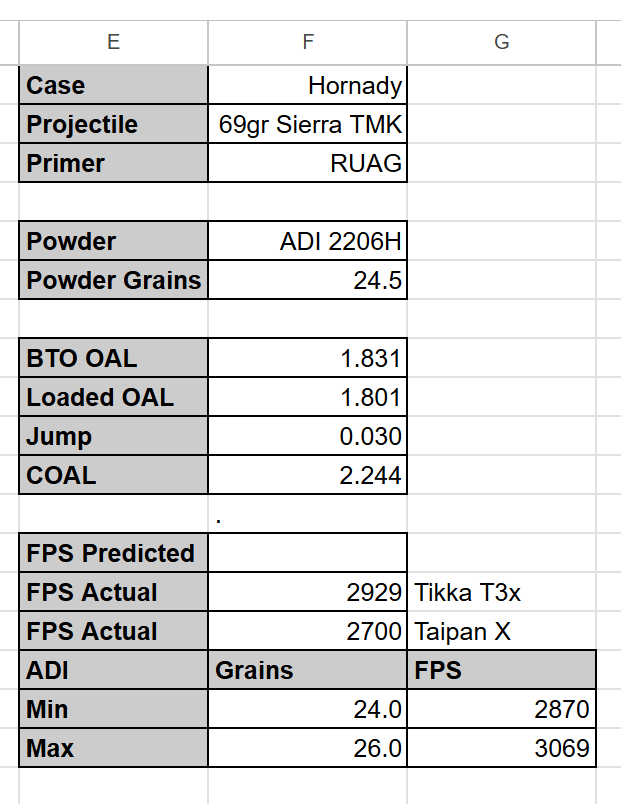

Post by madang55 » 05 Oct 2025, 3:44 pm
Have made the following discoveries based on a bit of "why is that". The ADI book says it uses a Winchester barrel with a 1:12 twist. My Howa has a 1:8 twist. Why? Answer; to accommodate the heavier projectiles. Hypothesis: If the barrel is good for longer projectiles, (Sierra says 1:8 good for 80gr) then, maybe, just maybe, the throat is a deeper.! I got the gauge out and tried to measure a super roo first and it wouldn't work. I discovered when I was extending the rod, the projectile just fell our the end without reaching the lands. Anticipation grows. Measuring the 69gr TMK, several times, it read an average of 2.315. I've dropped the powder back a tad, extended the seat to a COL of 2.300. Rand a few proj only cases through and there ya go. Loaded some even out to 2.308 and cycled them through with no change to the COL. I could probably seat them further out. Realisation is that if a manufacturer is going to make a rifle with a barrel with a twist to accommodate longer projectiles, it would be pointless designing it with a throat for lighter projectiles only. If ADI are basing their Data on a 1:12 barrel, then their COL is probably appropriate against a shorter throat. Was going to say I've re-christened the rifle due to the deep throat, but sensitivities must be observed.

Post by Wapiti » 05 Oct 2025, 7:23 pm
COAL is developed individually for the rifle you are using. The specs listed in a reloading manual can only be used as a number, or a point for reference, not ever something to meet, copy or strive for.
As has been discovererd, specs are often BS, made up or f**k knows what.
An experienced reloader will individually measure what throat length they have with the appropriate equipment, then experiment with the dimensions they have, and the suitability of the projectiles they want to use that supposedly work within the twist and velocity they expect to get.
You're all pulling your hair out trying to meet some dimensions or number that may never work in your rifle, as Madang has found out, when all you can do is work with what you have.
Measure the length of your COAL max, and see if you can approach that within 10-20" IF you can.
If your rifle has a long throat, either because the maker doesn't give a cr@p about some handloader trying to get benchrest groups from an economy-type hunting rifle, or to allow for every possible combo of reloading bastardry that is concocted up by drunken nutjobs at 2am after reading some advice from the internet, then you are stuck.
You gotta work with the dimensions you are presented with, so get those sorted and see what you can do with them.
If it means 100" of jump to keep the projies falling out being no good for you, you got the wrong rifle.
Gunsmiths making an accurate rifle for a customer or barreling one for same, will throat the rifle for the intended twist in the barrel and the users' expectations of projectile weight and length. Factory rifles, find out what you are gifted with first before pulling your hair out.

Post by madang55 » 06 Oct 2025, 9:58 am
So, bottom line is, measure yr throat length and seat accordingly. In my case, my howa allows me to seat the 69gr TMK further that the ADI manual states. It also means I can seat the 55gr Super Roo a bit further out leaving less jump than I obviously have now. But seating to a depth of at least the calibre, and all the while fitting the magazine. Lessons learned.

Post by madang55 » 08 Oct 2025, 11:48 am
I have determined that a bit more attention may be needed to the process. A. by measuring the throat on my barrel, I have found that I could seat to a COL of 2.450. But, the round wont fit in the magazine. So I have settled on 2.305. The ADI book obviously limits its data to the barrels used for that particular projectile (and calibre) so cant be accused for getting it wrong. It is the same for the Sierra book, and the Hornady book, etc, etc. It is us, the handloaders' responsibility to do it right. Doesn't matter how we measure, but we must do it right. I pulled all the ugly proj and re-seated to the new depth and they're all pretty now.
B. I have discovered neck tension. the uglies really didn't want to come out. It was an effort. More attention needed to the inside of the necks. I've used a 35mm film cannister with a mix of graphite and No.71/2 shot. Give em a dip and a wipe on the outside and things are much nicer. Make sure to give the cases a tap to dislodge any stuck shot. And, no, Redding Competition Dies with neck bushings are not on the Christmas list.

Post by madang55 » 30 Oct 2025, 8:40 pm
I have given up. 24gr/2206H and I blew some primers. I've never blown primers, ever.. The 55gr SRoo will do fine
madang55
Posts: 451
Re: Projectile indentations
Post by Wapiti » 31 Oct 2025, 8:20 am
That's a big tip to handloaders to work up from a sensible minimum.
24gn/2206H in all our 223's from Sakos to Howas to a Tikka T3 varmint and the missus' Rem 7515 is a mild load. Well at least not showing any pressure signs. In some instances with old cheap x-mil brass it's compressed too. I see some even use 25gns... but not me, although when chrony'd it's markedly quicker.
But 24gns shows the best results in both numbers and paper.

Post by jezzab » 31 Oct 2025, 8:31 am
No pressure signs in either rifle
