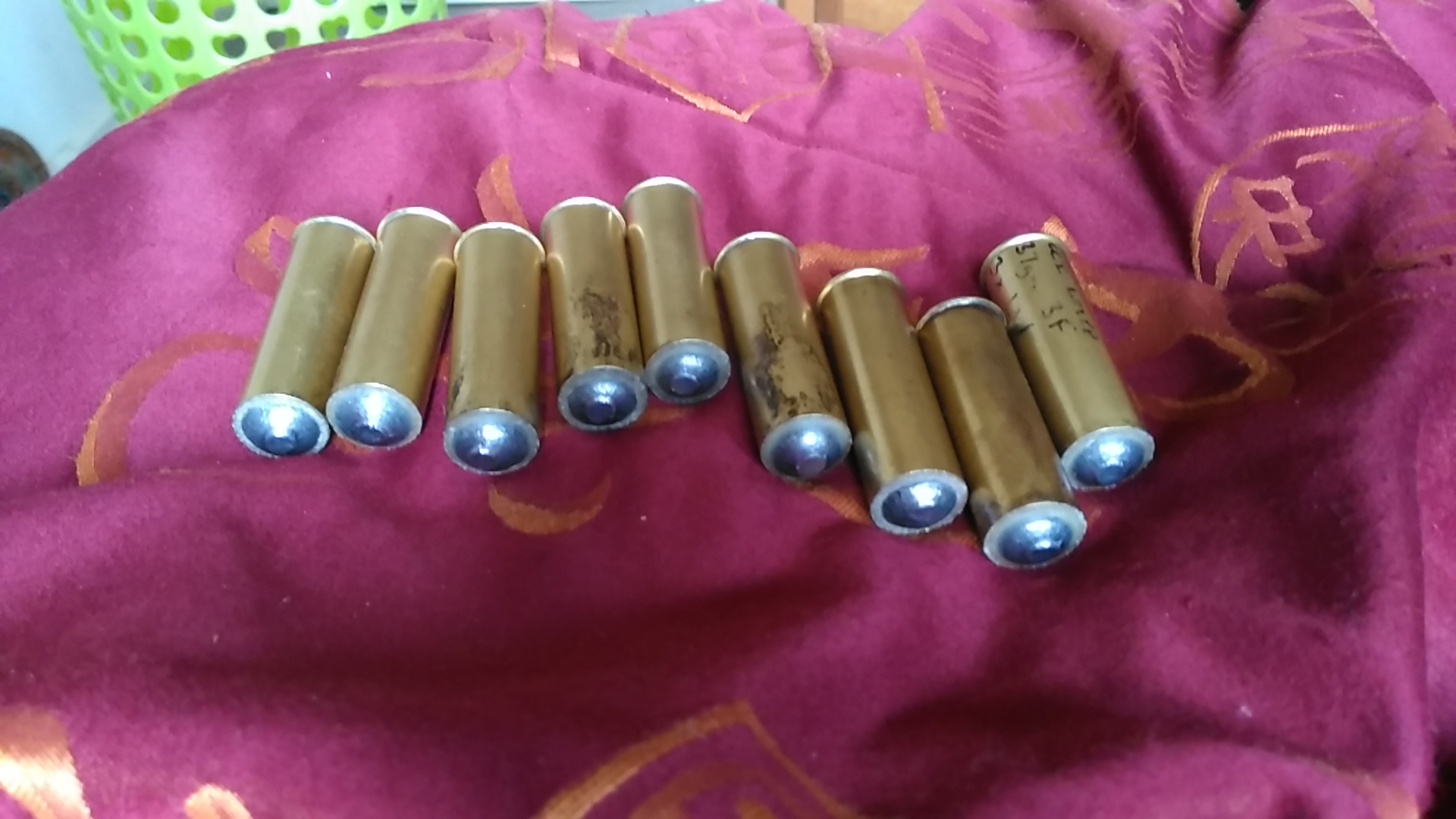

here's some loaded up here. They look the part hey :-)

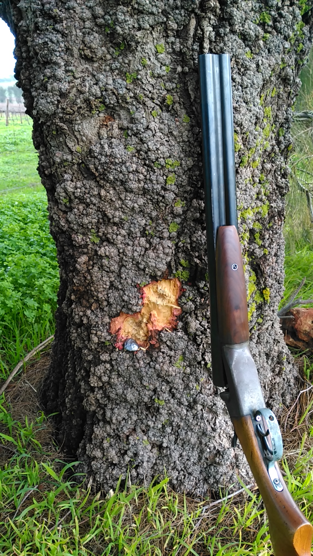

here's a couple of shots from about 15m right and left barrels. My sights need to be filed down. I pulled the ball out with my fingers but it still went into fairly hard wood about an inch and a half. Might need to tweak the charge a little but I'm erring on the safe side. Let's face it, a .725 RB weighing in at 575gn travelling over 1100fps is going to some serious damage on thin skinned game. Would love to chronograph the load

Yeah not greatly impressive so far I'll have to try shooting some groups from one barrel at a longer distance,once I file down the rear sight that is. Obviously neither barrel shoots close to the same poi so I'm flogging a dead horse in one sense.

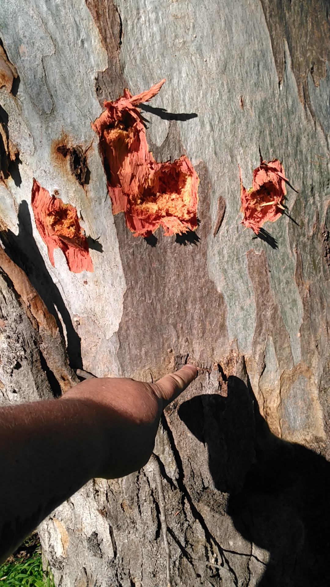

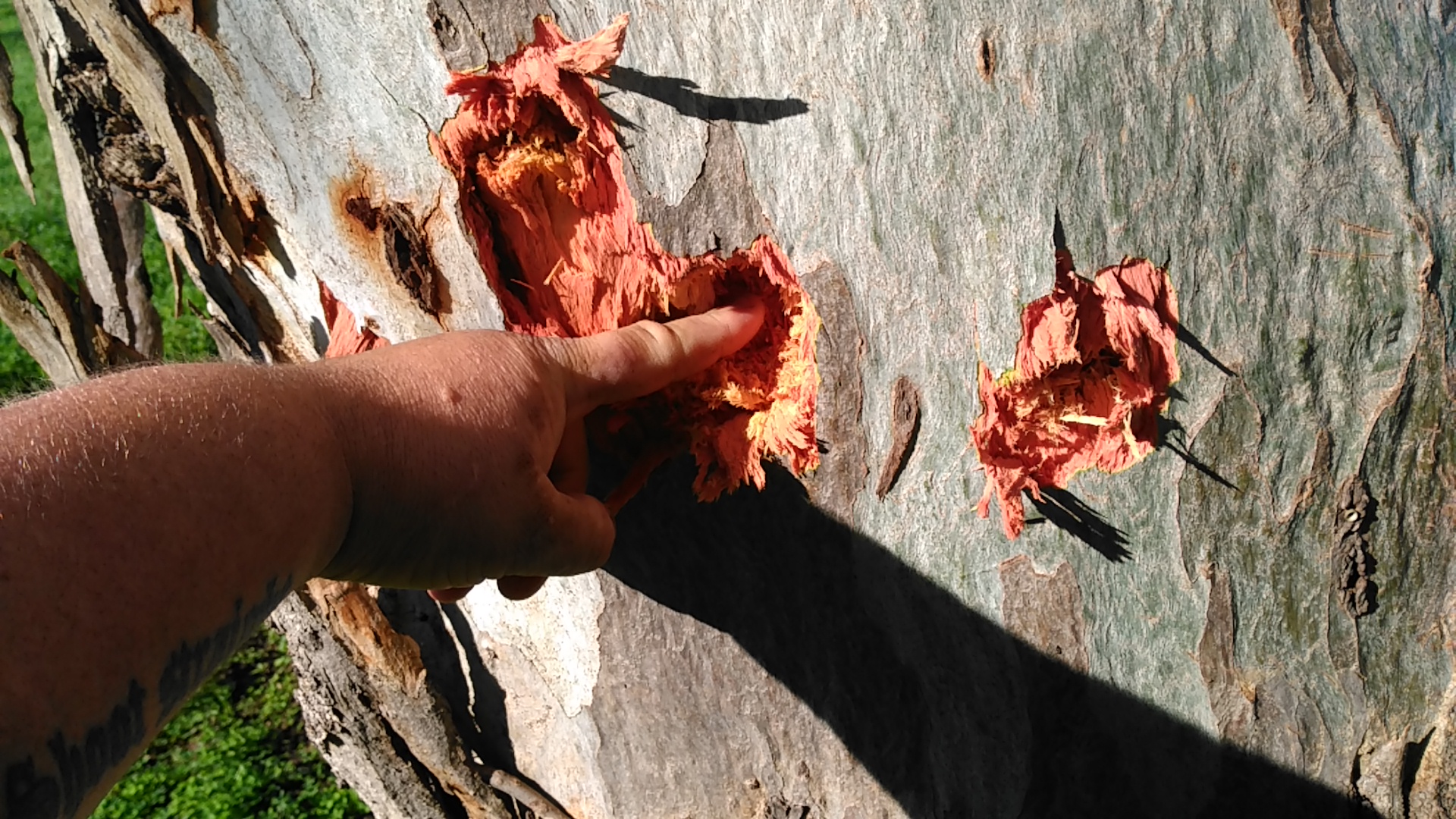

OK so I tried to shoot a group today with my last 6 round ball loads from 25m using both barrels. Here it is
I'm pointing at the point of aim as you can see they're shooting way high and I need to file the rear sight down more
three out of 6 balls hit here but they were out of both barrels so its not like one barrel shoots good groups,more like they both shoot crap :-)

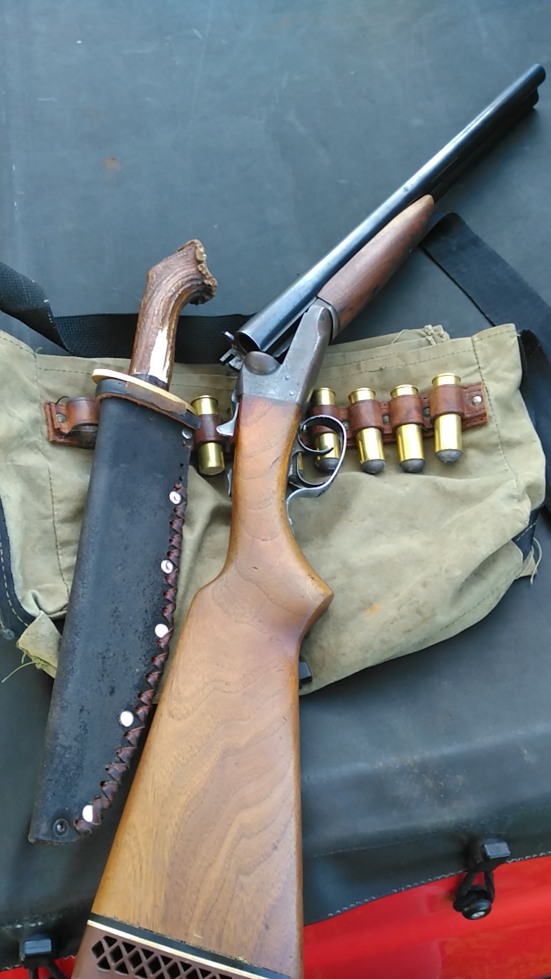

here's my hunting knife and pouch with my double gun lol
