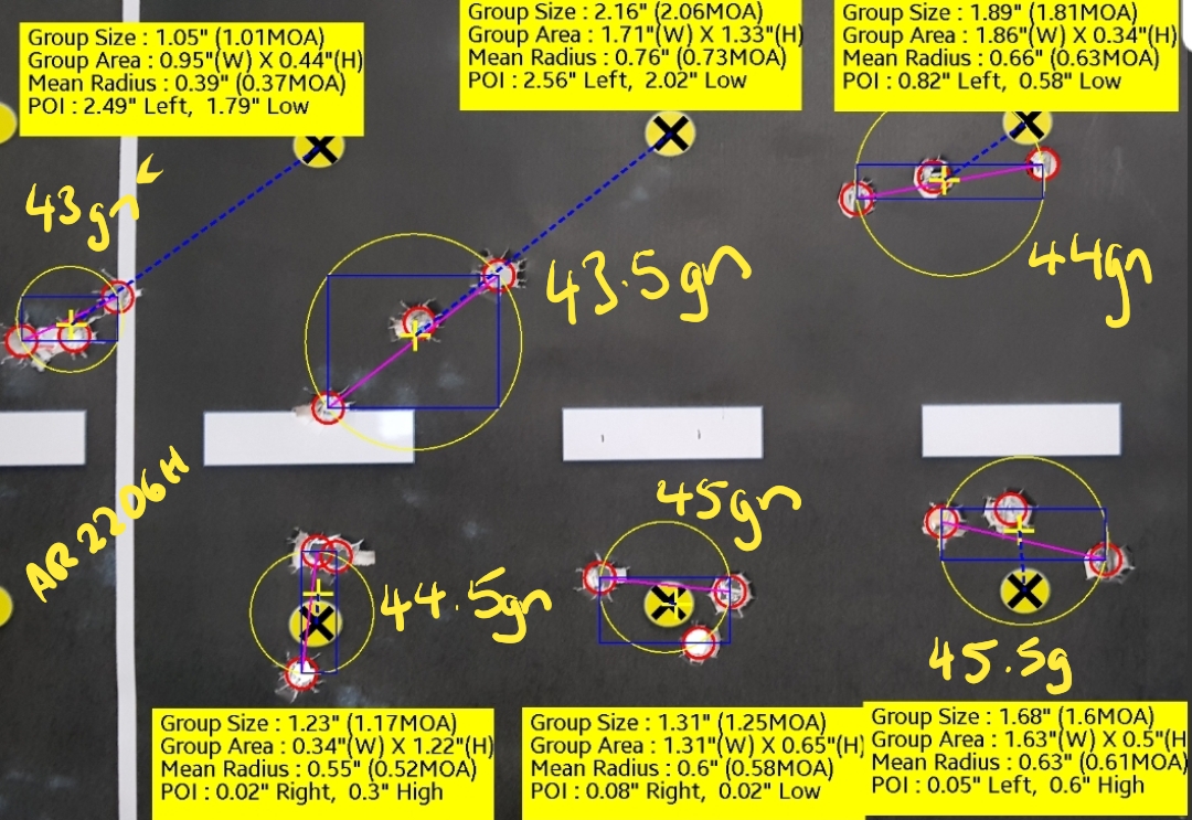

So any way I worked out my lengths and then proceeded to weigh my powder.
I'm using AR2206H, min load is 43gn and max is 45.5gn, I've load 3 of each weight at .5gn intervals.
One thing though, the below pic is 45.5gn and it was slightly compressed when I seated the projectile.
Is that normal?
- Resized_20180522_211736_2835.jpeg (148 KiB) Viewed 6995 times
I'm hoping to get out in the next day or 2 to test them.

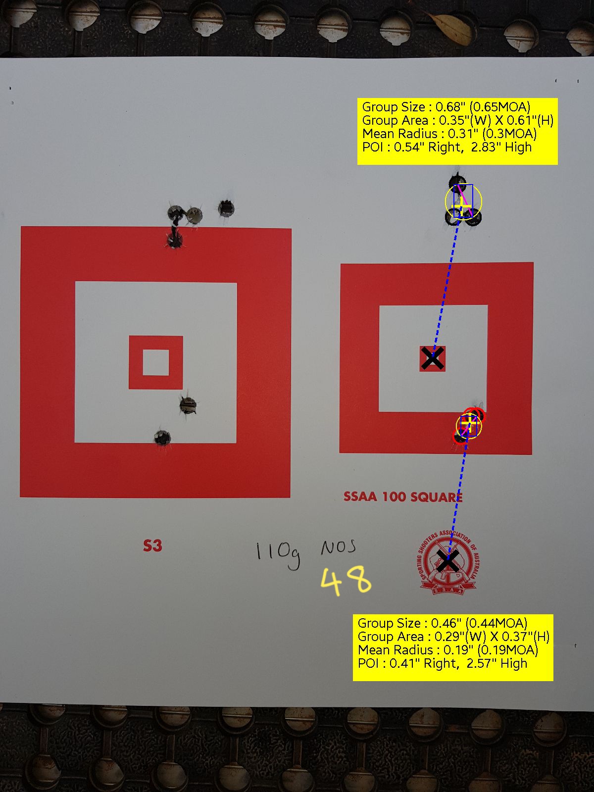

This was the 2 best groups I had with the Remington 150gn factory ammo.
- SmartSelect_20180522-200009_Range Buddy.jpg (353.8 KiB) Viewed 6974 times
