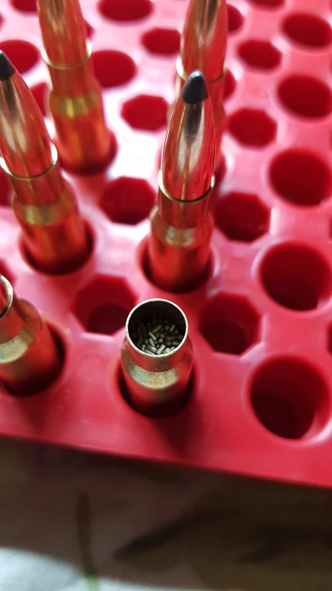

I loaded my first batch of .308 rounds tonight to try and find a load that my new rifle likes.
First off I used the Hornady COAL and bullet comparator kits to measure my chamber and I discovered that unless I'm going to be using some 200gn+ projectiles i won't be getting anywhere near the lands.
The COAL to the ogive on the 150gn Sierra gamekings in the chamber was 2.365, and that was with the projectile just seated past the boat tail of the pill and I have a limit of 2.244 due to the magazine (that's just shy of 2.800 base to tip.)
So any way I worked out my lengths and then proceeded to weigh my powder.
I'm using AR2206H, min load is 43gn and max is 45.5gn, I've load 3 of each weight at .5gn intervals.
One thing though, the below pic is 45.5gn and it was slightly compressed when I seated the projectile.
Is that normal?

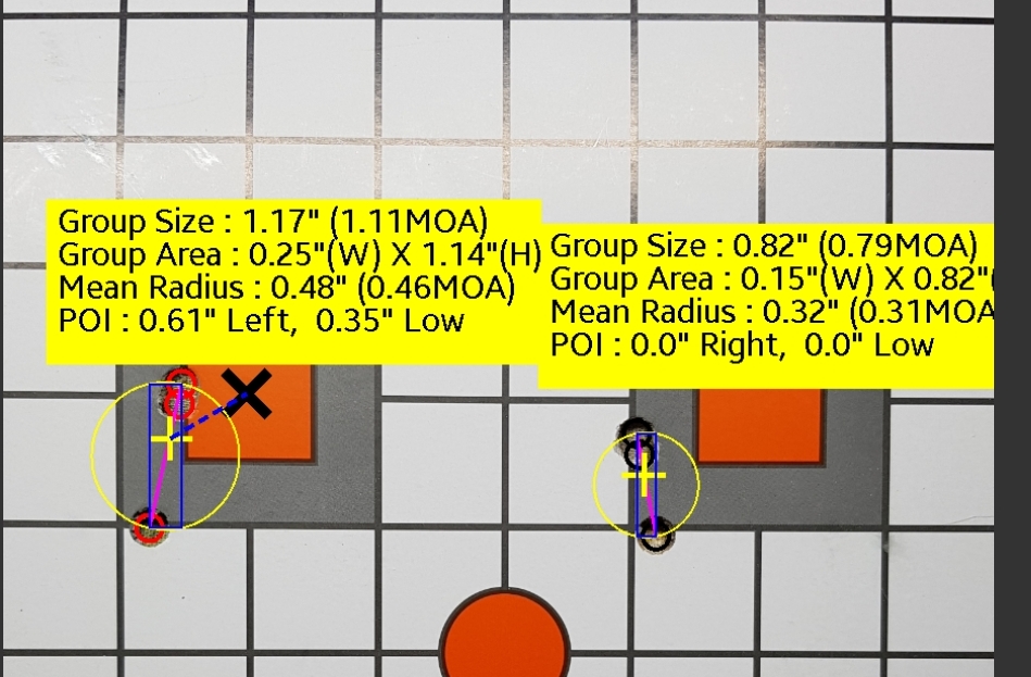

This was the 2 best groups I had with the Remington 150gn factory ammo.

Hi diddums.
I dont have a .308 so cant help specifically.
But a quick look & the charges you mention are listed in my book for a Nos 150 bt, not a 150 Sierra GK...that could make a difference--a diff ogive shape/length could cause the bullet to seat deeper.
Not that id imagine it should make a huge difference, but make sure you start shooting your loads at the low end & pay attention to pressure indicators like the recoil, bolt lift, primers etc., so if you encounter issues you'll see it before you hit the compressed loads.
Maybe other experts & 308 loaders can advise you in more detail.

Re: Load Development - Remington 700 ACC-SD .308
Post by Diddums » 22 May 2018, 11:05 pm
Stix wrote:Hi diddums.
Im keen to hear/see how you went with the 22-250...!
Yeah there wasn't a load for the game kings but the nosler BT's are also boat tail projectiles so should be similar, I'll be looking for any signs of pressure.
I have 30 22-250 loaded as well so will try and test them at the same time.
Post by sungazer » 23 May 2018, 9:54 am
Hi Didums yes 45.5 with 2206H would be a compressed load anything depending on brass over about 45.1.
Also yes Remington's have a very long lead on them for safety reasons it lowers the pressure as a load on the lands will cause a higher initial pressure and they just cant take the chance of idiots.
I think you will find a good load at about 44.3 grns with a 150 Gameking loaded to just less than Magazine length.
Another good bullet to try but you better be quick before they sell out would be the Berger 168 VLD Hunting it will like the jump and perform well. purchase from the Q Store www.q-store.com.au I am going to get some right now as well normally out of stock not cheap $80 but worth the few extra cents.
