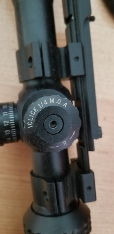

But scope adjustment should be in angular measurement regardless - minutes or mils usually.
I use minutes for calculating and measuring drop and windage as my reticles and turrets are calibrated in minutes, not inches.
I only have one right to hand just now.
I don't know how many scopes I have, but more than twenty, plus non-magnified optics and adjustable mounts. The only item I have that is calibrated in inches is the adjustable ZB-Lite Pro mount, which to be fair is not marketed as an adjustable scope mount at all.
What brand of scopes offer 1/4" clicks?
Please post pics of these scopes that are calibrated in quarter-inch clicks as I'd hate to end up with something like that.

in2anity wrote:WRONG. They print, '1 click = 1/4" / 100 yd' or similar on scopes as a convenient rounded off value, because practically you will never detect that lost 0.01175". Pretty much all scopes will still technically "click" relative to a fraction of angular degrees or radians.
Perhaps on some really cheap scopes they might have that, anything remotely usable will be in minutes or mils.
On something flat-shooting and only used to maybe 300m the difference is generally irrelevant. But for anything with a trajectory or used at longer distances the extra twentieth of an inch does add up.

""What brand of scopes offer 1/4" clicks?
Please post pics of these scopes that are calibrated in quarter-inch clicks as I'd hate to end up with something like that.""
I only have 5 scopes, the two I use, a Hawke and an Athlon both have moa marked on the turrets as does a Simmons 22mag, but a Nikko and a Bushnell Banner which I suspect is a clone both are marked 1/4".
Bushnell Banner.jpg (190.75 KiB) Viewed 7029 times
Nikko Stirling Mountmaster.jpg (161.31 KiB) Viewed 7029 times

Thanks Laz, interesting to see. I don't suppose you ever checked them to see if they are graduated in inches or minutes?
Lazarus wrote:""What brand of scopes offer 1/4" clicks?
