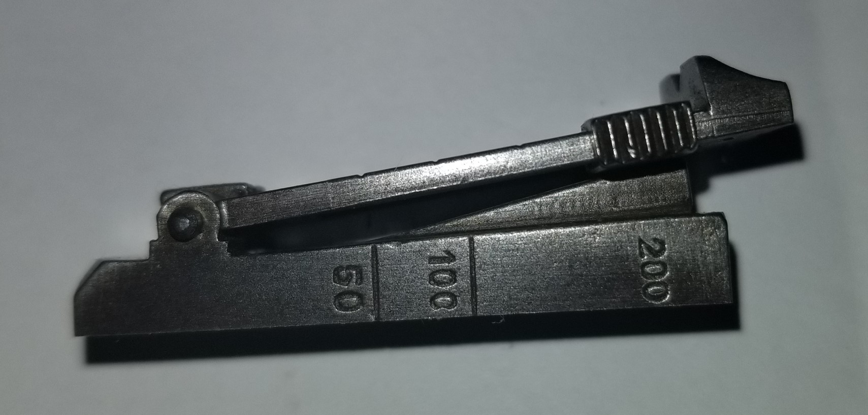

Post by bladeracer » 05 Dec 2019, 5:14 pm

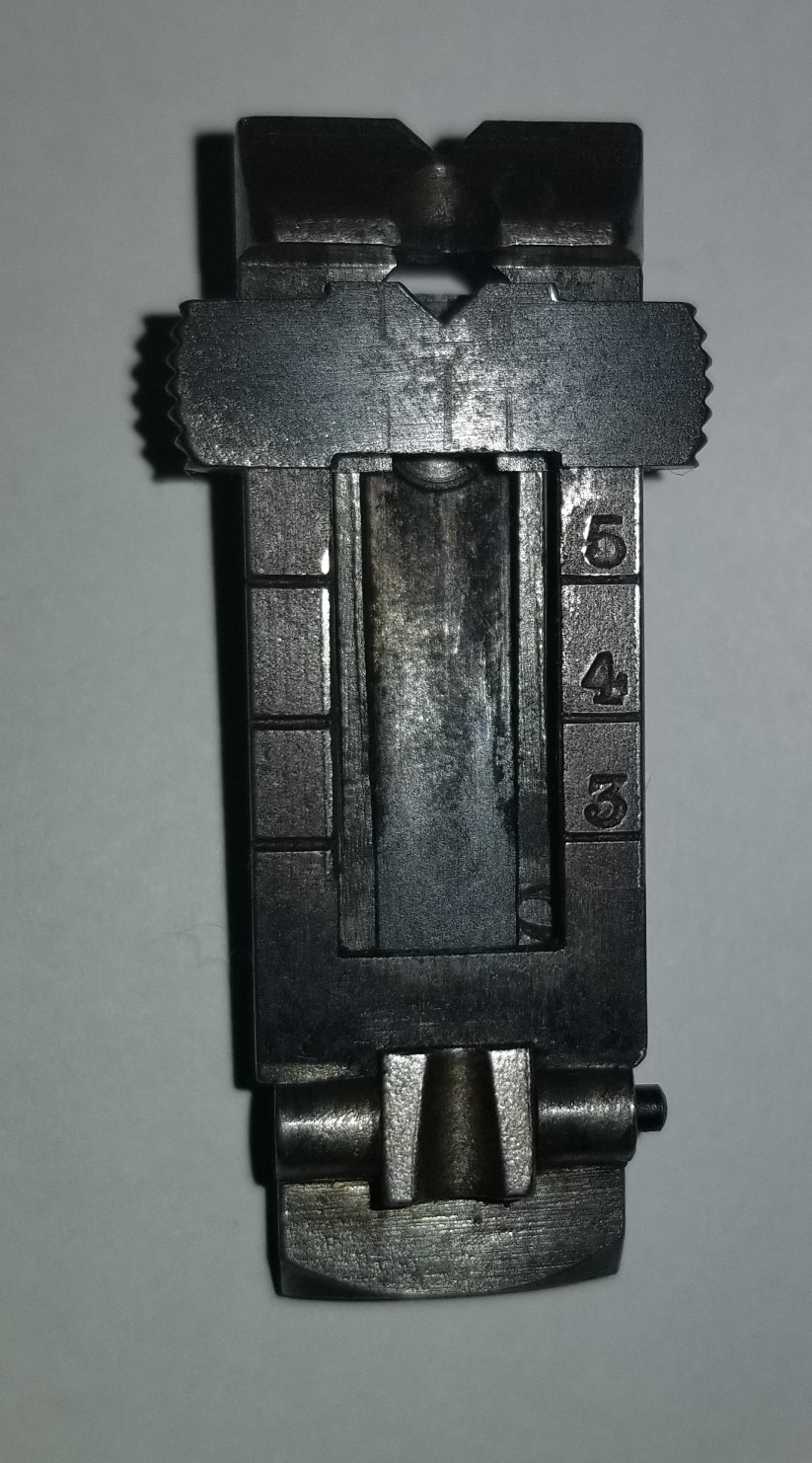

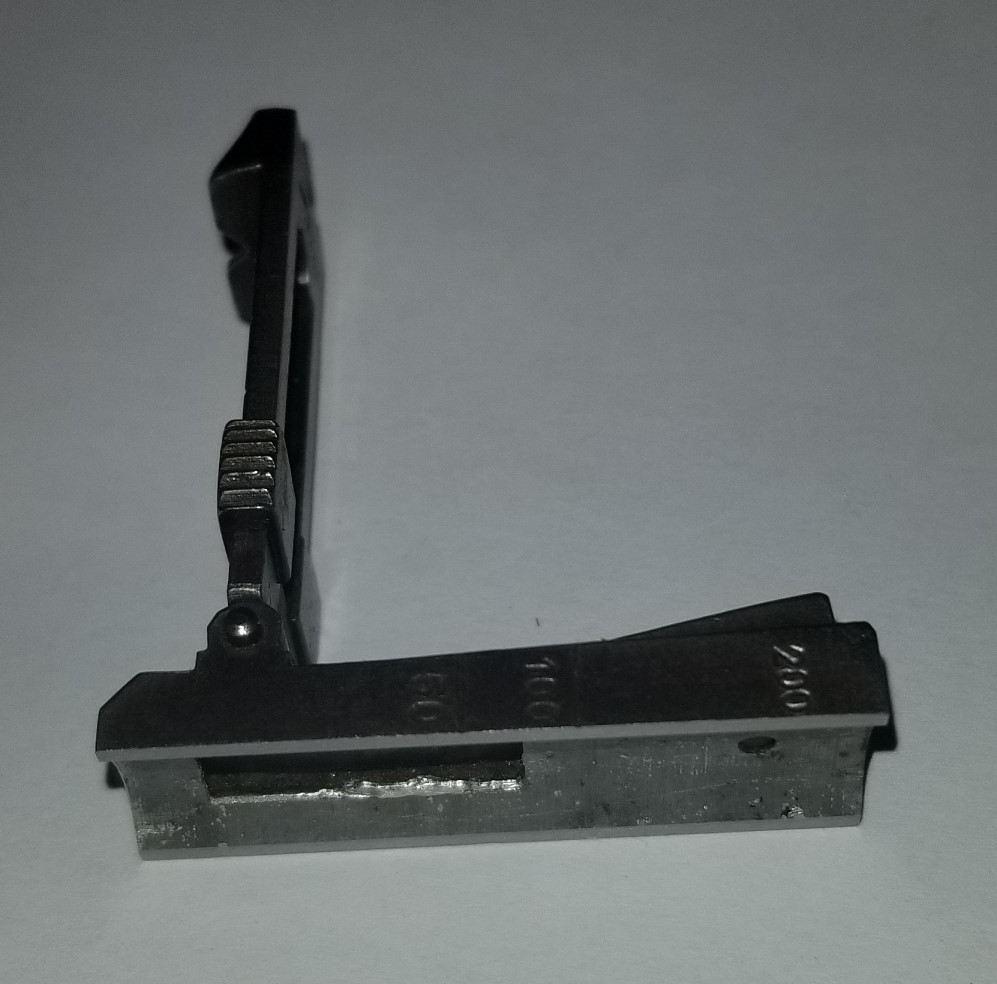

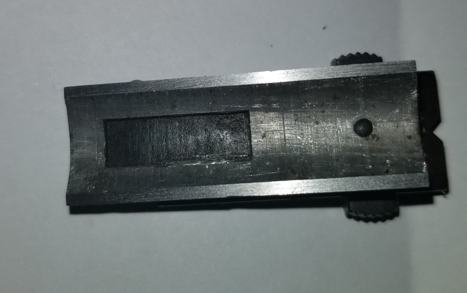

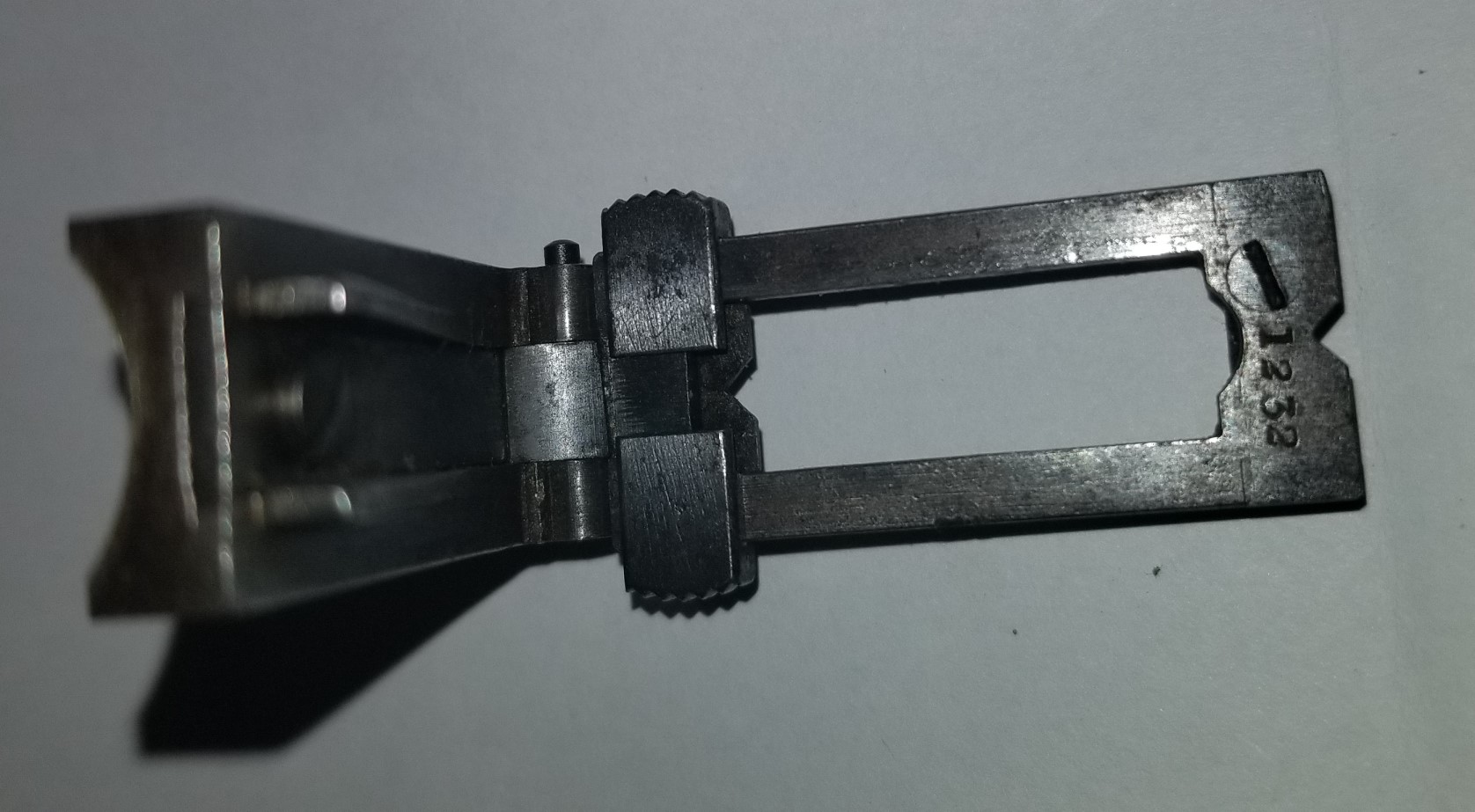

A neighbour has found a rear sight (he shot smallbore competition for several decades) that he doesn't recognise as something he used himself.
To me, it appears military, but scaled down - my guess is a .22 rimfire training rifle perhaps.
It doesn't appear to have any means of attachment so I'm guessing it's designed to be soldered in place.
Barrel diameter is about .650", which again points to a .22" bore.
I was thinking maybe an aftermarket "military-style" sight, except that it is serial numbered with "1232".
Graduations are not notched or "clicks", just friction, so recoil is negligible.
Measuring the graduations gives me the following:
At the "50" setting the bottom of the notch is .298" above the barrel diameter
The "100" setting is plus .089".
The "200" is plus .171".
The "300" is plus .288".
The "400" is plus .470".
The 500" is plus .709".
The top setting (no distance marking but looks to be in line with "600" based on the scale) is plus 1.007".
It also has a windage mark .090" either side of the centre of the notch.
A sight radius of 500mm would make the sight settings roughly 15.5MoA, 30MoA, 50.5MoA, 82MoA, 124MoA, and 190MoA, and the windage marks 15.5 minutes.
This is pretty close to .22LR trajectory out to 600yds, if the 500mm sight radius is a good guess.
Does it look vaguely familiar to anybody?

Post by bladeracer » 05 Dec 2019, 10:06 pm
No1_49er wrote:.310 Martini Cadet. ?
I did consider it, but the thin barrel put me off. I'll have to check the trajectory of the .310 tomorrow and see if it fits.
Re: Trying to identify a rear sight
Post by bladeracer » 05 Dec 2019, 10:20 pm
Just checked Numrich and I think it is indeed a Cadet sight, although not identical to what they show.
https://www.gunpartscorp.com/products/1103730
Post by bladeracer » 05 Dec 2019, 10:32 pm
Thanks for the tip, I've found one.
https://www.joesalter.com/category/prod ... item-37060
Graduations are different though so I think it's for a .22LR version of the Cadet.

It's the same sight but with different graduations.

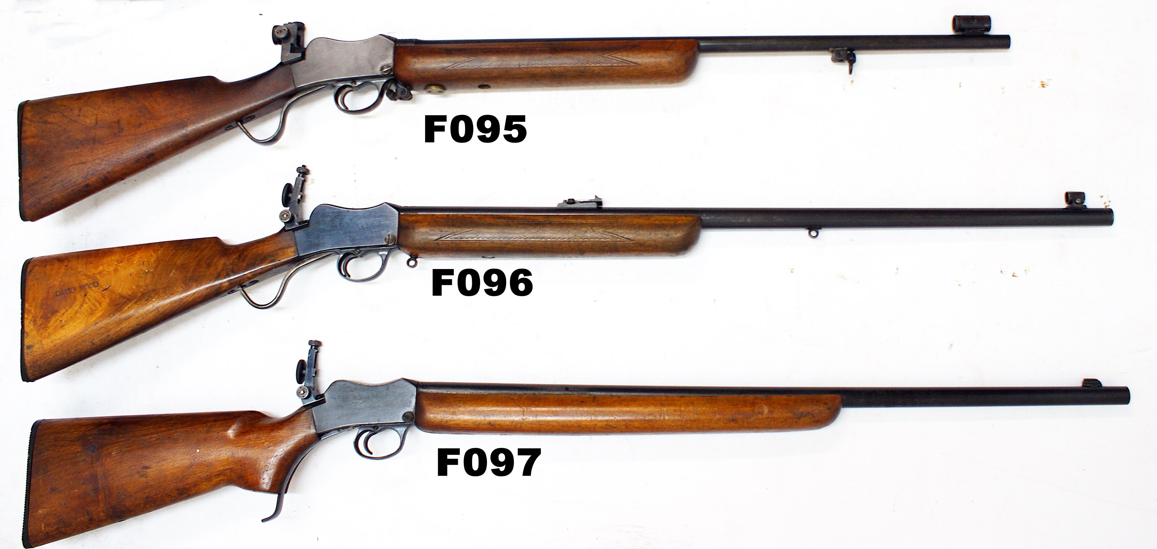

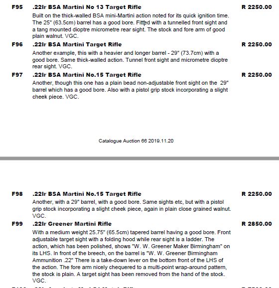

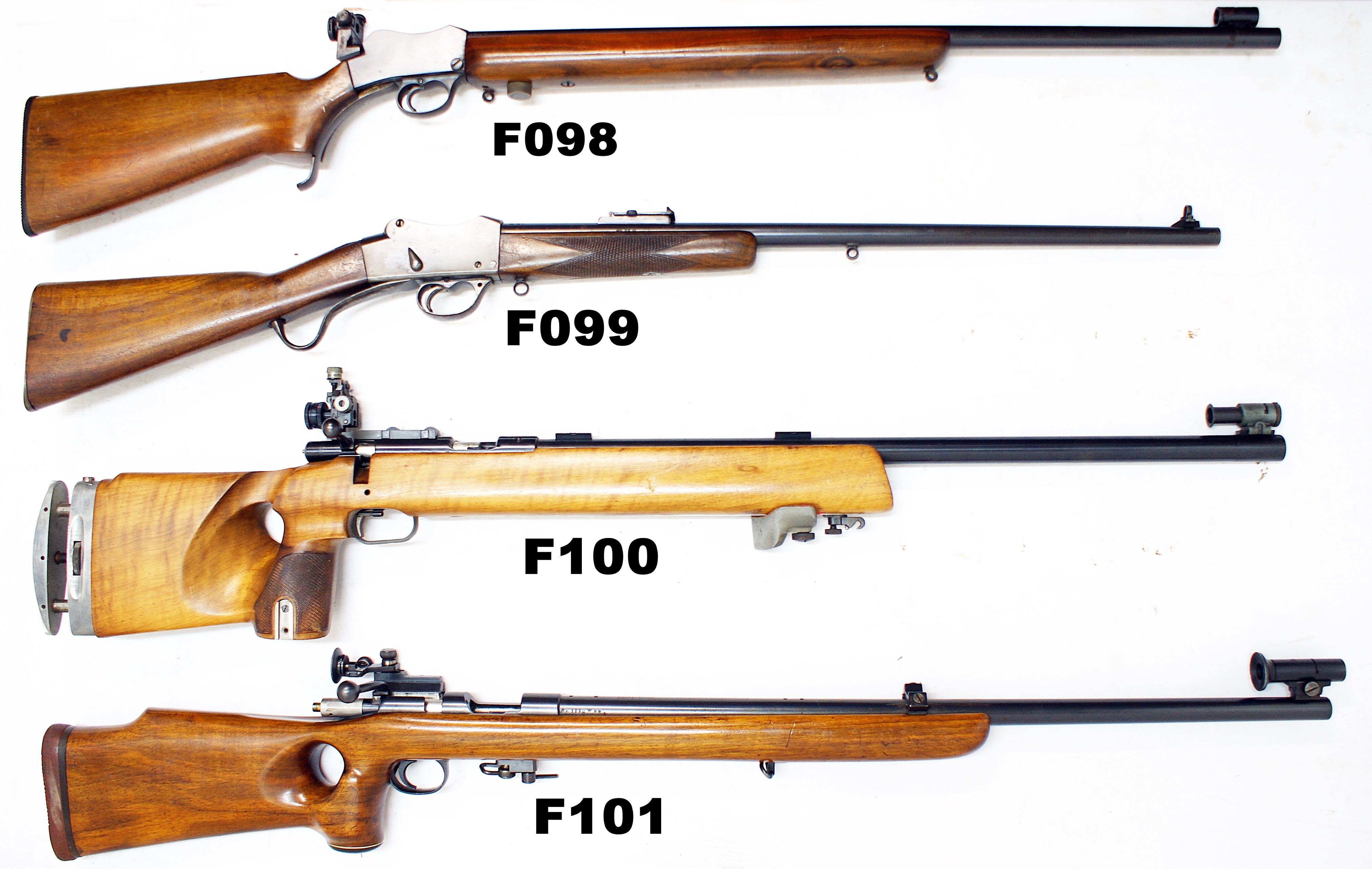

I found there are four .22LR Cadets on auction in South Africa, a No.13, two No.15's and an unstated one.
One of them has this sight still.
Also a Greener .22LR that appears to have the same sight.

And the digits 34 and 5 may indicate 300 yards 400 yards 500 yards which would not be on a little cadet
4godsako
Posts: 5
Post by bladeracer » 11 Apr 2021, 5:09 pm
4godsako wrote:And the digits 34 and 5 may indicate 300 yards 400 yards 500 yards which would not be on a little cadet
What are the graduations on the .22LR Cadet then?
