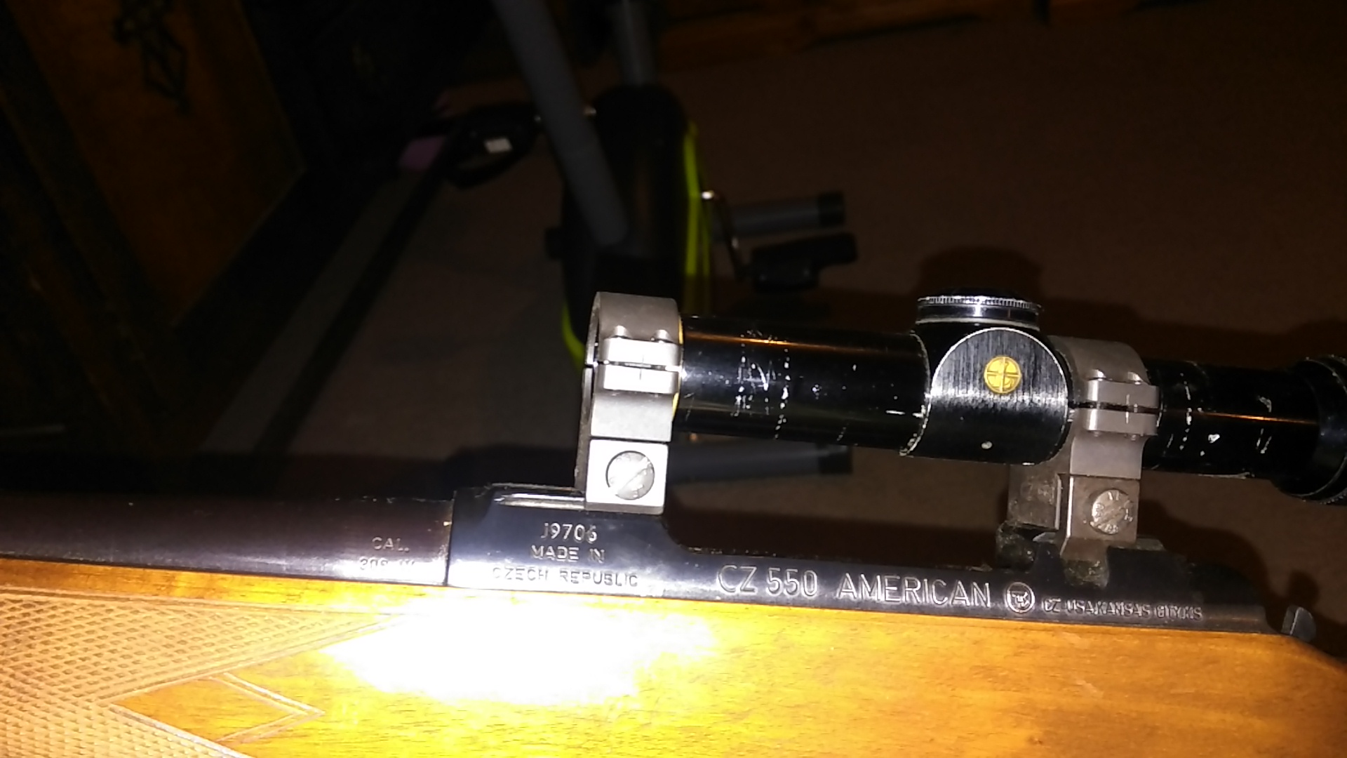

Post by bigpete » 03 Nov 2016, 7:35 pm
Here it is in its better position
Posts: 4196
Re: How Far ?
Post by Oldbloke » 03 Nov 2016, 8:05 pm
Something is wrong to be in that position.
