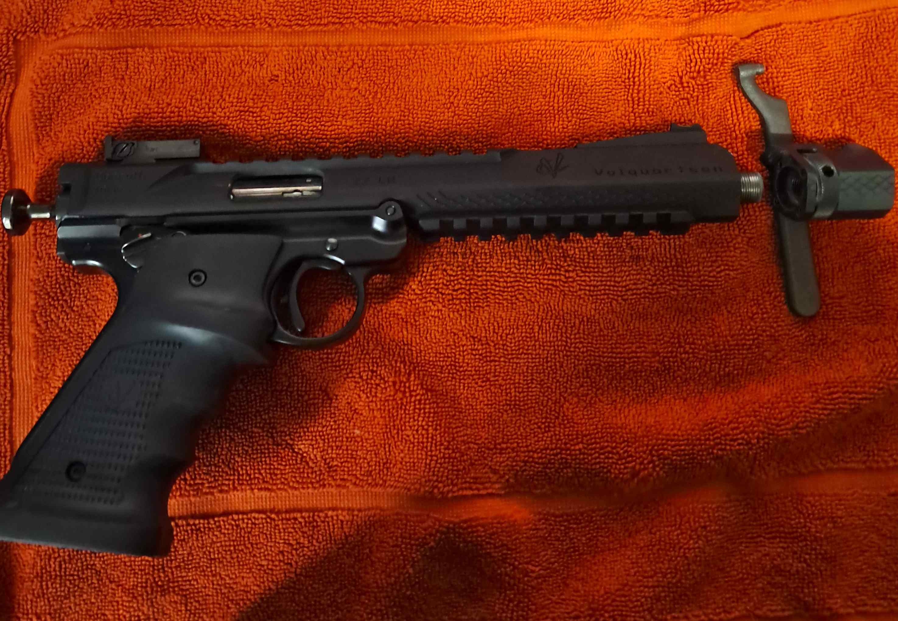

Post by fnq22 » 01 Apr 2025, 9:54 am
So the new Black mamba is going well..apart from having to add a little piece of foam rubber in the pivot point that holds the upper onto the frame(which seems a common ailment of this Ruger mk 4 design feature to keep it all snug).
The only issue is after some amount of rounds the compensator works its way loose on the threaded barrel..

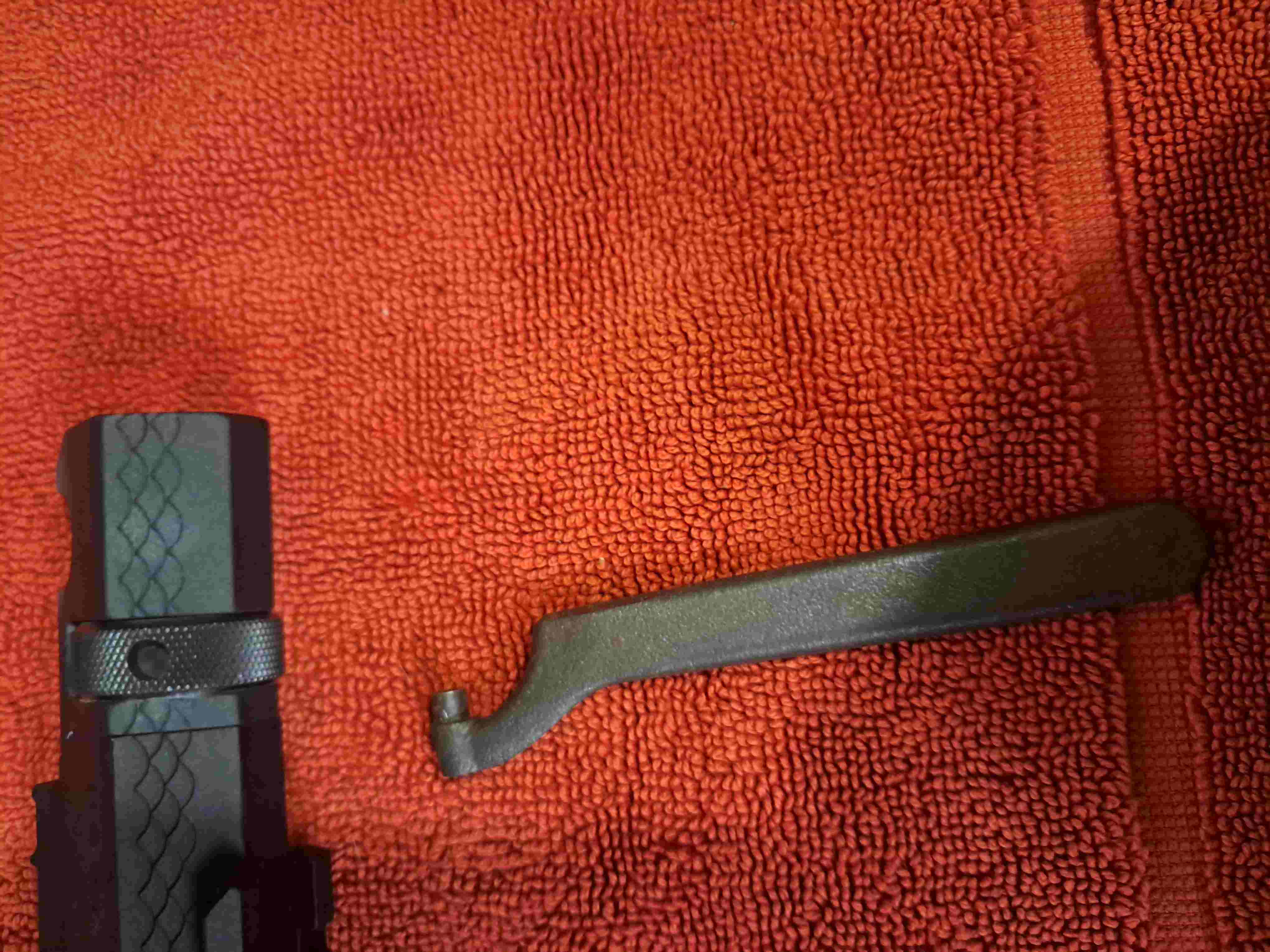

I have a small tool to tighten it but dont want to over torque it... it just seems to always come loose to a small degree after 50-100 rounds..
Any ideas beside threadlock..I was going to try some threadtape if nothing else is suggested...?

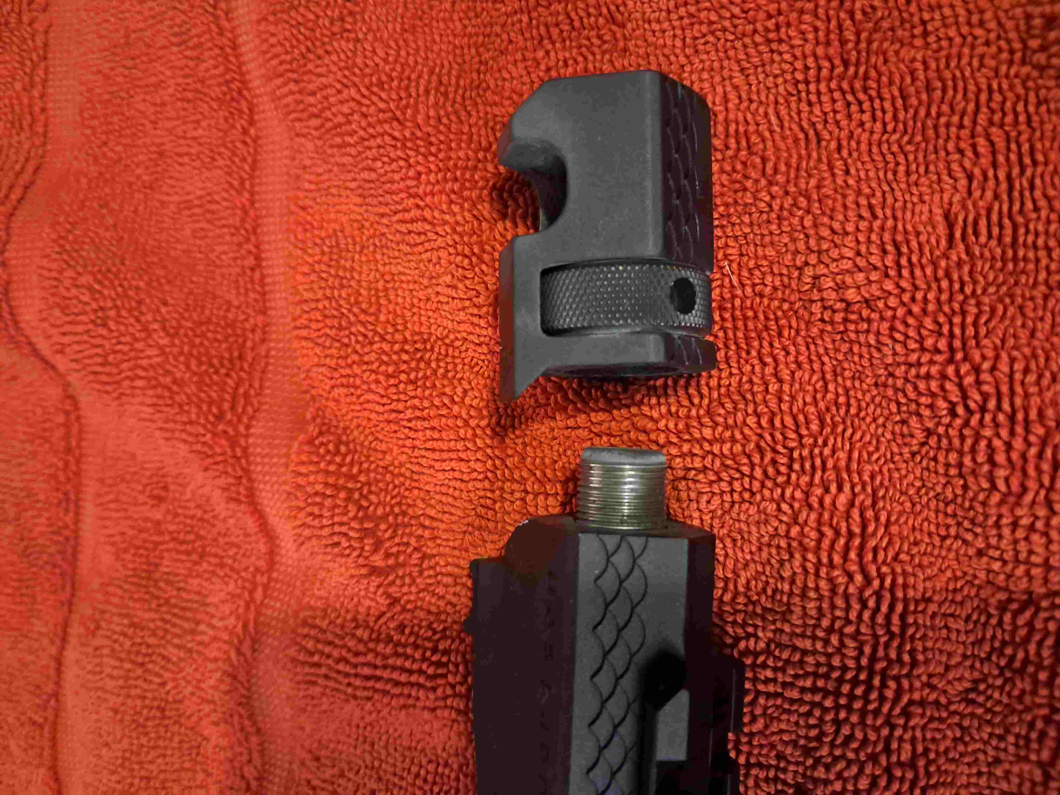

Post by fnq22 » 01 Apr 2025, 3:51 pm
This is what I'm working with..

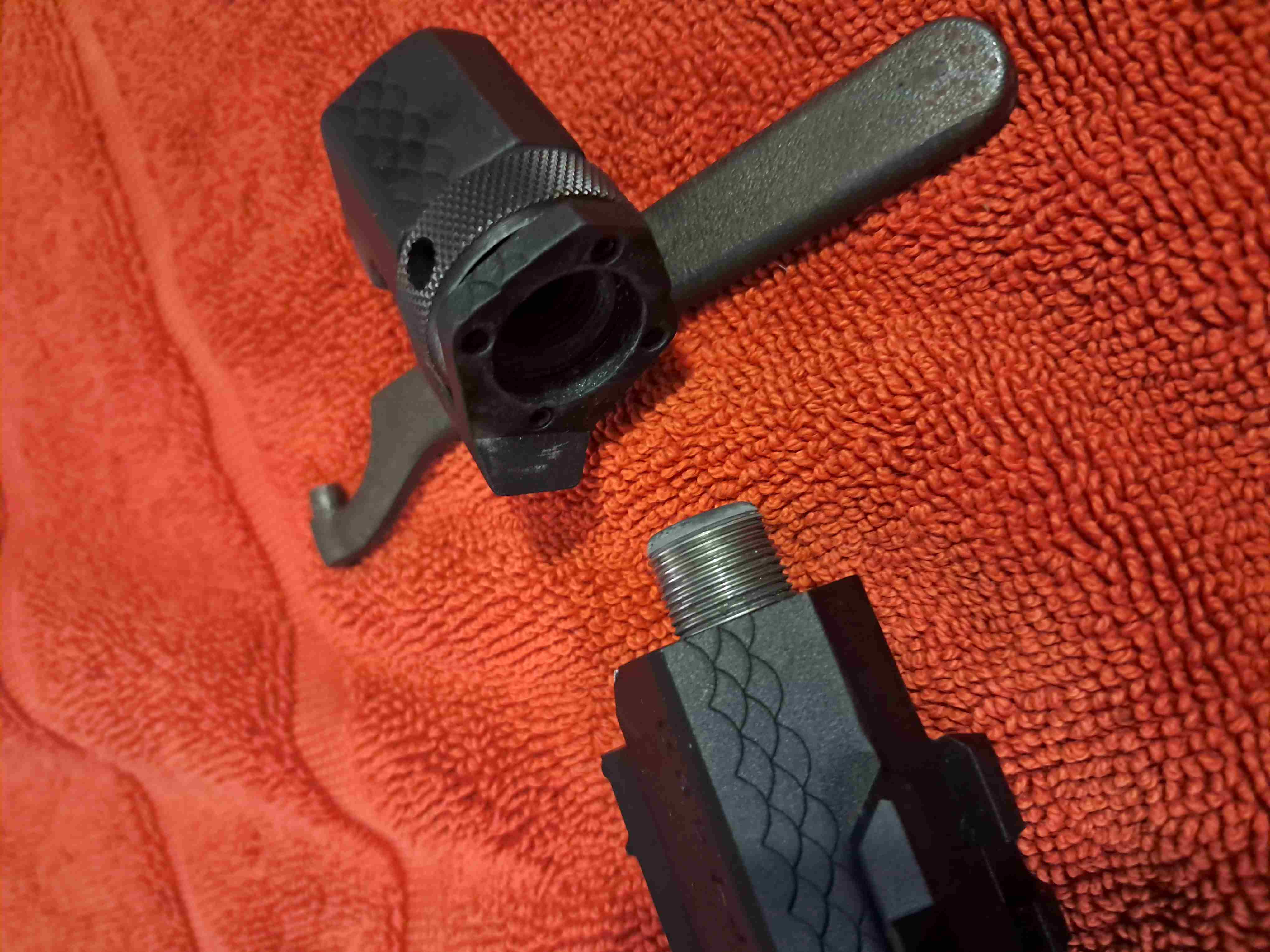

Now that I've seen photos of the compensator, I'd be going back to the drawing board and turning that threaded colar into a locking collar .... with a cut and screw :thumbsup:

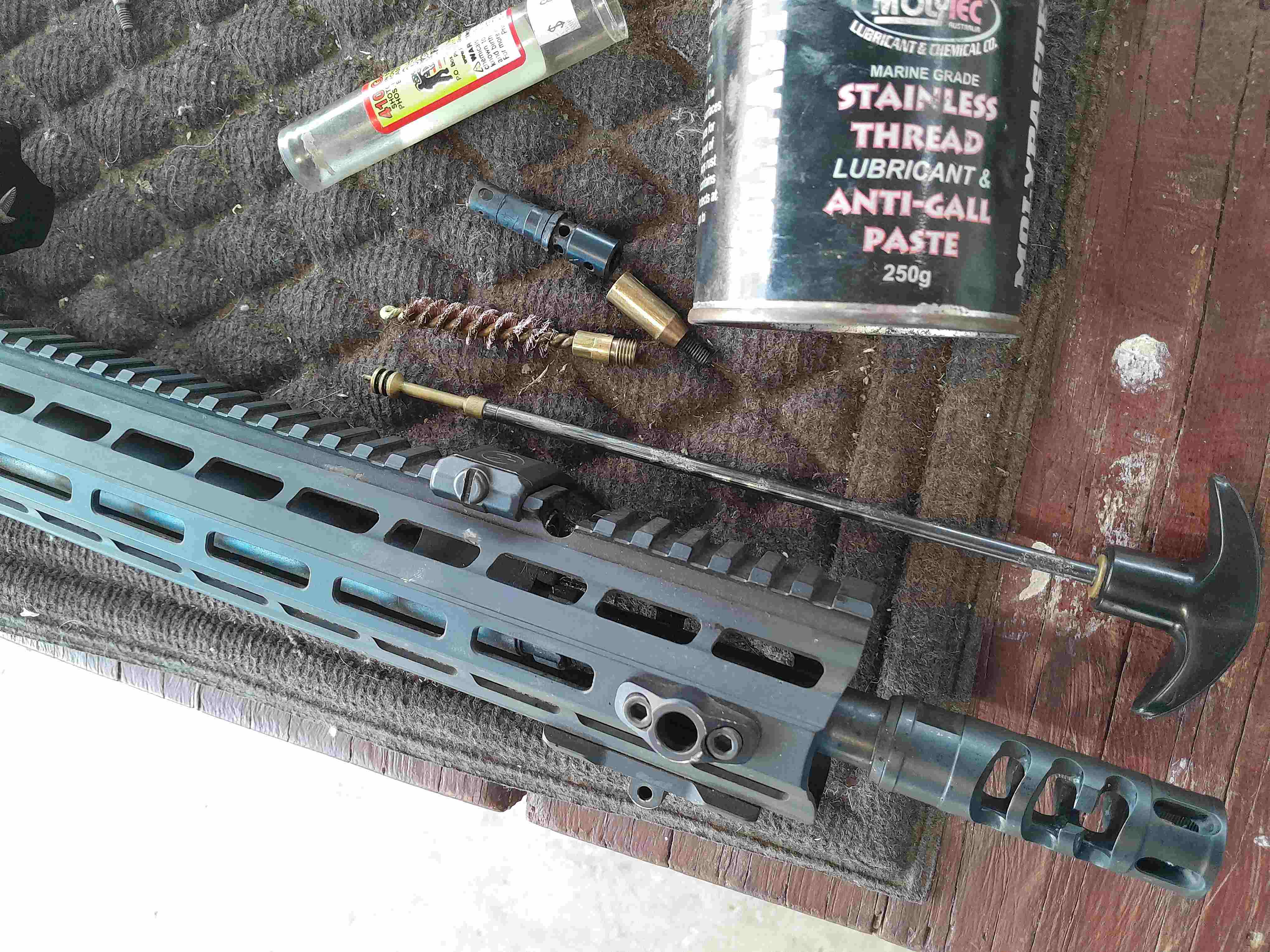

Post by Wapiti » 10 Apr 2025, 6:18 pm
If any of you have a firearm that has an adjustable gas block, or another rotating part exposed to high pressure gas, a good Moly paste made for this is a great choice. Neverseize is just a brand name.
Gas piston systems like this are self-cleaning, but the adjustable section can jam up after a few 100 rounds and won't rotate. You mightn't need to experiment with different settings, but id you ever want to disassemble the plug to brush out the piston bore, you will wish you'd done something to stop carbon jamming it up.
A coating of this product ensures it comes out easily even after a few months shooting.

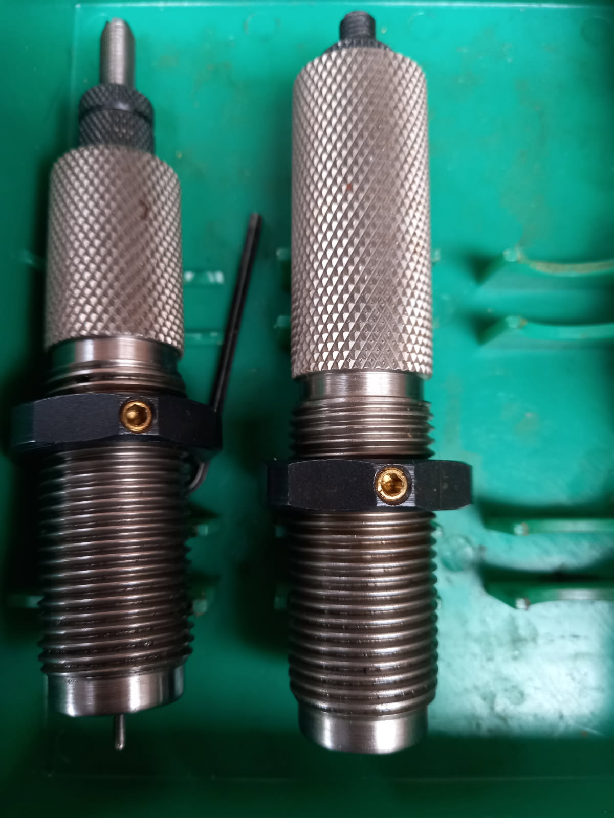

Set screws in firearm design to stop other threaded parts falling off - FMD.
