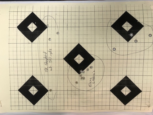

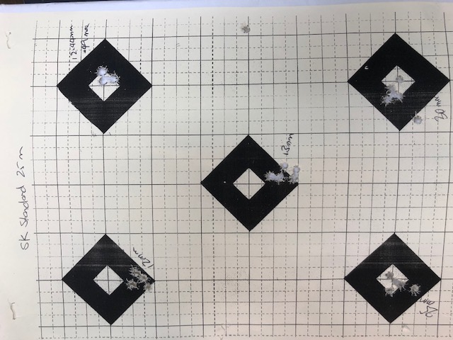

Hi, I'm hoping to tap into the experience on this forum because I'm at a loss to explain this. On Sunday, I took my new acquisition (an old CBC bolt action) and zeroed it at 25m with 5 shot groups and was happy with the results. Then I moved to 50m with the same box of SK standard ammo and couldn't hit the side of a barn. I couldn't figure it so I threw some Eley subsonics through it which weren't great but at least resembled a group.
For reference, the top left group in the first photo was my second lot of 5 shots at 25m. In the second photo there were also 5 shots at the top left aiming diamond (but only 4 hits - the 5th is stray at 12 o'clock in the first photo). The photos have loaded sideways - the SK group at 50m is strung left to right, not vertically. The sides of each black diamond are 40mm (it's how they printed).
I don't think it is normal for groups to open up like that so dramatically at such short distances so what might have caused it? Conditions hadn't changed, there was no real breeze to speak of.
I also got quite a few misfires (1/15) with the SK - the rim looks like it's being struck firmly but one I hit 3 times before it fired. Was also getting misfires from other brands I tried but not as often (maybe 2/50). Ammo or my firing pin?
This is a plinker I hope to use for fun in metallic silhouette (not for hunting or serious paper punching) so I don't expect tack driving, but I'm also baffled by the huge change between 25 and 50m with the same ammo.

Have you tried at close range again to confirm it still groups well?
Could it simply be that the sight picture, or aiming point doesn't suit you at that range?
Assuming iron sights, the Eley Subs looks like a very respectable group.
Measure the firing pin protrusion from the bolt face to confirm it is reaching almost to the breech face. The strikes look good so I don'think it's a spring issue. Does your ammo shoot fine in other firearms?

a couple of questions....when shooting the different brands / types did you shoot groups one after the other? Usually when switching types / brands you may need a dozen or so shots to get the barrel settled for want of a better term. The case has 3 solid strikes on it so I'm at a loss as to why it didn't fire, old ammo maybe? SK is generally on the premium side of 22LR and I've never had that brand fail. I shoot a heap of 22lr in both rifle and pistol, CCI, RWS, Eley, Lapua, Winchester and a few others and haven't seen an issue like the one you're having so I'll be following this one for sure.

Damn, I didn't think about trying it again at the 25m to confirm the groups. I was jack of it by then and stuck to shooting my .223 but I was using the same target format and aiming point for that at 100m with no worries.
I only have this 22LR so don't know if the ammo works in others. Regrettably those are not iron sight groups, I was using a scope.

the ammo was bought new a few weeks ago although I guess it could have sat in store for a while. The previous weekend I also tried other brands (CCI Standard and Blazer, Win T22, RWS subs, American Eagle, Highland RX subs), firing at least 20 or 25 rounds in 5 or 10 shot groups and the SK was consistently the best (RWS and the Highland subs good too). I had occasional misfires with other brands too but they all went off on a second strike.
One thing I noticed that day was one brand would print at 2 o'clock high from point of aim, the next brand with same POA would print low and left. So on Sunday I was getting excited that the SK was hitting more or less where pointed at 25m and I hoped that would carry over to the 50.

So many possible variables. Like parallax issues that just coicidently happened while you shot those groups. Positioning of the stock on the rests so that some fixture such as a sling stud is fouling on the rest..... best thing to do is illiminate variables. Use one ammo type. Shoot a ton of ammo at both 25 & 50m. Concentrate on rifle-rest set up and shooting technique.
Also, start by giving the bore a good clean and check the crown for defects.

Its an second hand bolt action give the chamber a good clean AND the bolt ,look for old strike marks in the chamber where the pin has been hitting bet you find one
.as brett said different ammo different results don,t forget rimfire ammo its not like centerfire it can vary a fair bit even in the same brand what I would do find what shoots best for you then thoroughly clean the bore then stick with one brand it may take 20 odd shots to settle down after cleaning depending on the amount of wax the manufacture uses as a coating .

Thanks for the input. Half my problem is not knowing what variables could apply. I try and keep a consistent set up and smooth technique ( the misfires are actually a good training tool in that sense). There is no sling swivel to foul the sandbag. I installed the rings and scope myself. Could I have buggered that up somehow? The reticle is level, the screws are tight (but not too tight). I did clean it when I first got it - a drowning of the bore in G96, nylon brush, tons of patches through on a jag. It looked like a coal miner had blown his nose in the patches, but they started coming out clean. I'll take a photo of the crown because it looks undamaged to me but I'm not sure I'd recognise damage that wasn't bleedingly obvious.

If you are new to shooting then it can be very difficult to pick up small changes in technique or position that could have a big influence down range. Hell. Even 'experienced' shooters have a tendency to look for faults in gear and ammo before looking at their technique or basic position/approach to the firearm. For instance, tou might not have sling swivels but tyhe 'pistol grip' on the stock might be resting on your rear bag.....
Not saying that this is the case here but it is definitely possible.
Unless there is something effecting stabilisation (like a damaged crown) of the bullet, a rifle that shoots tight at close range 'should' shoot tight at longer ranges. At least, the groups should resemble each other in comparative size and shape. Ie: groups should be roughly 2x size at 50 than at 25m. 25m is close enough for a slightly damaged crown to have little effect on group size but at 50m the 22lr is slowing quite a bit and any instability will have taken a toll. Same can be said by minor issues with technique.
I've had my licence for about 5 years now (long enough to learn and recent enough to remember 'relearning') and hadn't shot regularly for probably 20 years before that. I found some sessions were good and others bad to begin with. Then i started focusing on one element of my technique for each session and things started to improve dramatically in a short space of time.
Best way to check it out is ask a good shooter to try it out for a few groups. If it does the same thing it is likely rifle/ ammo. If it shoots as well as the shooter then it may well just be part of your learning curve.
One last thing is double check your scope and mount screws.
I would be surprised if different brands did Not have different points of impact :) Alter the scope adjustments to get the POI where you want it :thumbsup:

It's definetely possible.While I have had some years of experience with ISSF pistol matches I am 100% new to the techniques of rifle shooting. I last shot a rifle 30 years ago and had never looked through a scope until a few months ago.
What you are saying intuitively makes sense to me - if it can group consistently with Brand X at this distance, then it should continue to group similarly well at other distances even allowing for increased distance. I'm thinking I'll give it a really good scrub then buy a brick and practice.

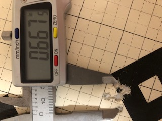

I free floated the barrel on the weekend by simply placing some thin shims under the action, front and back. Didn't remove any timber from the stock. Groups looked OK and were consistent with Eley standard. Still had a few misfires though requiring a second strike.

if you are having misfires with all your ammo i would be calling a gunsmith to get your pin fixed, that last group at 25 or 50? if its at 50 its good enough for plinking and rabbits :thumbsup:

That was the best of several attempts at 50 yards, but the other groups were all at or just under an inch so I am really satisfied with it.
I'm embarrassed to confess that I hadn't realised before that session that at least part of the problem was I must not have had the scope 100% focused. It has always looked really clear and in focus to me out of the box but when I was at the range resighting and checking the scope after floating the barrel, I fiddled with the focus and it became even sharper (and the crosshairs thinner). It was a bit like the time years ago I tried on a mate's glasses and realised I needed glasses. Noobs, amIright?

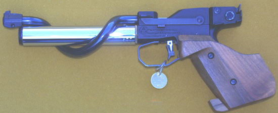

Post by bladeracer » 15 May 2018, 11:50 am
This one shot pretty good.
