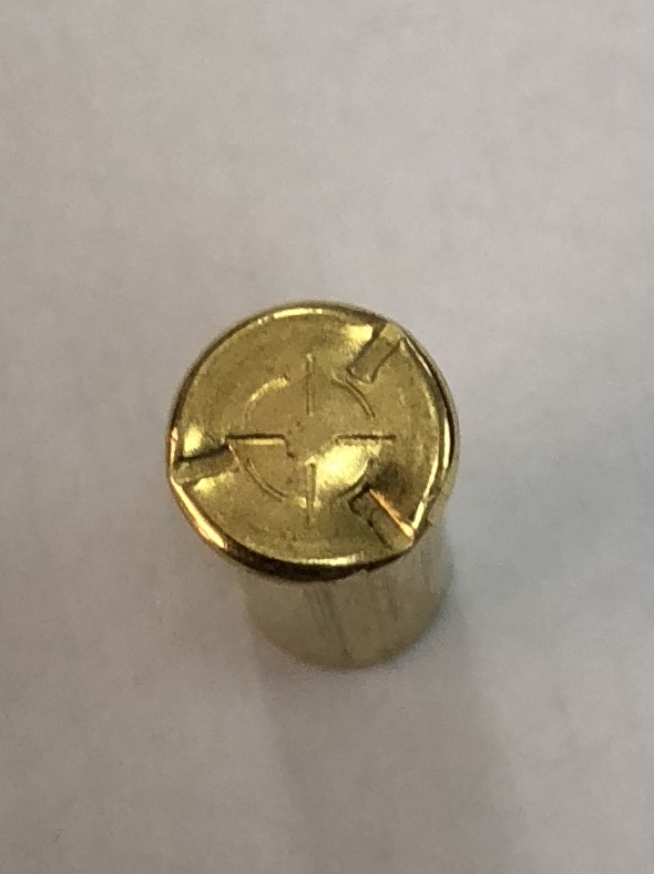

I also got quite a few misfires (1/15) with the SK - the rim looks like it's being struck firmly but one I hit 3 times before it fired. Was also getting misfires from other brands I tried but not as often (maybe 2/50). Ammo or my firing pin?

Measure the firing pin protrusion from the bolt face to confirm it is reaching almost to the breech face. The strikes look good so I don'think it's a spring issue. Does your ammo shoot fine in other firearms?

if you are having misfires with all your ammo i would be calling a gunsmith to get your pin fixed, that last group at 25 or 50? if its at 50 its good enough for plinking and rabbits :thumbsup:

Maybe you need to clean the bolt. Too much grease, oil or crud will interfere with a good strike from the firing pin. Good place to start by giving it a good clean up and then VERY lightly oiling the internals.
