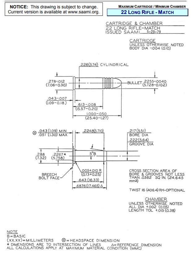

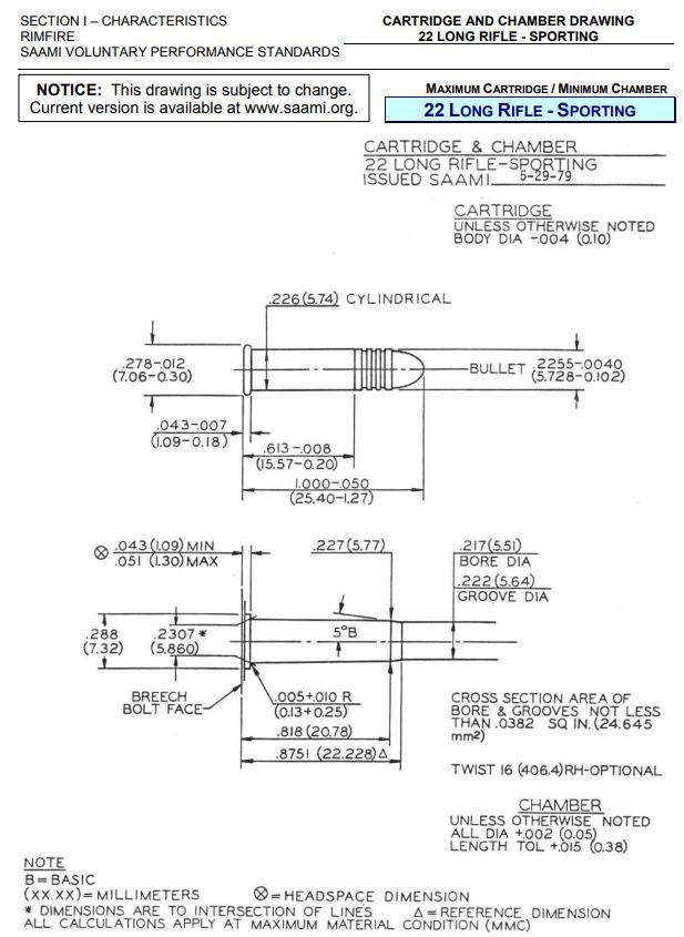

Between the 40gn and 42gn it's certainly possible that the 42gn could engrave the rifling as it's a significantly fatter bullet than the 40gn forward of the driving band. Both driving bands are in the same place though. The 40gn bullet though looks similar to most other 40gn stuff so I can't see why it would be a problem in your rifle. In match chambers though I think it's not uncommon for the bullet to be seated into the rifling anyway, but you don't get that in yours with other ammo?
There is no specified difference between sporting and match .22LR ammo, but manufacturers do reduce the tolerances and make other adjustments if they can see advantages to them.
But a match chamber (this is also modified by various reamer manufacturers) is cut .175" shorter, so that all but the rearmost .030" of the driving band is actually sitting in the throat, and the throat is .1875" shorter, and .004" smaller in diameter.
SAAMI 22LR Sport.JPG (84.98 KiB) Viewed 9838 times
SAAMI 22LR Match.JPG (73.34 KiB) Viewed 9838 times

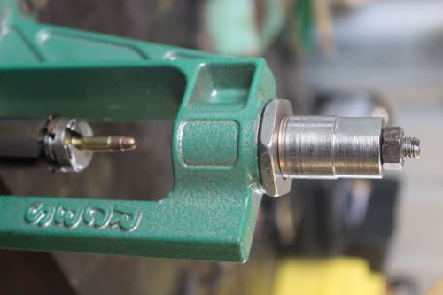

Already started making a shellholder. simply 2 washers with holes adjusted for perfect fit over the rim and the wall of the case. cut a slot in each then tack weld them to a shellholder I'll turn on a lathe.

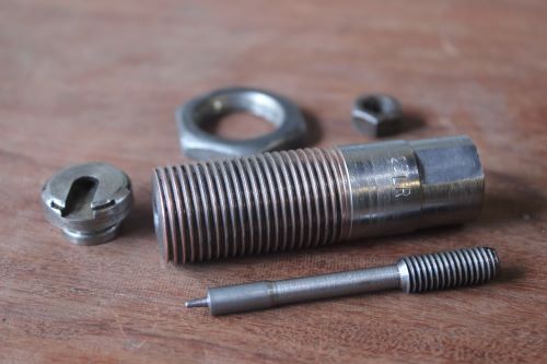

Well, I finished making the reprofiling die and shellholder.
I'm very pleased!! Cost me nothing but some time on the lathe.
It swages a hollow point into solid ammo or creates a larger HP in HP ammo while simultaneously expanding the bullet diameter to .225". Hopefully there is no wind tomorrow so I can test shoot my new HP's.
This opens up a lot of hunting ammo choice. I'm keen to see how the SK flat nose basic shoots as a HP.

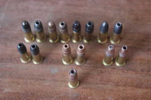

Post by MtnMan » 04 Sep 2021, 9:59 am
I got good value out of this tow ball! I used the ball a few years ago to make a DIY window mount spotlight and now I've used the remaining shank to make a .22lr reprofiling die. 8-)
I honed the plunger to .2245" then honed the bore of the die until the plunger would clear it so it should be very close to .225".
The shell holder is simply 2 washers with appropriately sized slots tack welded on top of a piece of steel I turned to duplicate the shellholders that fit my RCBS press.
Before and after-
Back row left to right-
45gr Win super suppressed solid, 40gr Win super speed solid,40gr SK flat nose basic solid, 40gr CCI quiet solid.
Middle row, L to R-
Eley 38gr subsonic HP, Win power point 40gr HV HP, Remington 40gr HP subsonic.
Front-
CCI subsonic 40gr segmented HP. Ready for detonation!!!! :twisted:

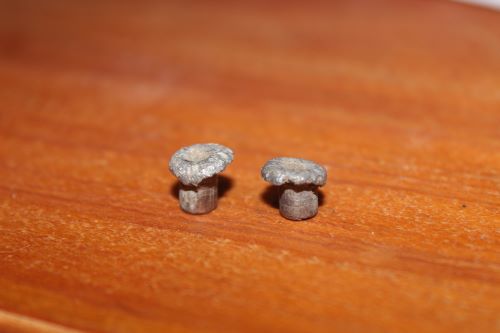

Post by MtnMan » 07 Sep 2021, 5:03 pm
I found a couple of mushrooms today also. The left one is a Winchester super suppressed 45gr DIY hollow point. It now weighs 44.9gr. the other one might be a Winchester power point or super speed HP.
MtnMan

Post by bladeracer » 07 Sep 2021, 5:09 pm
MtnMan wrote:I found a couple of mushrooms today also. The left one is a Winchester super suppressed 45gr DIY hollow point. It now weighs 44.9gr. the other one might be a Winchester power point or super speed HP.
Nice. What medium are they mushrooming in?
