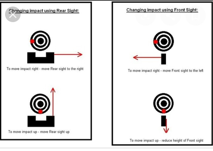

Another question, if I may? Can you adjust an iron sight on a rifle like the model 12? It is currently shooting to the left.
ardroyboy
Posts: 3
Re: Slazenger Lithgow Model 12 Bolt Insertion problem
Post by Oldbloke » 03 Oct 2021, 2:20 pm
Adjusting open sights.jpg (49.43 KiB) Viewed 3042 times
Is that what your after?
Post by bladeracer » 03 Oct 2021, 3:35 pm
ardroyboy wrote:Another question, if I may? Can you adjust an iron sight on a rifle like the model 12? It is currently shooting to the left.
Yep, drift the sights in their dovetails.
