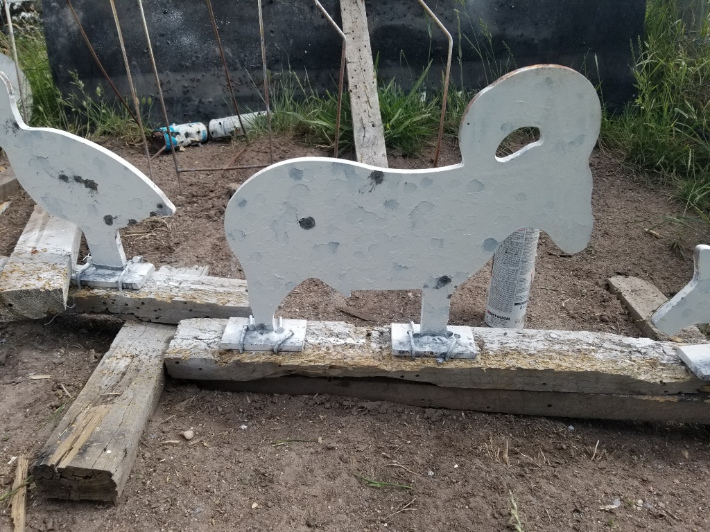

Was out enjoying the weather this arvo :-)
Took the JW21 (Chinese copy of the 9422) out for some offhand steel practice in 15-25mph winds and rain to see if I could learn something (other than the obvious!) :-)
Put 15rds on the chicken with about 50% hits (after I had this issue when I got back out there everything had blown over so I didn't bother inspecting the targets). Put nine on the pig (one dropped shot), then had a fail-to-fire. The previous three rounds or so had needed a bit of an extra pressure toward the end of the stroke to chamber them but it didn't strike me as a mechanical issue. The ftf had a good dent, but it was toward the centre, not the rim. I popped it into the end of the magazine and continued. But the rounds were ejecting as soon as they came out the top of the bolt grooves. Back to the office for a look...

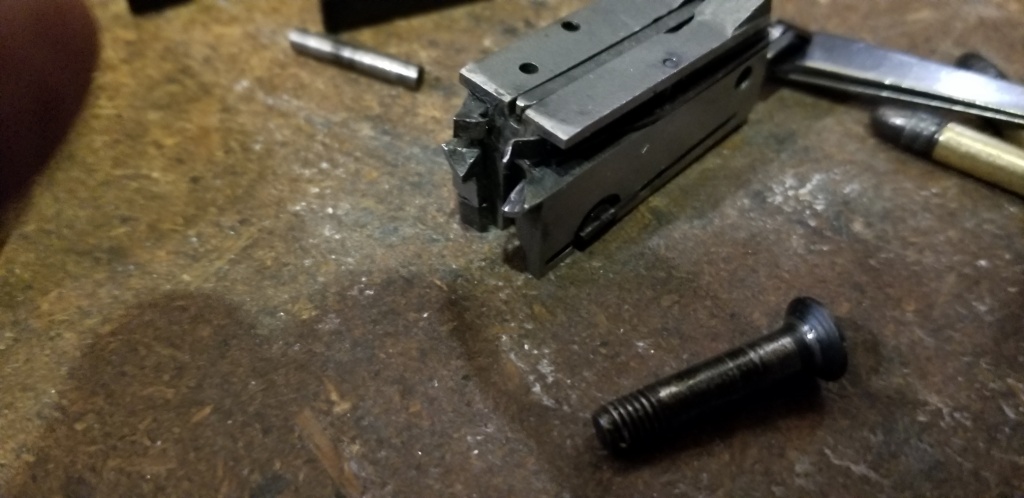

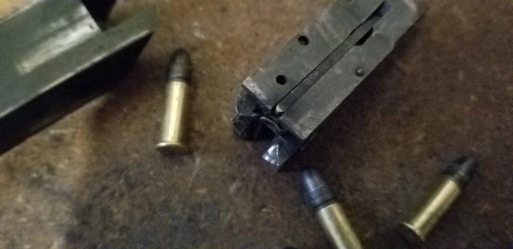

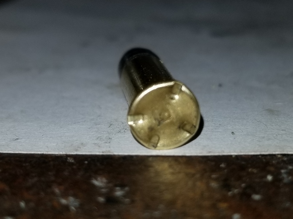

I think I can see the problem :-)
The left extractor has been flattened against the bolt face. It's job is to hold the case head against the bolt face to keep the cartridge aligned to feed cleanly into the chamber, and to apply rightward pressure against the case to keep it hooked behind the primary extractor during extraction.
It must've developed a burr on the bottom that caused the rising cartridge rim to bend it up instead of pushing into position behind it. This would've been the glitch in the cycling, until it was so bent it became caught behind the case head and flattened out, resulting in the bad strike - I'm amazed the action even closed on this! After clearing the failed round, the next rounds were coming off the top of the bolt grooves and immediately being ejected by the obstruction of the bolt face.
I dug a spare out and had it replaced in a few minutes.

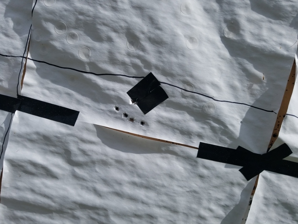

I finished off with a group from 100m, 77m and 50m, kneeling against a post to check the sight settings. 50m and 77m were spot on, but the 100m setting was shooting 120mm high.

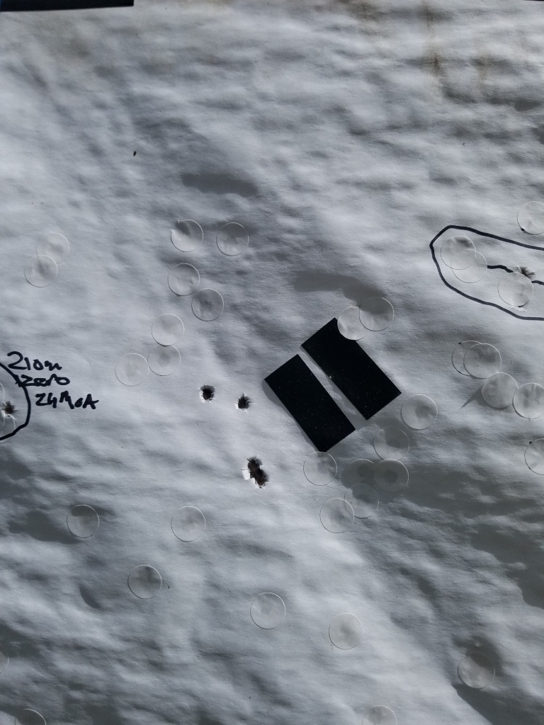

So I threw on a 40-year-old Nikko Stirling 4x32 for a bit of nostalgia :-) Zeroed it on a fence post at 18m, then put two groups on paper st 50m to finalise it.
I couldn't see the holes at 4-power, but I figured they'd be close enough. I went and had a look, came up another 8-clicks, and put the caps back on. Both groups were way better than they should've been for the effort I put into them :-)

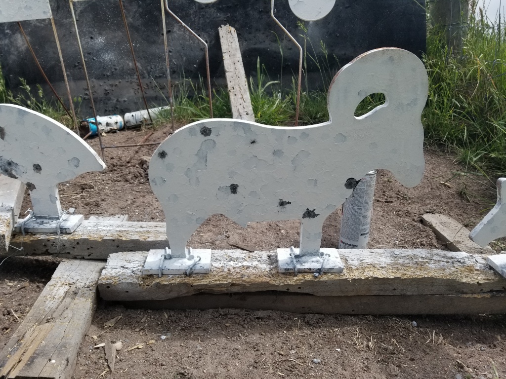

Then I shot the steels again, 15rds on each with Eley Standard. No feed issues this time. It's very rare that I've ever shot the silhouettes offhand with a scope, so that was a novelty.

13 out of 15 on the pig today, only five on the turkey, but my second hit cut the wire holding it in place so it fell forward to 45-degrees, making it extra challenging. 10 hits on the chicken and ram was good :-)
