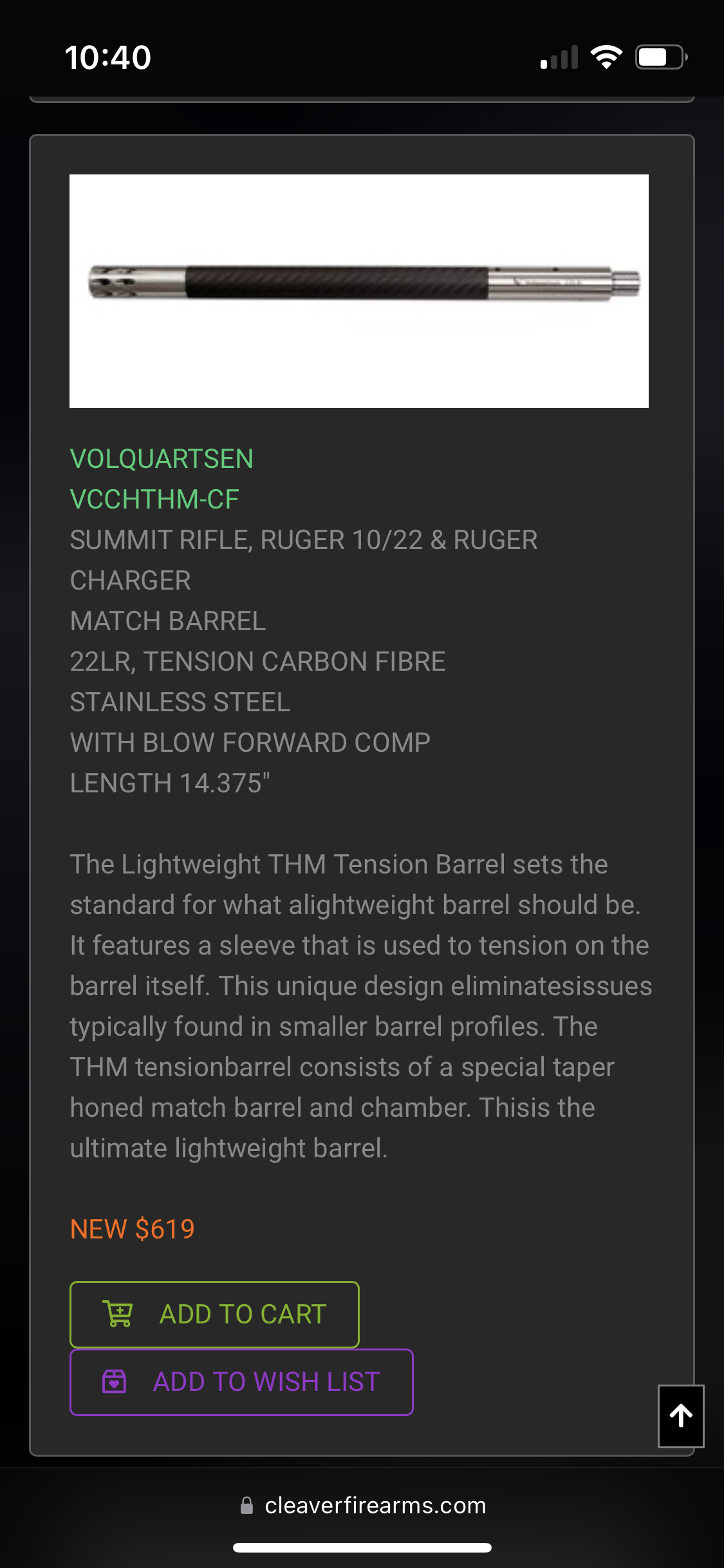

Post by Shootermick » 12 Feb 2023, 10:12 am
I think this Is actually a Charger barrel. But how would it perform on a 10/22?
How short is too short on a 22lr to burn all the powder and achieve reasonable accuracy? I know lots of people talk about 16-18” being a pretty good length.

Re: Charger barrel on a 10/22 rifle?
Post by bladeracer » 12 Feb 2023, 2:31 pm
Depends entirely on the ammo you're using. Something like CCI Quiet would likely be just fine in it, a Stinger might lose hundreds of feet per second.
Accuracy is not effected by barrel length.
Post by Shootermick » 12 Feb 2023, 4:19 pm
Wonder if the CCI Quiet would cycle through a semi auto though?
