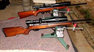

I collected this WBT Lithgow some time ago now.
Had it to the range on eight occasions and managed to score a bad day weather-wise each time. :?
Have benched it a couple of times and decided to shoot it head to head with a 1416 & 1710 as I know exactly what these guns are capable of given ideal conditions and ammo.
I've attached the cardboard backers from a couple of paper targets shot in gusty, wet conditions with no flags - 25X5 shot groups at 50 with 5 lots of SK ammo. 18 of the 25 groups from the LA101 are .5" or better. All rounds were magazine fed. The Anschutz shot similar groups so I am satisfied that this Lithgow will shoot well.
This latest LA101 has proved to be simply faultless "out of the box." I have not had to adjust or modify anything and I can't recall ever having bought another 22 which didn't require some "fine tuning" to function and shoot to my satisfaction. I've put a thousand rounds of assorted ammo. through it so any issues would have surfaced by now.

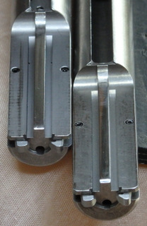

I recently sent the gun to "PK" (resident gunsmith at CRM in Cairns.) PK has worked up a few of these and I asked him to lighten the trigger. He also polished the crown & the cartridge pick up area of the bolt for me.
I've replaced the Leupold EFR with a Weaver V24 so just waiting for a good day now - I'll be very surprised if this rifle won't shoot consistent <.5" groups at 50 with Center X.
Disclaimer: Polishing the bolt contributes to smooth feeding from the magazines as well as less bullet distortion but don't try this at home unless you know what you are doing !!!

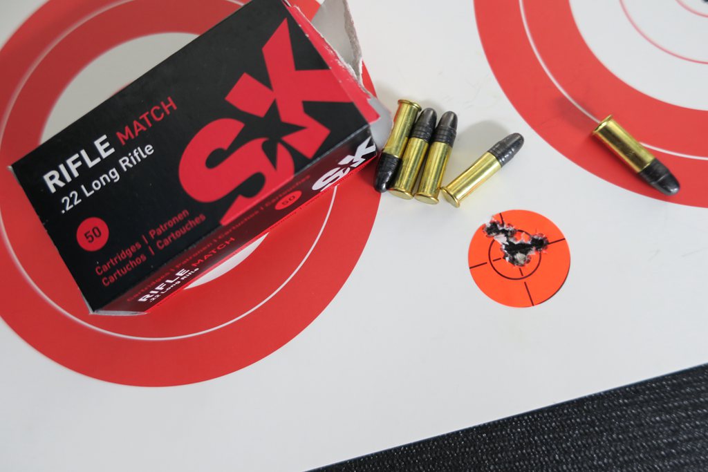

Post by SHV » 30 Dec 2016, 10:48 am

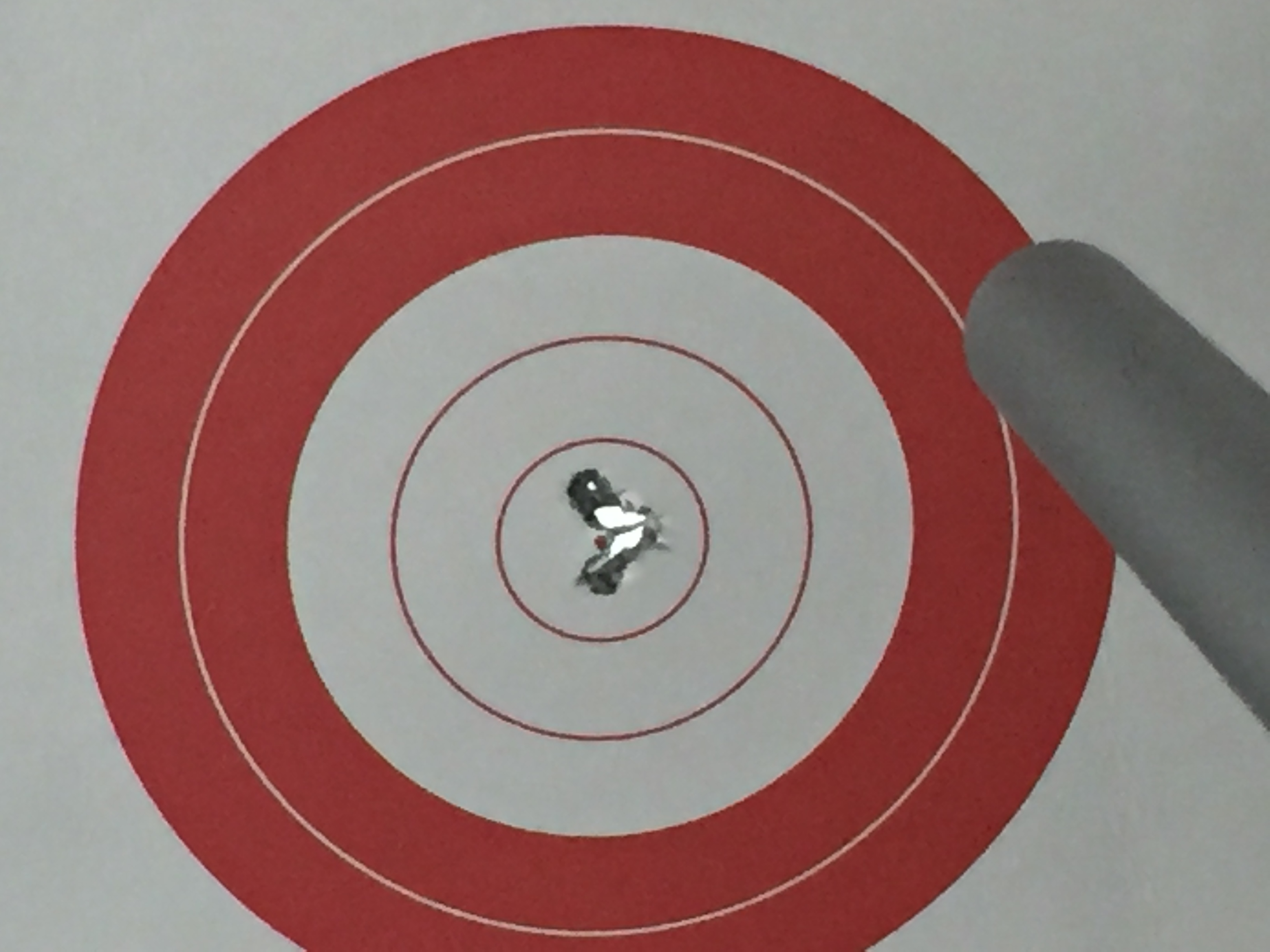

mine likes SK rifle match
first 5 shot 50 meter indoor, first 2 fly a little
SHV
Posts: 1780
Re: LA101 Accuracy Potential

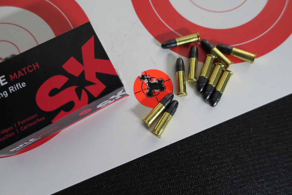

Post by SHV » 30 Dec 2016, 10:55 am
10 shot
SHV
Posts: 1780

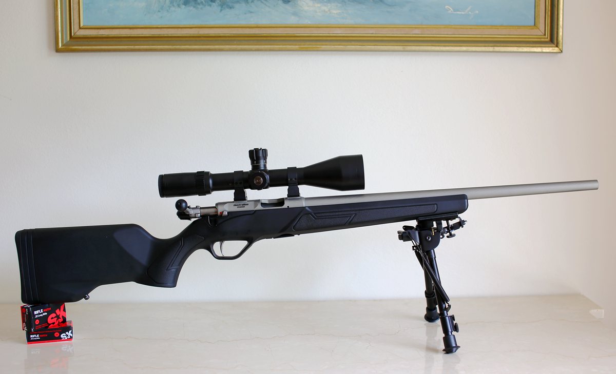

Post by Wylie27 » 30 Dec 2016, 10:58 am
5 Shot group yesterday
50 metres
Bipod no rear bag
Burris E1 Fullfield 3-9x40
