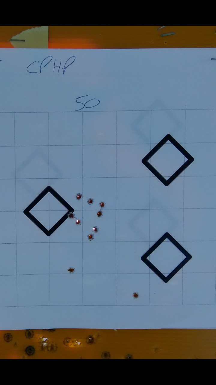

I just bought a jw15a in 22lr. So far I've put about 350 rounds through it with 7 different types of ammo. The best group I've shot so far are in the photo attached (10 shots at 50m. squares are 1 inch). Have people found these things get more accurate with use (of so how much use) and is there anything in particular that can be done to tighten these groups.
Thanks.

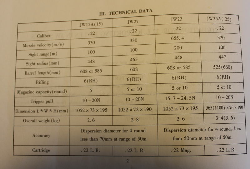

I think the official accuracy guarantee for a four shot group through the jw15a is "less than 70mm at 50m" - now doesn't that scream loose manufacturing tolerances to you? I.e. there WILL be lemons out there (a lot worse than yours). In saying that, there are ways to acurize this rifle (that have been discussed on these forum before). Have a read of this thread from 2016: viewtopic.php?f=2&t=7263

Incorrect, this has nothing to do with my "cognizance" (btw wtf?) From the manual, the only guarantee offered by Norinco for the JW15A is (and I quote) "Dispersion diameter for 4 round less than 70mm at range of 50m" please see here for more detail: download/file.php?id=5433

As for the points raised by everyone, I'm not a novice but not an expert either. Last month I shot my. 223 off the bipod at 100m and put 5 rounds in 18mm centre to centre. So I don't think it all me in this case.
I shot this group off a bench with the rifle on a home made rest. The group was shot from. A dirty barrel and those two fliers happened randomly through the group.
The scope is just a cheap 6X magnification that came with the rifle.
When I got the rifle I stripped it down and gave everything a good clean, including the bore. It was pretty well covered in grease.
I've read a number of reviews on these rifles. Some say float the barrel, some say don't as there is a pressure Point at the end of the stock needed for accuracy (this in particular I don't know much about or how it works. If anyone can fill me in on this.)
As for the barrel to getting enough coating or "seasoning", how many rounds would it take for groups to settle down? Groups have tightened up a bit since the first 150 rounds but this is my first new rifle so still not sure on a lot of this break in stuff.
