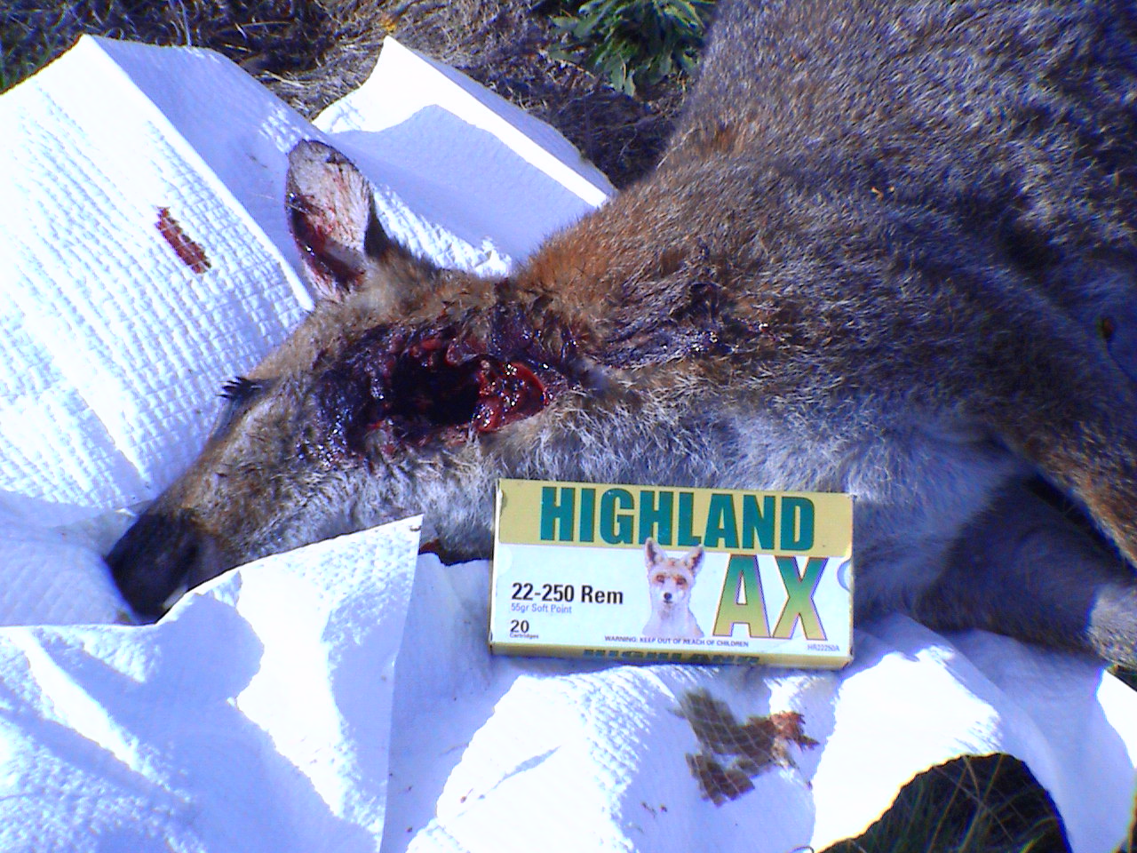

Post by Die Judicii » 07 Nov 2018, 8:44 pm
This one didn't get up to argue or discuss the effectiveness or not.
Just on 220 meter mark.
Posts: 4347

Post by HereSkip » 08 Nov 2018, 5:47 am
nice shot :friends:

Post by bigfellascott » 08 Nov 2018, 1:17 pm
That's cos it's got a splitting headache :D You should see the damage the Sierra Super Roos do to em, very messy indeed as are the Blitzkings, had quite a few with heads completely gone on em out (50gn BK out of the 222 at 50-80m range) it looked like they were removed surgically :shock:

Post by Stix » 08 Nov 2018, 8:02 pm
A bunny's head is quite a big target at 100...so my opinion is i dont think you should be shooting roos if you cant hit them in the skull/upper neck part of the head, at what ever range you can/or choose to shoot from.
Hey DJ...curiosity has got the better of me mate...i cant help but ask...what is the paper towel for mate...?...(did you get THAT excited about that shot...? :lol: :thumbsup: )

Post by Die Judicii » 09 Nov 2018, 5:28 pm
I know,,,,,,,, I've posted this previously, but this time for those that haven't seen it before,,,,,
It was laying in a hollow sunning itself and only the crown of the head and the ears were visible.
I had lain waiting for quite a while for him to move, but gave up and took the shot.

Post by Die Judicii » 09 Nov 2018, 5:36 pm
Yeah Mate,,,,, Magazines like cleaner photos,,,,, :lol: Ya gotta think of the children.
