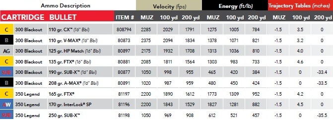

Post by stihl88 » 10 Feb 2025, 10:32 am
Thinking lower velocity of the spectrum, If you're looking at lower velocity/trajectory with hard impact and good BC in a more modern cartridge then 300blk or 350 legend might fit the bill. Otherwise there's handgun/rifle cartridges of which there are many 9mm, 45ACP etc...

Post by stihl88 » 10 Feb 2025, 11:36 am
BC Chart.jpg (74.49 KiB) Viewed 4735 times
