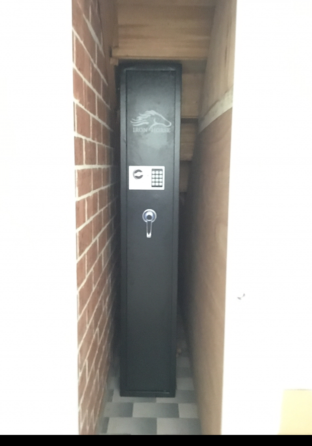

Post by Johnny Jigsaw » 08 Jan 2021, 3:15 pm
Thanks guys for all your great feed back. I’ve attached a picture of where I want to install it. There are gaps on the sides but I will make sure it is bolted down so it can’t move. Hope it will be fine if inspected. This is under the stairs
Johnny Jigsaw

Post by dpskipper » 08 Jan 2021, 4:13 pm
Johnny Jigsaw wrote:This is under the stairs
Looks good, but do be aware under the stairs is a very common place people put safes - I have one there myself. A locksmith told me once that the 3 most common places people put safes (and consequently the first 3 places thieves look for safes) are:
1. Master bedroom
2. Walk in wardrobe
3. under the stairs
If your fine with that, then right on.. However don't think your being super sneaky putting your safe under the stairs, its a very common "hiding" spot.
Enjoy the safe :)

Post by dpskipper » 08 Jan 2021, 5:29 pm
Johnny Jigsaw wrote:Thanks mate.
I will take note of that and see if I can reassess
If you've got your heart set on putting it there then maybe consider shoving some stuff in front of the safe to hide it? Pile up some old shoeboxes or something... Mindful that it'll be a pain to access the safe quickly.
I had a long conversation with my locksmith when I got my safe installed and the conclusion pretty much was that gun safes are pretty big and unless you have a bunker behind a fake bookshelf, you'll never truly hide it like you can with smaller jewelry / document safes.
For example, the locksmith said he personally had a small safe under the kitchen sink, bolted to floor of the kitchen cabinet. Not the most secure mounting ever, but certainly the last place anyone would look for a safe.
