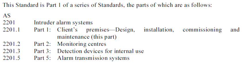

Yeah I just double checked and you're 100% correct BR, no B-to-B monitoring is required as far as I can tell for at least Cat A, B, C, D no matter the amount of firearms present in the home. Just read over AS2201.1 2007 to clarify and can confirm it's mostly devoid of the mention of "Monitoring Centre's" other than referring to them as per below.
- Screenshot 2023-07-26 153424.png (35.36 KiB) Viewed 2261 times
