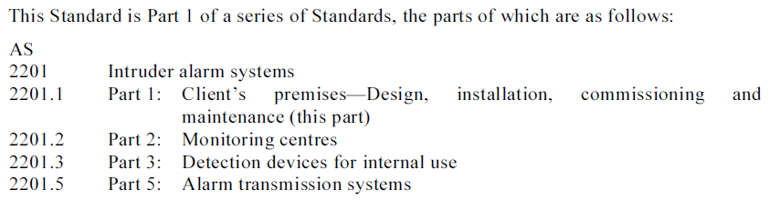

Yeah I just double checked and you're 100% correct BR, no B-to-B monitoring is required as far as I can tell for at least Cat A, B, C, D no matter the amount of firearms present in the home. Just read over AS2201.1 2007 to clarify and can confirm it's mostly devoid of the mention of "Monitoring Centre's" other than referring to them as per below.
Screenshot 2023-07-26 153424.png (35.36 KiB) Viewed 2267 times
I think number of and type of firearms may have something to do with this B-to-B requirement, although I cant find anything in The Act. A mate of mine has some serious stuff in storage, cut a long story short he had to have B-to-B monitoring for whatever reason but was able to remove it as he was able to satisfy B-to-B monitoring conditions by installing a modern security camera system in that it alerts someone (him) of a breach, has a siren and external flashing light.

Yes, the statement about complying with the Standard confused me a lot. I was emailing for quotes for systems that complied and eventually somebody explained to me just how low the standard actually was. Basically any basic alarm system complies, even systems well below what most homeowners would be installing. On a farm a flashing light and a siren are basically meaningless as neighbours aren't close enough to hear or see anything. A system that notifies your phones when the alarm is triggered and CCTV that lets you view your cameras is more useful.
