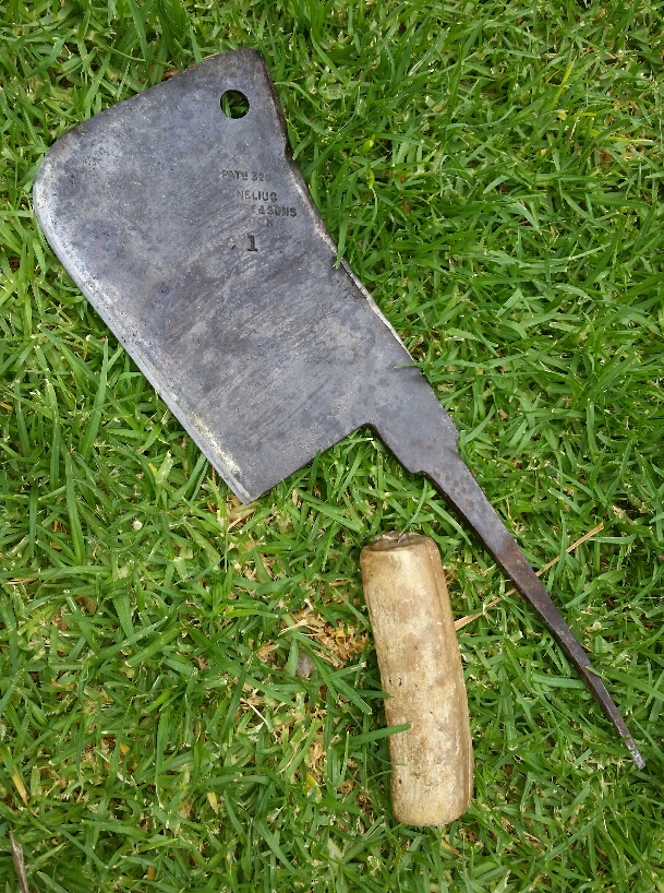

Anyone able to give any advice on how to go about putting a new handle on this ol' beast...?
The existing handle has split & makes it dangerous to use...
It really has a decent amount of weight to it & it comes up pretty sharp without even putting a proper grind on it...so it would be a shame to not be able to use it because of no handle... :unknown:
Any pointers, advice, direction steering would be great.

I'd make a sword style grip and peen a butt plate onto it

This is purely personal taste Stix, but if that beauty was mine, I'd use the bottom of an axe handle.
I'd drill it horizontally for a tight fit and drill the wide end of the tang for one or two bronze hand rivets.

I wouldn't,not with a heavy chopper like that.

It's because it's so big that I'd do it that way, bigpete.
That flair at the toe of the handle that helps prevent your hand slipping off would serve the same purpose on a big butchers knife.
I've even put them on knives. I also found a way to put a coat of copper on old blades I've resurrected. A piece of copper, I used some old sheet, and put it in some hydrochloric acid. I left it until the acid was a good green, pull the copper out and drop in the blade and leave that for a few days then rinse. It put a nice matt bronze sheen.

I'd not drill holes in the wide end of the tang simply because it weakens the tang at a point of high stress for a heavy chopping instrument,same as why swords are jilted the way they are. Plus its extra work too.

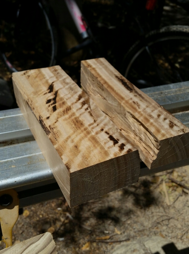

What I would do is get 2 pieces of decent timber,carve a channel for the tang,glue them together on the tang,shape them to suit your hand slightly undersize,wrap with twine to support the grain,then cold peen a metal plate to the butt to prevent the handle slipping off the tang. Sounds like heaps of work but it's not really. Basically how most swords are hilted.

Bigpete is right. You don't want to drill pins in a rat tail tang like that. Your choice of handle material will be important or it will just split again under heavy use.
A nice piece of hollow bone or antler would look good and should last well. Make a forward bolster plate and a rear cap, epoxy the tang and whole thing in place and clamp it all together with a small section of tang protruding. Then peen the tail down to created further mechanical lock between blade and handle. Might be an idea to use a torch to heat the tip of the tail to ensure it is nice and soft (annealed) for peening before fitting it all up.

You're both onto it. If peening the butt plate on is giving you grief, and you've got a mig handy, poke the tang through the butt plate and give it 3 or 4 good hot tacks. Then flap disc the welds down....just an alternative.
Also keying up the tang with some tiny grooves using a 1mm cut off disc wouldn't hurt, along with the epoxy.

Gwion and Ecobogan have the right idea,drill it through, a bit of fiddly file work and two part epoxy and your good to go, getting it hot helps work out where you have to chip/drill to get the tang to fit, make your bolsters and sand your handle down to fit last,a bit of oil and your good to go. its quite that easy but also not that hard just go slow and steady and you want the tangs fit to be snug :thumbsup:

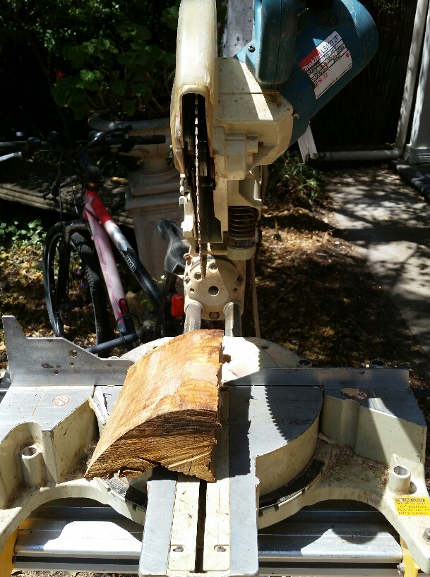

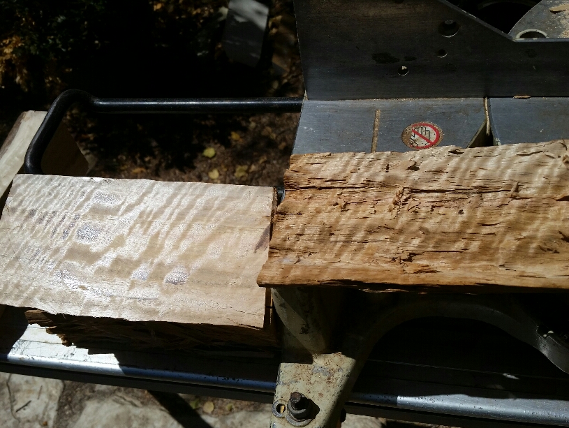

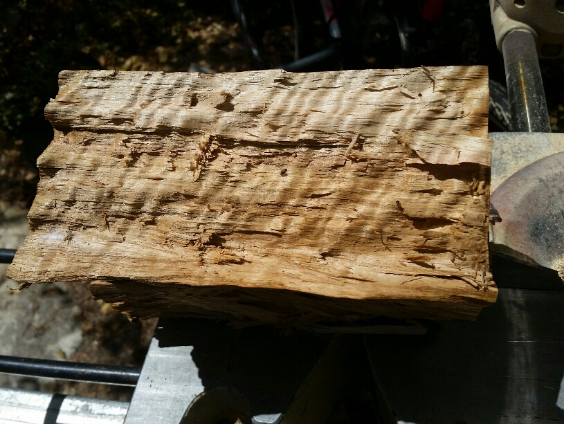

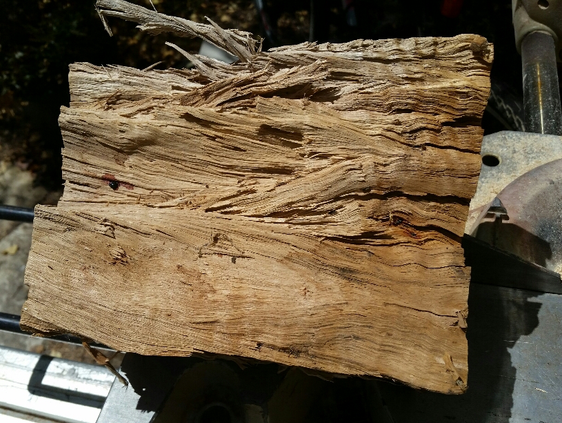

If interested, below is a vouple of pics of wood ive selected & sawn up from the firewood pile.
I tried select good bits...with some fiddleback so should look a treat if it works out... :thumbsup:
