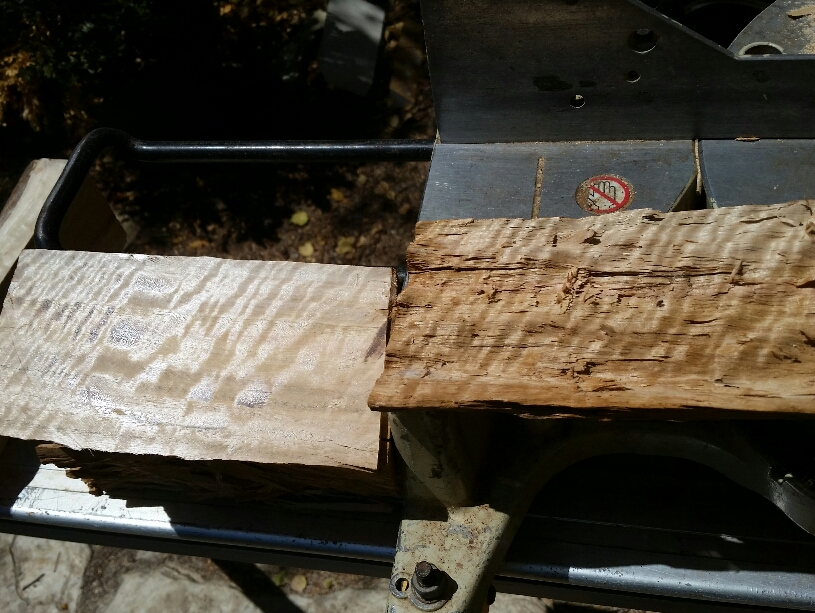

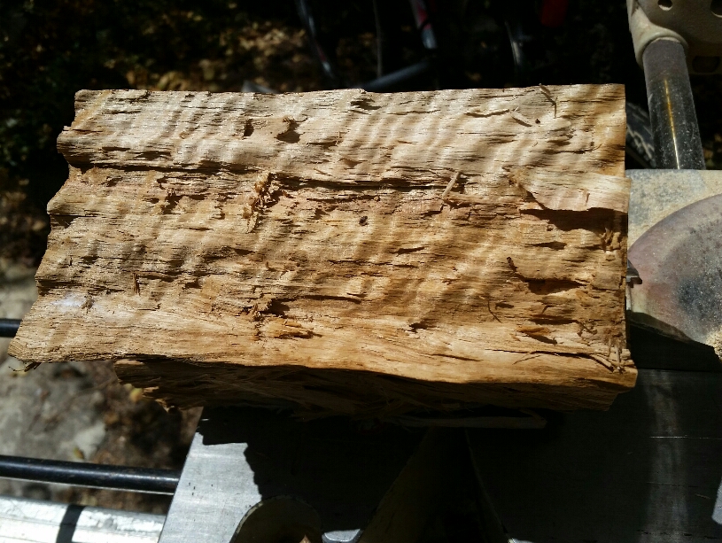

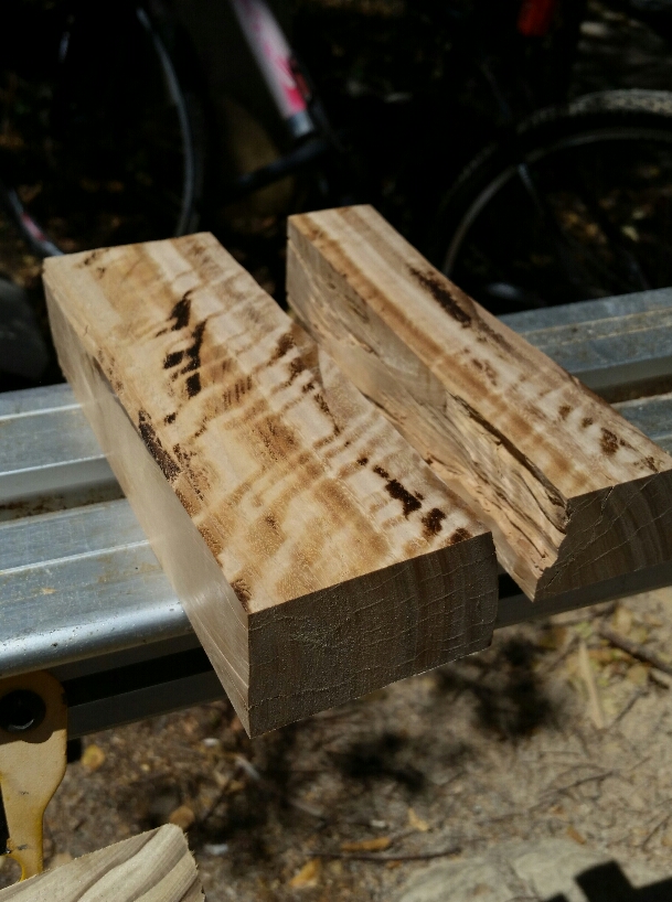

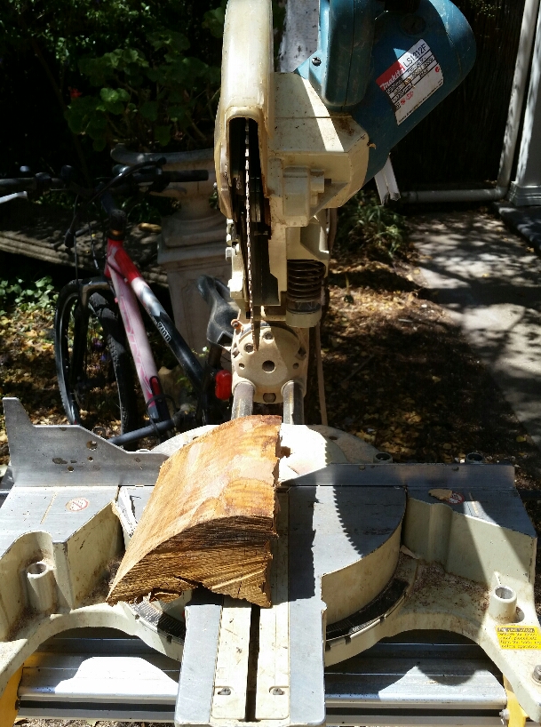

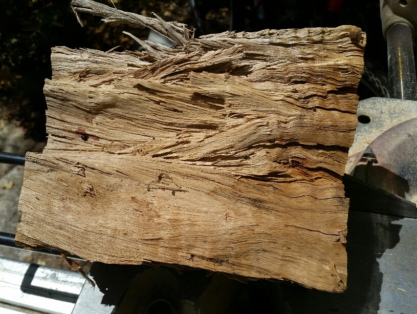

If interested, below is a vouple of pics of wood ive selected & sawn up from the firewood pile.
I tried select good bits...with some fiddleback so should look a treat if it works out...
- 2019-02-07 21.19.03.jpg (450.37 KiB) Viewed 9329 times
- 2019-02-07 21.19.19.jpg (515.46 KiB) Viewed 9329 times
- 2019-02-07 21.19.43.jpg (456.06 KiB) Viewed 9329 times
- 2019-02-07 21.20.01.jpg (407.99 KiB) Viewed 9329 times
- 2019-02-07 21.20.51.jpg (354.17 KiB) Viewed 9329 times
