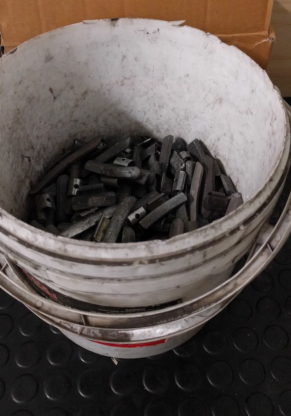

Post by juststarting » 11 Nov 2016, 3:48 pm
Decided to swing past the tyre place I was eyeing for some wheel weights...
Yay! Enough to start methinks.

Post by brett1868 » 11 Nov 2016, 5:41 pm
Be sure to check the markings on them and tap each one with a steel screw driver, if a dull thud fine, a "ting" bin it. Not all wheel weights are made from lead and get a wrong one in the pot and it'll ruin the mix.

Post by juststarting » 11 Nov 2016, 9:26 pm
I stopped by metal junk place and they wanted $3/kg which seemed like bulls**t. I'll have to see if there are any local wreckers here.

Post by Oldbloke » 11 Nov 2016, 10:35 pm
juststarting wrote:Now it's time to order a $20 iron skillet from eBay. f*** me, reloading was supposed to save me money!
Just pinch one of these from the kitcben when the boss aint looking. Or go to the salvo's, I use an old alluminium one on the camp stove.
Plenty of ventilation and bobs your uncle.

Post by juststarting » 11 Nov 2016, 10:45 pm
OB, I was thinking about exactly that that, but thought it might burn through...
Posts: 2727
Re: Loot on the way home...
Post by Oldbloke » 11 Nov 2016, 10:52 pm
Alluminium is fine, SS too. Check the melting points, lead is about 327c and alluminium about 660c. SS much higher, alluminium s**ts it in and lead will not stick to it.
Salvos or garage sale.
PS . Just to start out a SS table spoon or big tea spoon will do as a dipper. Just might need a wooden handle to prevent burn to fingers.

Post by darwindingo » 11 Nov 2016, 10:54 pm
From memory lead melts at about half the temp of aluminum OB, I certainly agree, ventilation is very important !

Post by Oldbloke » 11 Nov 2016, 10:58 pm
Most important.
No watsr to get in molten lead.
Safety glasses
Maybee gloves
Ventilation.

Post by juststarting » 11 Nov 2016, 11:06 pm
ye, planing to do it outside on the bbq, so ventilation is not an issue. I'll most likely get a painter mask thing too...
Everything else, thanks, that's the go then.
Posts: 2727
Post by Oldbloke » 12 Nov 2016, 1:08 am
juststarting wrote:ye, planing to do it outside on the bbq, so ventilation is not an issue. I'll most likely get a painter mask thing too...
Forget the mask, not requjred. You are not doing it every day, just maybe monthly. If you want buy a P2 mask at a safety shop. Dont buy a P1, it is only for particulate/dust. Avoid places like bunnings, they may not give good advice. It will need to be a good fit otberwise it wont be very efficient due to leaks.
