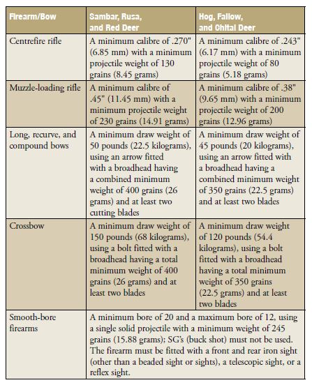

Post by Oldbloke » 07 Sep 2019, 5:24 pm
Each state is different but this is Vic.
Min Deer Cartridges.JPG (78.3 KiB) Viewed 12128 times

Post by Oldbloke » 07 Sep 2019, 5:28 pm
"Also,it's not illegal to hunt deer with round ball to the best of my knowledge....I thought it just said the projectile must weigh 230gn or over....which means 54 cal or over for round balls."
Correct. Minies are heavier, being "bullet" shaped.
Re: Advice for Muzzle Loader newbie
Post by bigpete » 07 Sep 2019, 5:30 pm
Exactly....so choice of a rifles ability to hunt deer with is not so much reflected in its ability to shoot minies well as it is reflected in its ability to shoot a projectile of adequate weight....

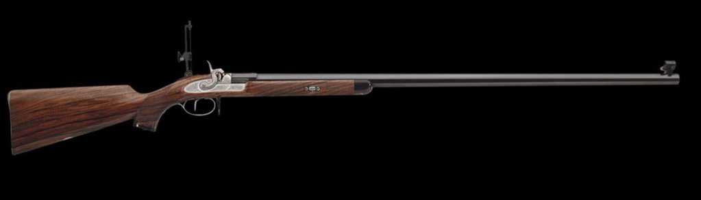

Post by on_one_wheel » 07 Sep 2019, 8:08 pm
I'm yet to buy my next muzzle loader, i keep finding things more important to spend my money on.
My Euroarms BP has a lazy 1:60 twist, it's fun and all but had I bought the right one the first time I probably wouldn't be wanting something with a tighter twist to suit big slugs... I'm keen to send big lumps of led :thumbsup:
I've got my eye on a new Gibbs Deluxe
Thanks for reminding me :lol:
https://www.davide-pedersoli.com/scheda ... eluxe.html
Post by Supaduke » 07 Sep 2019, 8:24 pm
That's a lovely looking rifle.
Supaduke
Posts: 1219
Post by on_one_wheel » 07 Sep 2019, 8:29 pm
Isn't it just, black powder porn ;)
Where's the erection emoji when you need one
