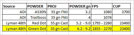

I have a 223 and have been thinking of developing a mild load for areas where distance is shortish and noise is an issue. Along the lines of a 22 mag or Hornet load.
Having done the research I have found that most mild loads use cast projectiles but I would rather continue and use my usual projectile, a Hornady 55gn Soft point. I cant be bothered casting for the 223 as the projectiles are pretty cheap. As it happens I also have a heap of AS-50N which is listed in the ADI manual as equivalent to Green dot.
Notice that ADI lists a load as slow as 1060 using AS-30N which is equivalent to red dot with a Hornady FMJ projectile.
I would like to use the Hornady 55gn Soft points using AS-50N. I'm temped to try it starting at 6.0 gn of AS-50N with the Hornady 55gn Soft point.
Is this do-able and safe. What do the experts think?

Not an expert but I have a load with Trailboss that suits your description. I use 50gn Zmax.

Post by Baronvonrort » 23 Sep 2015, 7:15 pm
I am no expert.
I would use a specific projectile for this, it makes it easier to identify the lower loads to normal ammo.
The pressure is 23400 cup which is less than half the pressure of starting loads with something like 8208 so I reckon it will be pretty safe.
Trail Boss would be quieter because it's subsonic with ADI load data, it looks like you choice has more velocity, it just comes down to how much slower you want these mild loads.
I wouldn't go below ADI minimums,might as well have a try with what you have.

Looks safe/ok to me. But it is very convienient to use the same projectile. However the projectile might be a bit too hard for those velocities upon impact.

I dunno about for ADI powders but I can point you in the direction of Hodgdon Titegroup.
They provide data for this for exactly what you want.
55gr projectile
Hodgdon Titegroup
Max load
Grs: 3.1
FPS: 1,064
Pressure: 4,000 CUP
Search there data here to confirm if you like, http://www.hodgdonreloading.com/data/rifle

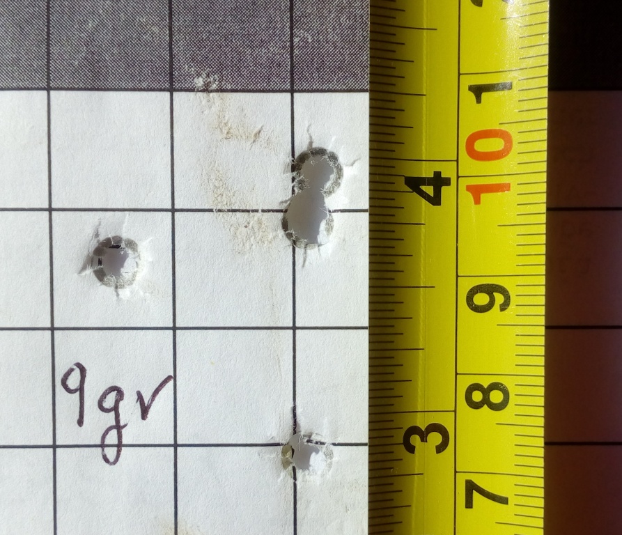

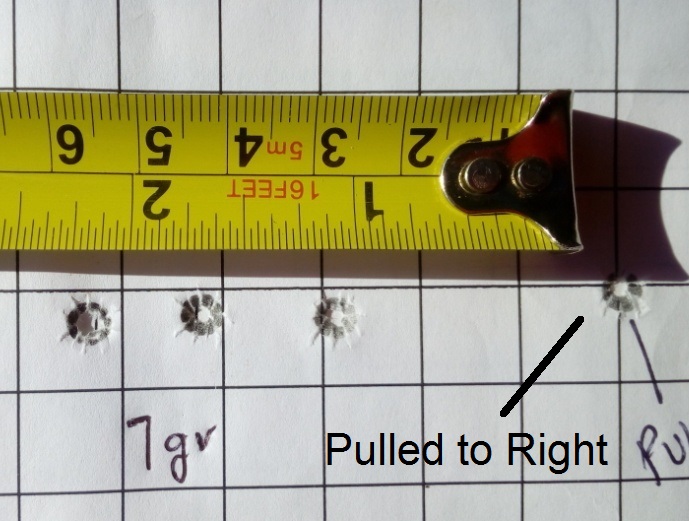

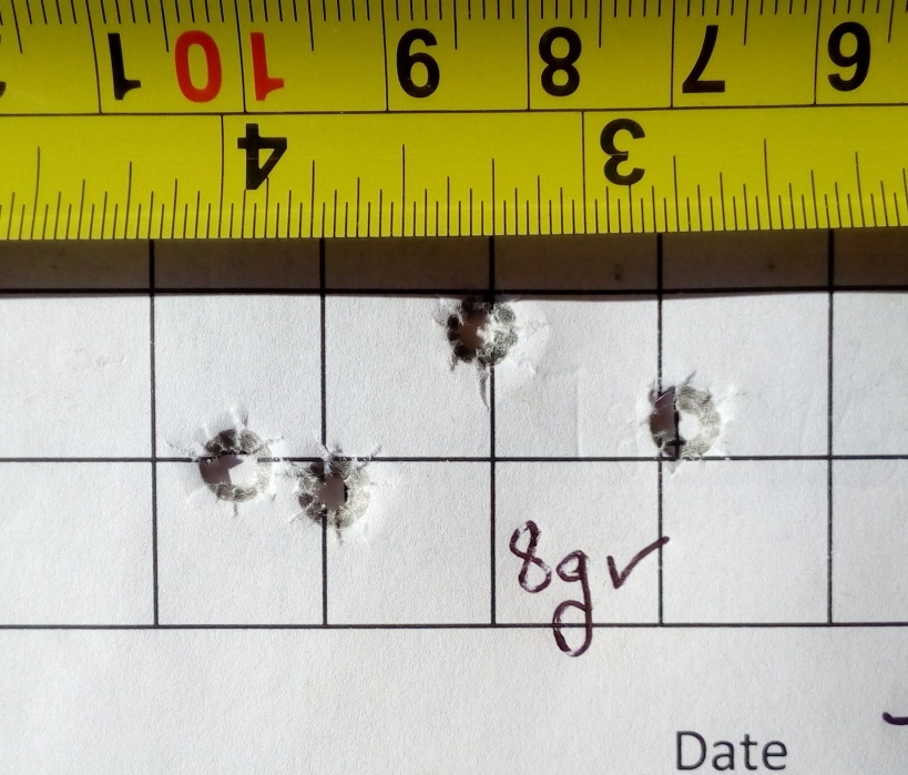

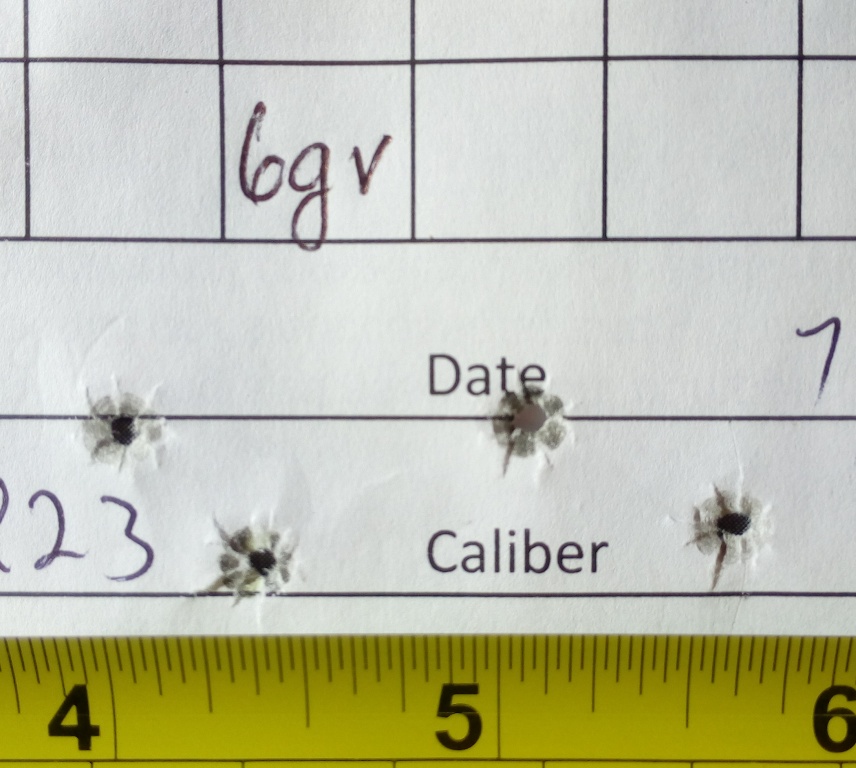

My shoulder has improved so yesterday I finally got out to have a crack at a fox. The foxes won. :(
I also decided to try some squib loads in my Marlin xs7 in 223. Normal re-loads for this rifle shoots about 0.7 MOA but are yet to be fully developed. The rifle seems to prefer loads at the light end as does my other Marlin.
All 4 shot groups were shot with a left to right gusty approx 20 kmh wind over 75 long paces. (conditions were better prior to setting up. ) They were shot off the very sloping bonnet of my I30. So far from ideal conditions and I would expect the groups would shrink a little given a better situation.
Cases were FLRS & loads were 6, 7, 8, 9 & 9.5 grains of AS 50-N under a Hornady 55gn SP #2265.
Three of the 9.5 gr loads were sticky to extract and the primers were beginning to crater. The group also blew out to about 2 ½ inches. (so group not shown)
Note: the grid lines on the targets are ½ inch. All loads shot low as expected.
Speed is not known. But previously found data for green dot suggests from 1550 fps to 2250 fps. Noise level was much lower than normal loads, as expected. All groups are about 1.5 MOA.
I will now load a few more between 7 & 9 grains in the hope of improving the load a little.
The loads that are horizontal would seem to be wind effected but one group (9gr) is more vertical and the wind was much the same for all groups so that has me tossed. Any suggestions?

Post by tom604 » 08 Sep 2016, 12:17 pm
shot the 9 last and was getting tired and/or sick of shooting ? they all show promise but 7 looks to me to be the pick of the crop :thumbsup: with no wind you will only see one hole :thumbsup:

Yeh, gonna load up a few more from 7 to 8gr in about .2 steps and try in better conditions when I get around to it. It will achieve what Im looking for. A more or less 22 win mag or Hornet load. Getting out when its calm is the key.
The conditions were pretty s**t but it has given enough indication to further refine the load.
I also need to finalise my normal load so hope to do them both at the same time.

Post by Gwion » 09 Sep 2016, 6:44 am
OB. Looks like you're on the money but I'd begin my 2nd round testing at about 6.5 and go up to 8.6 in 0.3 increments. I agree that it looks like the best will be between 7&8 but you never can tell; you sweet spot might be just under 7 or just over 8. Getting up to 9 looks like its getting a bit wild.
With your shoulder, the wind and a less than ideal rest platform, it's hard to tell much from what you have done already. It may even be worth loading up 15 rounds @ 7gn and shooting 3 groups under better conditions before testing anymore.
The smaller the charge, the greater the impact of small changes, I find, so the 1gn increments leave a lot of room for exploration.
