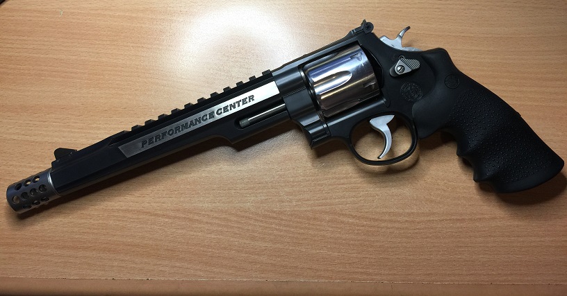

Picked this baby up on the way home from work this afternoon :D
S&W Performance Center 629 Hunter 44Mag

Post by sandgroperbill » 25 Aug 2016, 12:04 am
If I ever get to Sydney, I think I needto visit you...

Post by brett1868 » 25 Aug 2016, 12:50 am
sandgroperbill wrote:If I ever get to Sydney, I think I needto visit you...
Admission to the man cave is a 6 pack of Coke Cans (cold) which is a bargain when compared to the entry prices of a lady's cave :lol:
