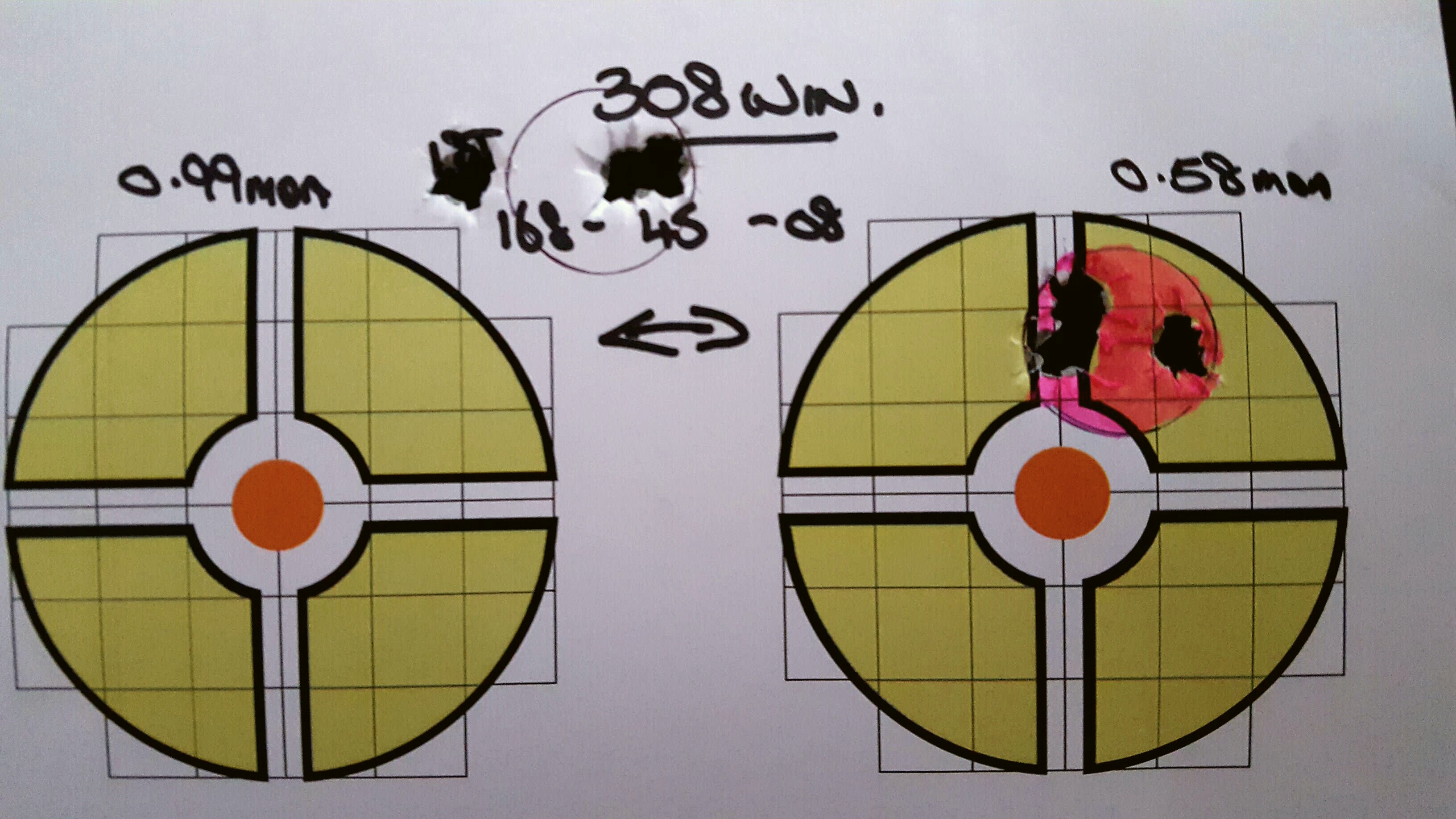

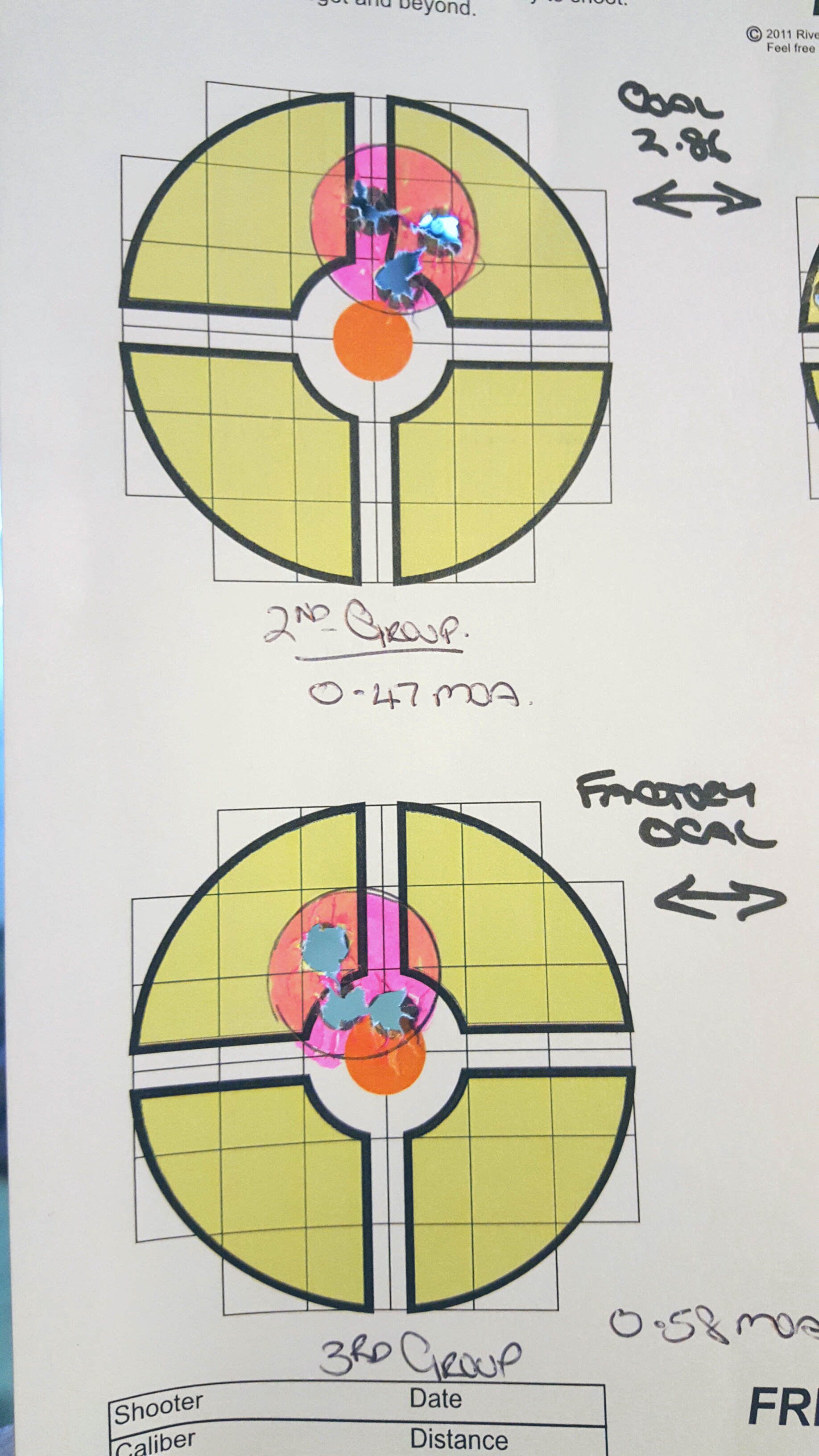

I have attacted a copy of the first few groups shot with this rifle prior to the mag change.
First few groups from the Howa 308

All good now. Clearly the problem was those pic rail screws. Here are my first two group once the rifle was rezeroed. They are also my first reloads for this rifle. Looks like a good starting point.
Thanks again for the helpful advice.

Good news. Well done and have a blast.
Well done on your first hand loads. Looks like they'll work just fine! ;)
