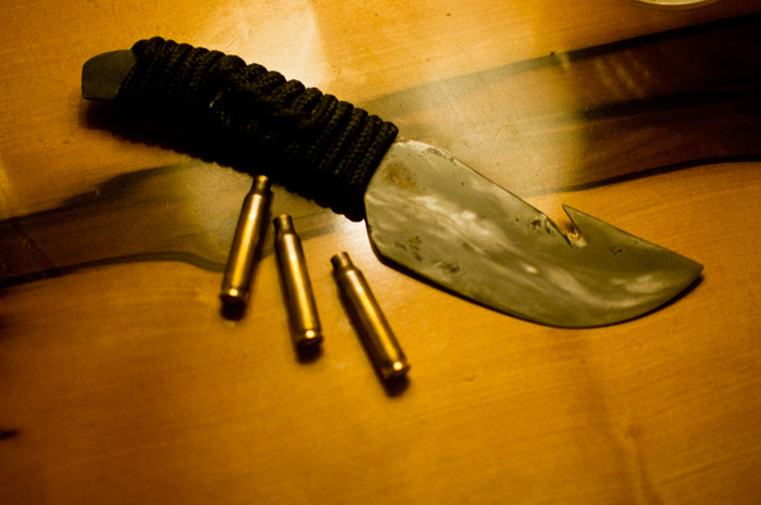

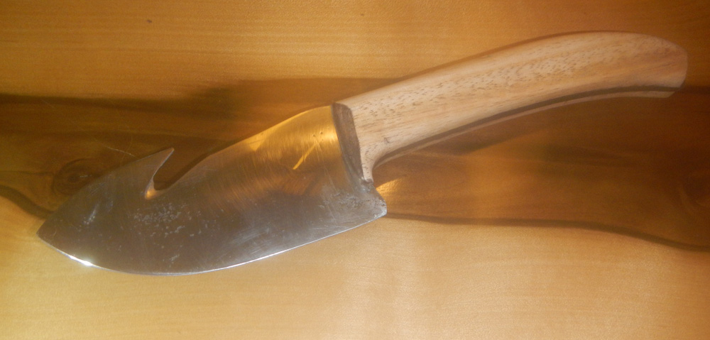

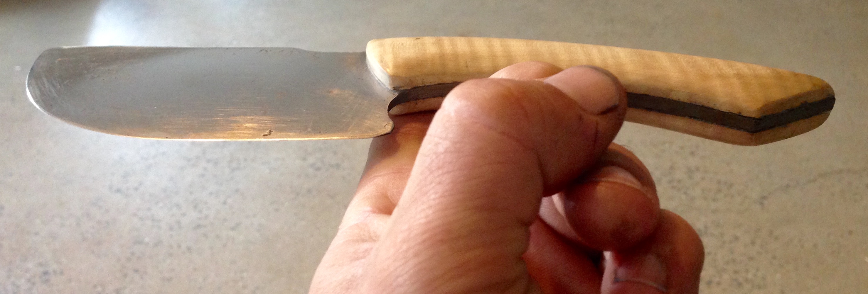

And here are a couple of pics of the first knife i ever completed. Made about the same time as the big flayer... also completely hand made: forged, anealed, draw filed and polished on wet & dry paper and water stones.
Tested on a couple of sheep before being finished... held a good edge so i thought it deserved a propper handle and a polish...
This is how i gave it to a mate who has lent a hand more than a few times around the property... he is also a keen cook and producer of home grown meats.

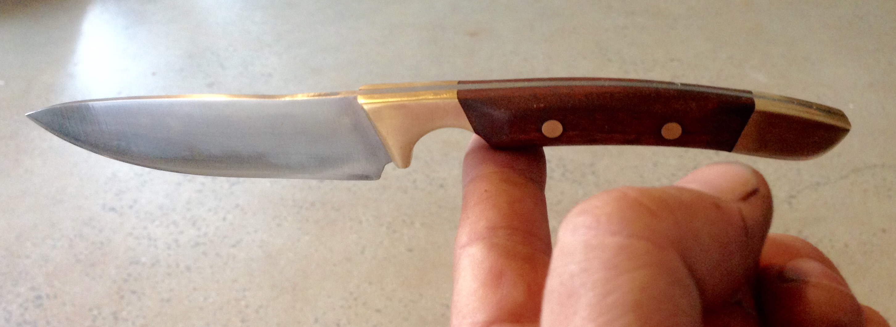

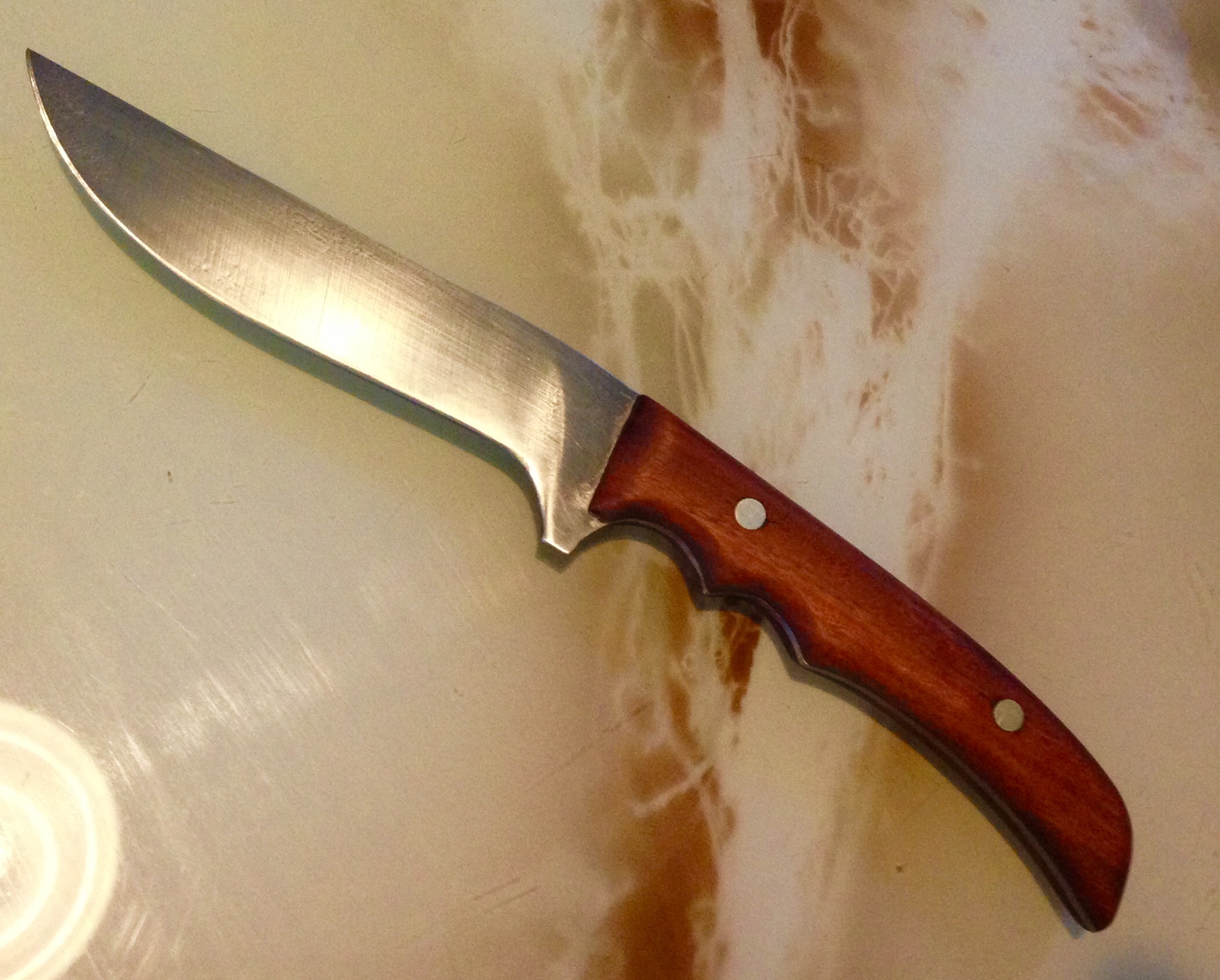

Whipped this one up this arvo out of a failed chopper. Re-ground, heat treated and finished off.

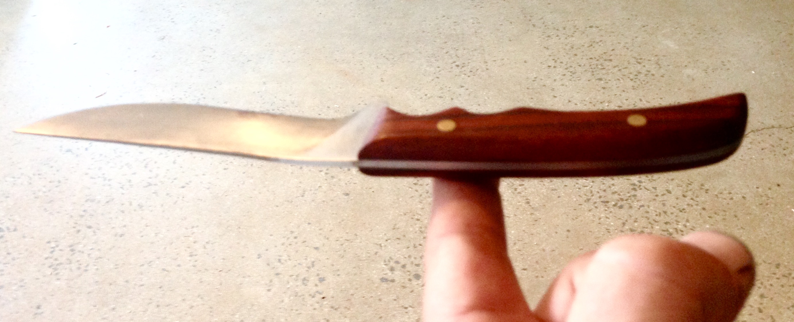

Post by Gwion » 06 Sep 2016, 11:33 am
All done.
Balance points.

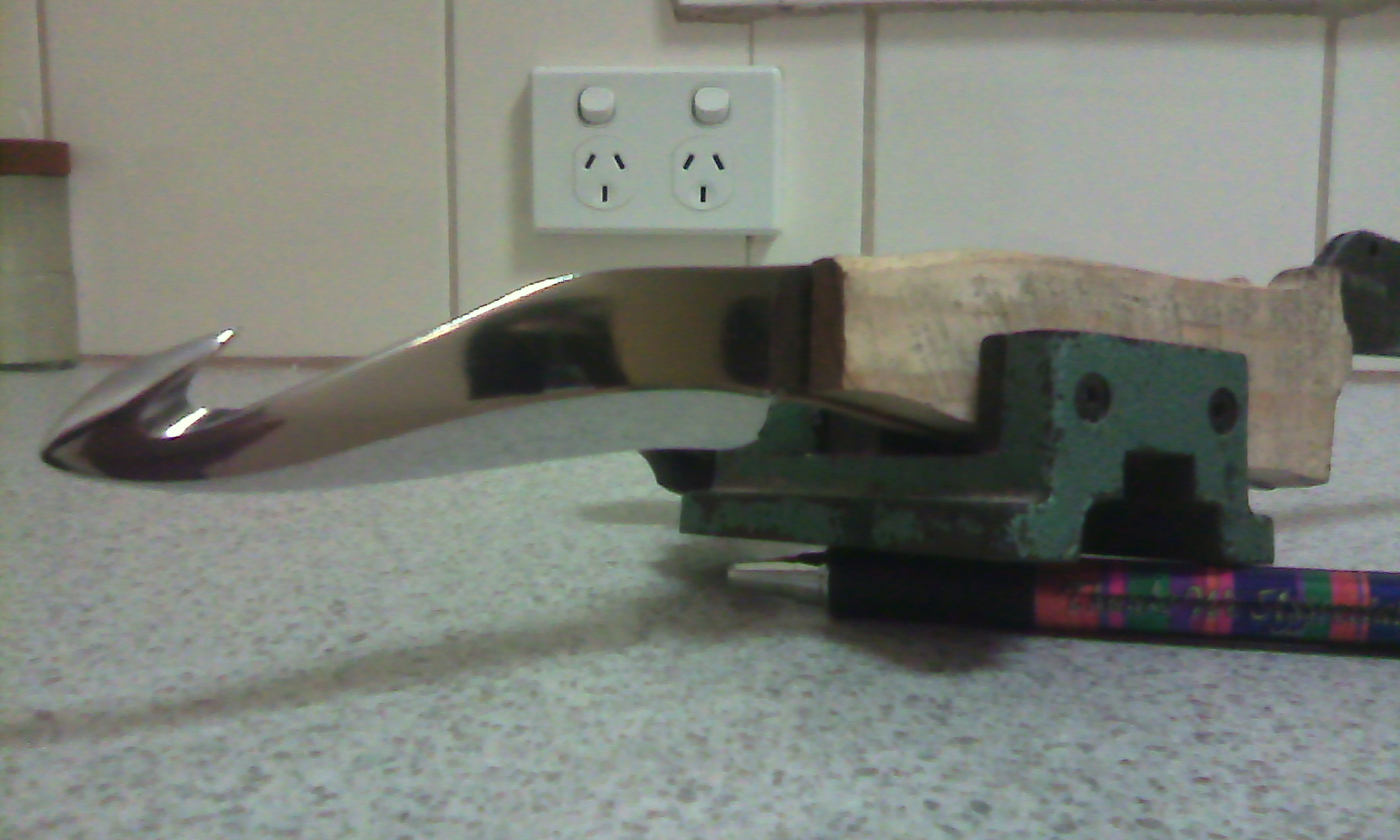

Thanks to this inspirational thread I've got off my a$$ and done some work on the when I get some time to spare, blade..... :D
PHONE PICS ZTE 199.jpg (294.09 KiB) Viewed 6668 times
Need to start thinking what I'll do the handle from, (it won't be the pine that is there to protect the finish in the mini vice) Perhaps a wood/epoxy resin/with a couple of in bedded spiders or something... ????
BTW.. Noisydad !!!!!!, Tom604 said.... "go on...you know you want to,,,,it will be sooo good,,,,no one will know,,,,just try it,,,once,,,one time wont hurt you,,,you could give it up anytime you want"..... :allegedly: ..... LOL Good one Tom.. :lol: :thumbsup:.... You sound like a dealer of knife making lol.... :thumbsup: :drinks:
Thanks for the Inspiration Guys .... :thumbsup:

Looks good, Dingo!
What steel is it? How did you shape it? How did you polish it? (Mine are no where near that shiny!)
And most of all.... How do you keep a work bench so bloody clean??? Makes me ashamed of the shambles that is me work space!!! :Lol:

Post by darwindingo » 14 Sep 2016, 1:04 pm
Gwion wrote:Looks good, Dingo!
This one is just made from an old solid Stihl chainsaw bar, roughly shaped it with the angle grinder and then file, file, file....... Then the usual heat treatment and back on the files. After that wet sand for ages by hand :oops: then polished with Autosol metal polish (there are better polishes, its just what I had laying around) using a polishing wheel on the drill taking care not to get the blade to hot.
This method is not quite as enjoyable as pounding one out of a leaf spring, but it does demonstrate that its possible produce a reasonable knife using basic tools that most people have in the shed (good method for anyone that doesn't have an anvil). Also, this way you don't get the stare of death from the neighbors :lol:
Btw.. Gwion don't feel bad about the work bench, that pic was taken on the kitchen bench when the misses wasn't looking :twisted:

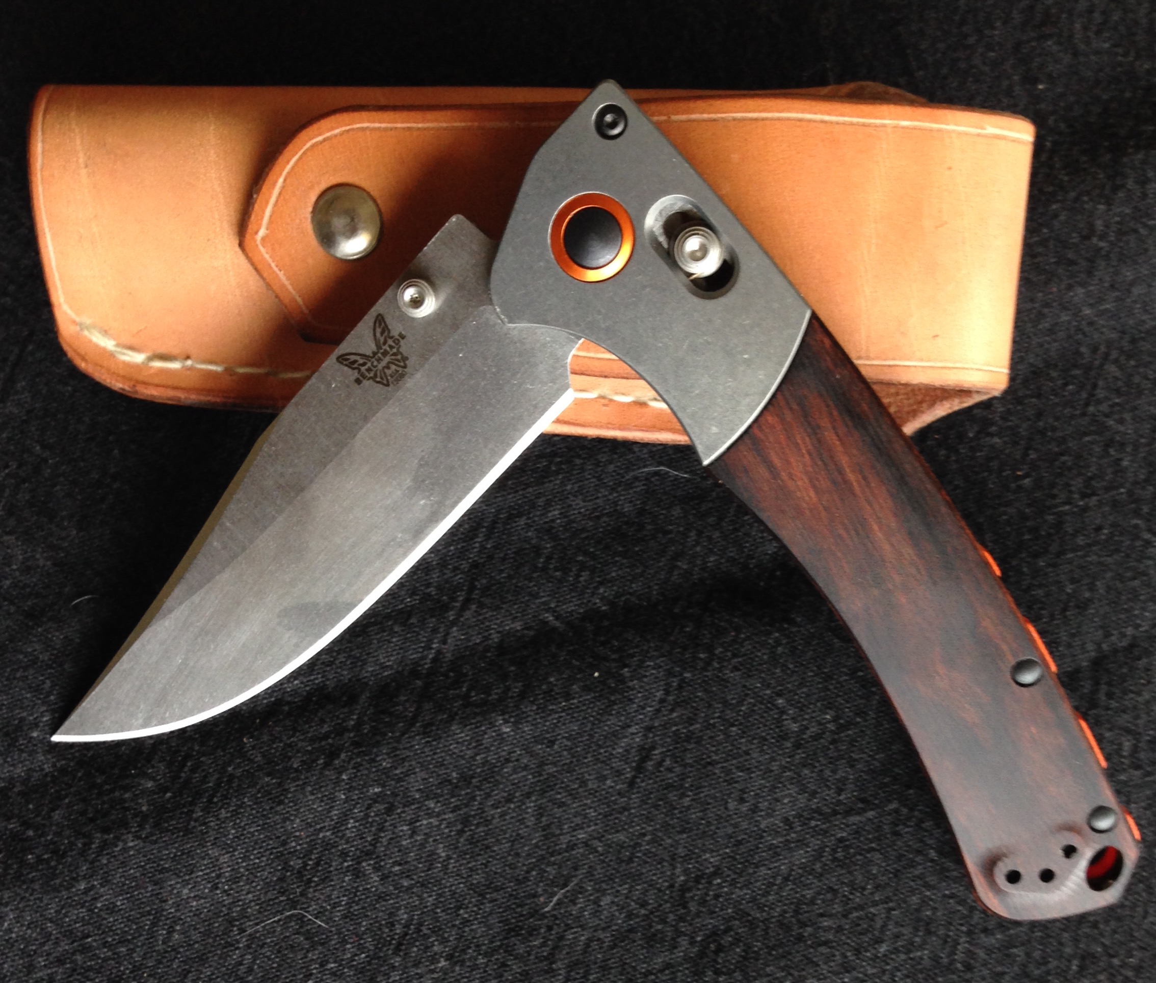

By the way. Got a new knife today.
My old Benchmade (bought in early '97) needed some repairs in the pivot but they haven't made that knife since 1998 and didn't have parts to fix it so they very generously offered my a BIG discount on s new knife.
Very happy camper!!!
I did a pretty bad job of peining a brass rod in the old one to fix it this morning. Looks like crap but is solid again... for now.....
Love my new folder!
The old and the new!
Edit: knocked up a belt pouch for it last night.

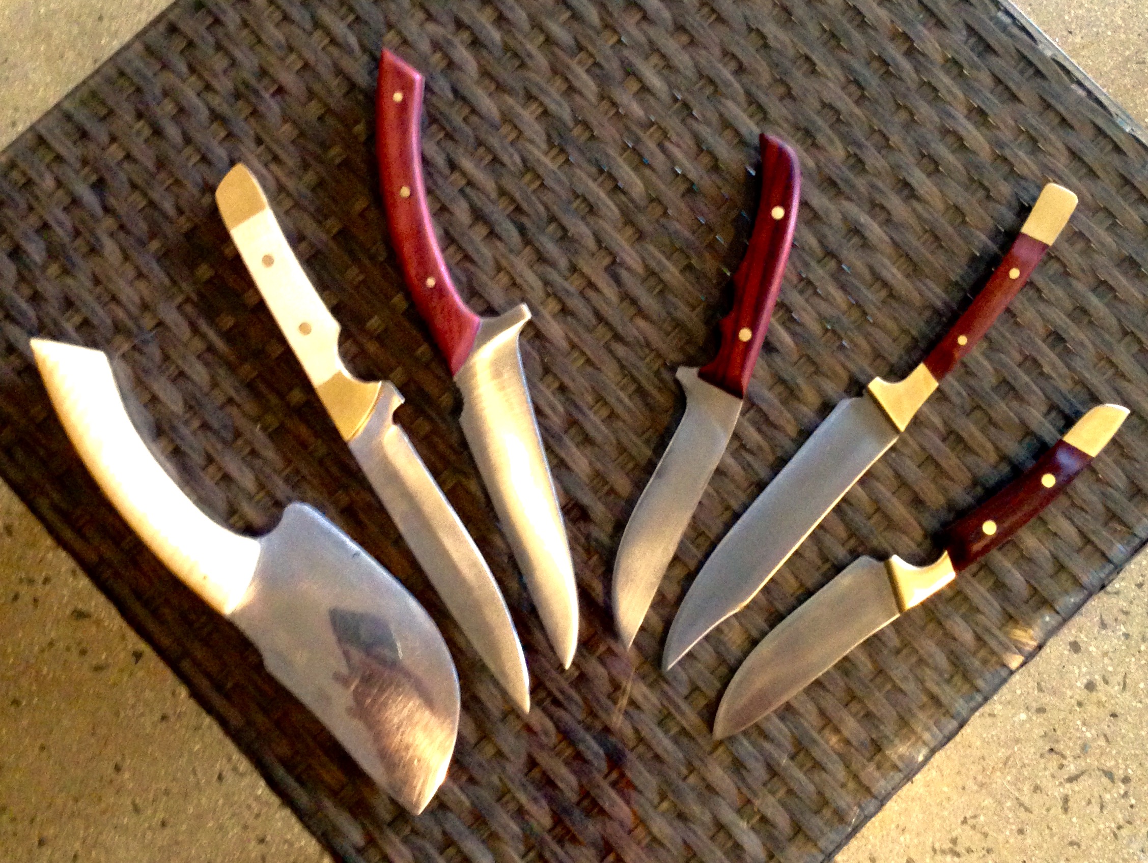

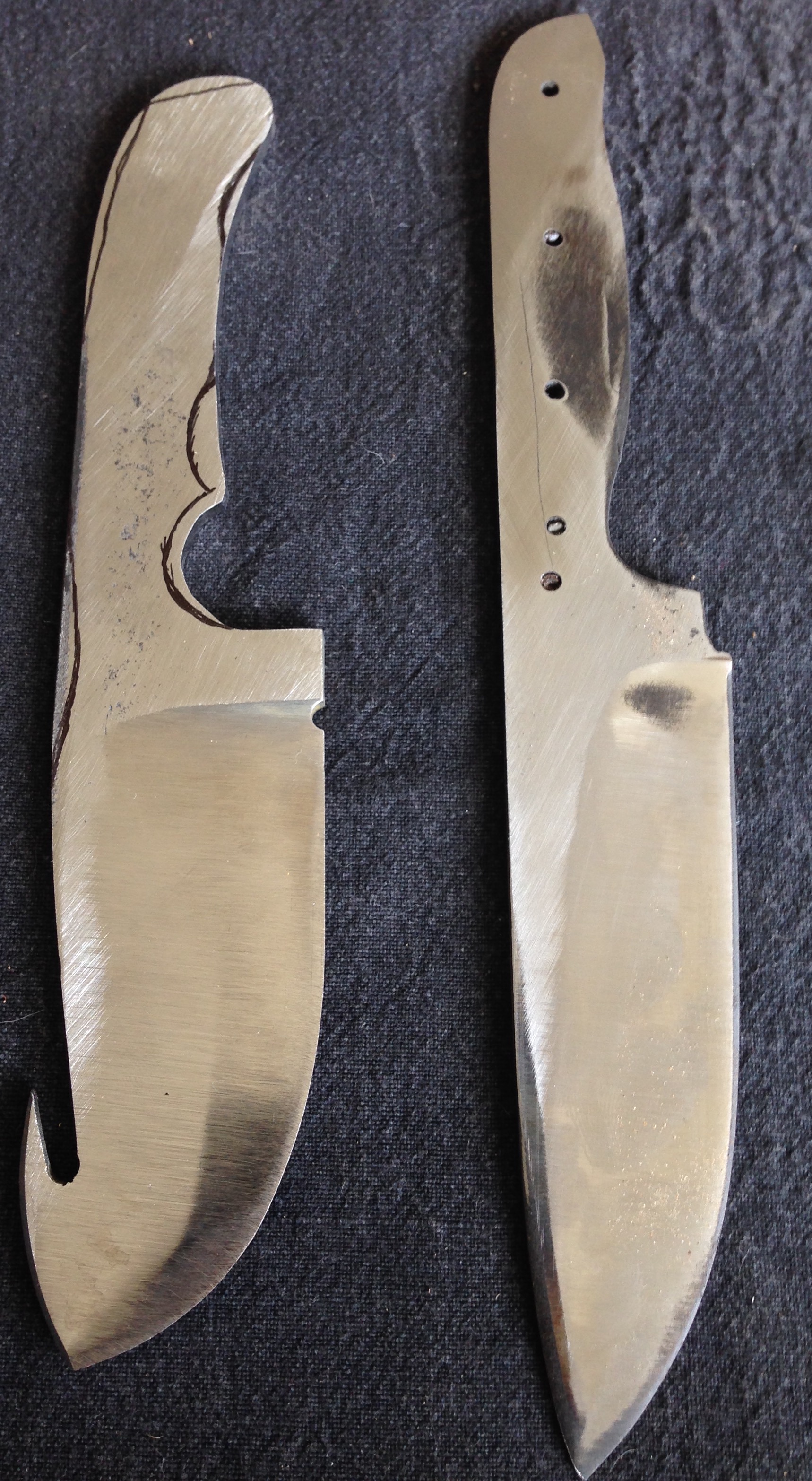

Here are a couple that I should have upto polishing stage by the end of the day.
I have to re-heat treat the one on the right because it developed a warp while I was tempering the spine to a spring blue. Tempering worked great but I heated one side too fast and it took a woop...
Blade length on the right is 5". Not convinced I like the handle shape on either one so I might tweak that as well.

Post by darwindingo » 16 Sep 2016, 5:58 pm
Looking good mate !
Gee, you don't mess around. I like the finger grips on the skinner, really looks like it would have a nice feel to it. :thumbsup:

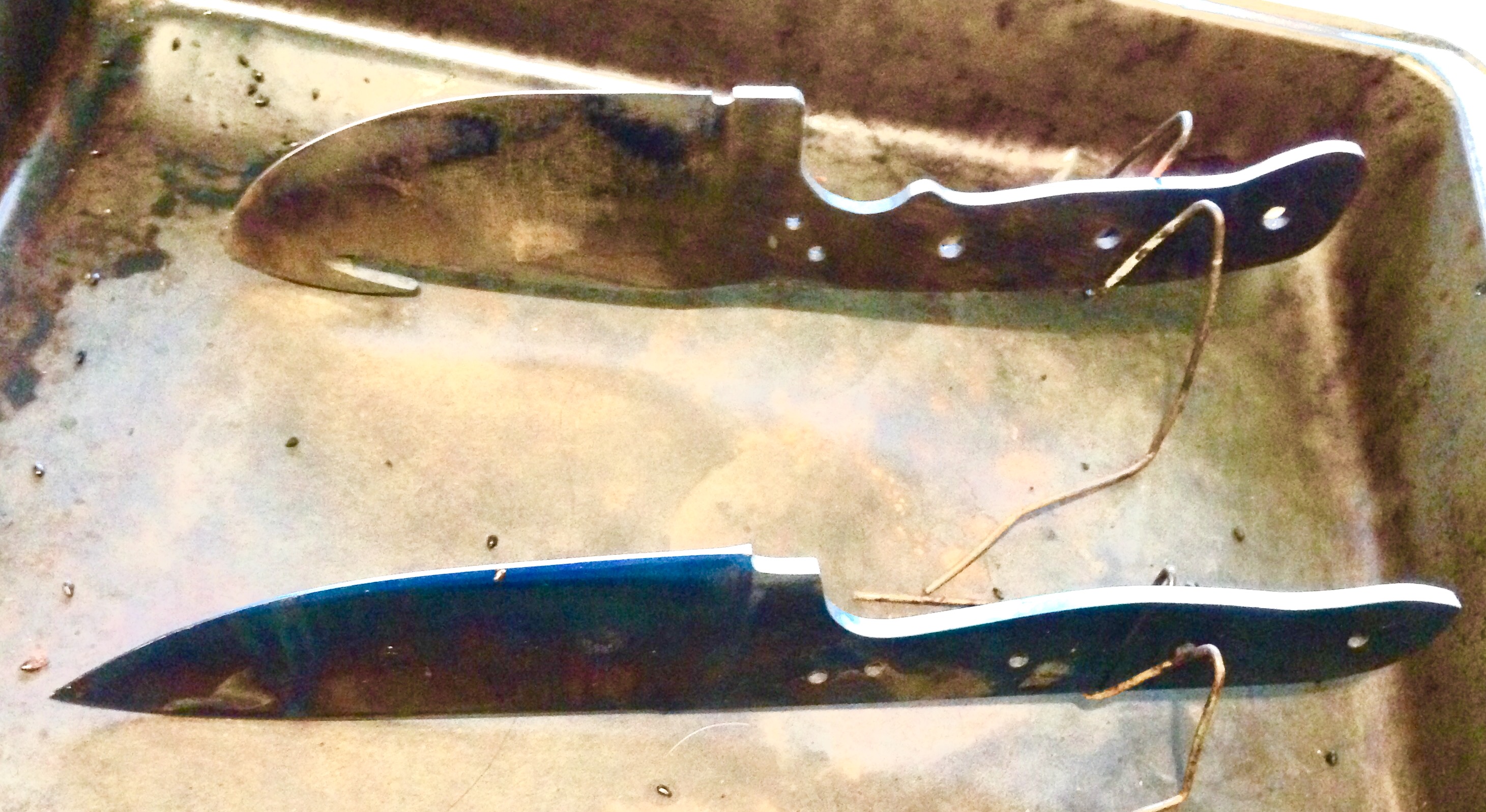

Post by Gwion » 18 Sep 2016, 7:51 am
Bah!!!!
I only have a combustion stove and the oven is ******....
Put the knives in to temper at what said 220C for 2hrs... Should have come out light straw yellow.... Came out Spring blue, which means it was WAY hotter than 220C!!! Will be too soft for a good edge so I have to go through the whole heat treat again!!!
NOT HAPPY JAN!!!
