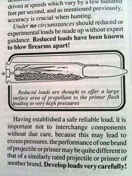

Very light loads with slow burning powders are not recomended. (This includes loads significantly less than the recomended starting loads) These can, although rare result in very high pressure and destruction of the firearm, potentually causing serious injuries to the shooter. Tailboss or fast burning powders are a safer option.
I believe light loads of 2206H would fall into this catagory. Suggest you contact ADI for further info and to confirm it is a safe load prior to using.

Yep, just saying. It depends on a few variables. This is a copy paste straight out of the ADI Reloafing manual safety section. An email to ADI wouldnt hurt. One more point, it doesnt happn very often so the loads might be ok for ages then the 131st goes bad.
"20.Take special care when working up trial loads with slow burning powders in large calibre cartridges. Light loads in some calibres may produce occasional dangerously high pressures. It is suggested that minimum loads in large calibre cartridges should not be reduced below about 75% case capacity."

The effect is called detonation or the Secondary Explosion Effect and there are a few theories around if you do the google. A
"Depends on the cartridge.
I've loaded 8x57mm down to 20gns of 2206H at 1050fps with 180's with no problems.
A maximum charge is around 46gns of 2206H."
20gr of 2206H is about 43% of case capacity using a medium to slow powder so this load could be a contender for an SEE. ADI recommends no less that 75% of case capacity as I posted last night.
Ive just dropped in a pic and a link to some further info below. FYI Also In these situations often there is no warning or pressure signs prior to the event.
http://reloadammo.com/liteload.htm

20gr of 2206H is well under 50% of a medium to slow powder so could be a contender for an SEE. ADI recommends no less that 75% of case capacity as I posted last night.
I am well aware of the potential problem thanks OldBloke :-)
As I said, I don't shoot this as a regular load since Trailboss works so much better with even less powder.
But unless you try it yourself you're not going to learn much just going with the accepted flow.
