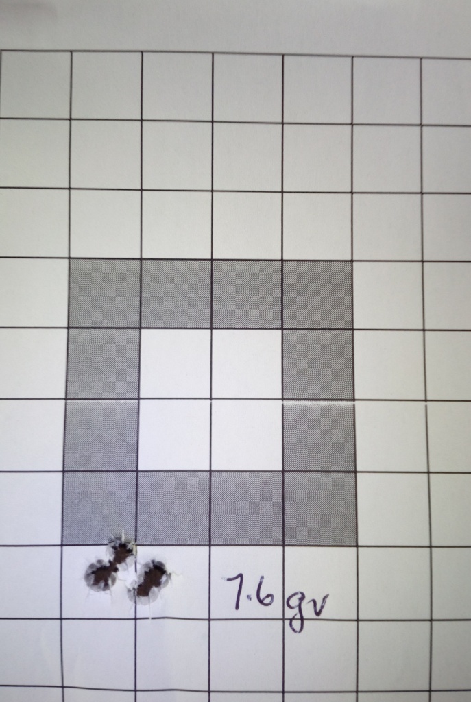

Post by Oldbloke » 28 Sep 2016, 10:43 am
So, I got to eagle park about a week ago and shot off the above test loads. I wont bore you with the BS but I seem to have found a load that works in my 223.
7.6 gr of AS50N gave me a group about 1/2" at 50 meters. (target grid is 1/2") its about 2' low compared to my normal load as would be expected. Most of the other loads were around 1".
Just to roughly compare my load against a 22 win mag & Hornet. I ran the data that I had through the Hornady calculator.
Proj - FPS @ Muzzle - FPS @ 125 mtrs - Ft lb Energy & 125 mtrs
22 Win Mag 50 gr 1700 1107 136
Hornet 50 gr 2400 1951 421
223 squib 55gr 2100 1707 387
I have assumed that my load is 2100 fps But could be anything from 2000 to 2300 fps. Anyway I think it is safe to say it is about double the energy of the 22 mag and a little under the Hornet. I hope this helps anyone trying to develop light loads for their rifles. mm tables will not align for some reason.?
7.6 gr AS 50N @ 50 mtr.jpg (193.35 KiB) Viewed 4517 times

Good stuff OB!
What sort of sound level does this load produce?
