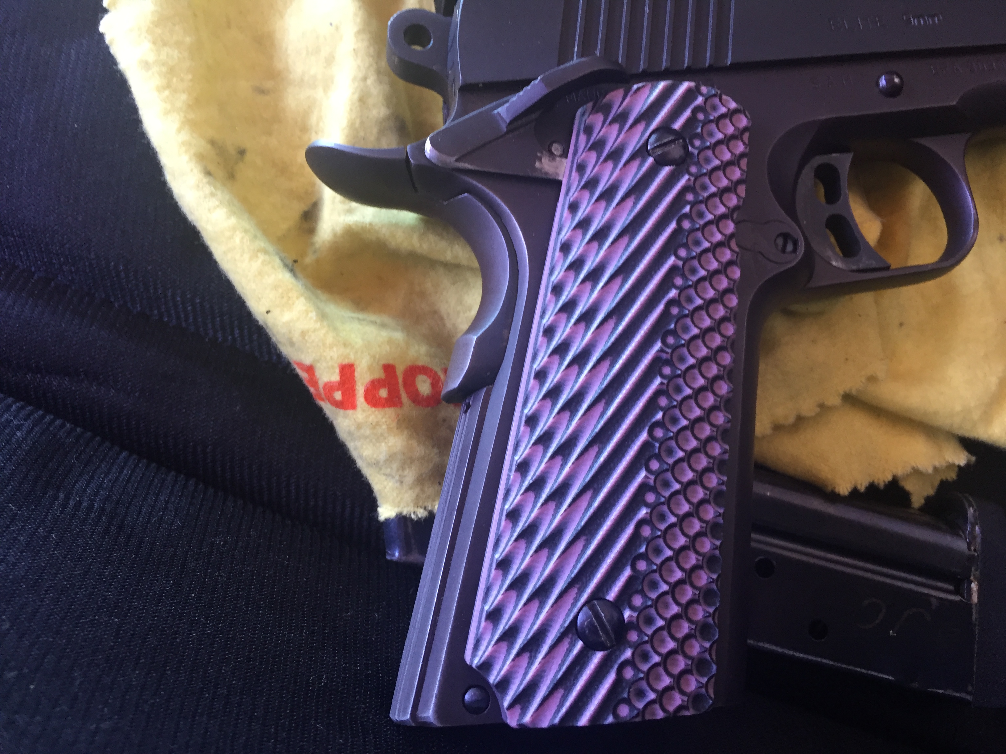

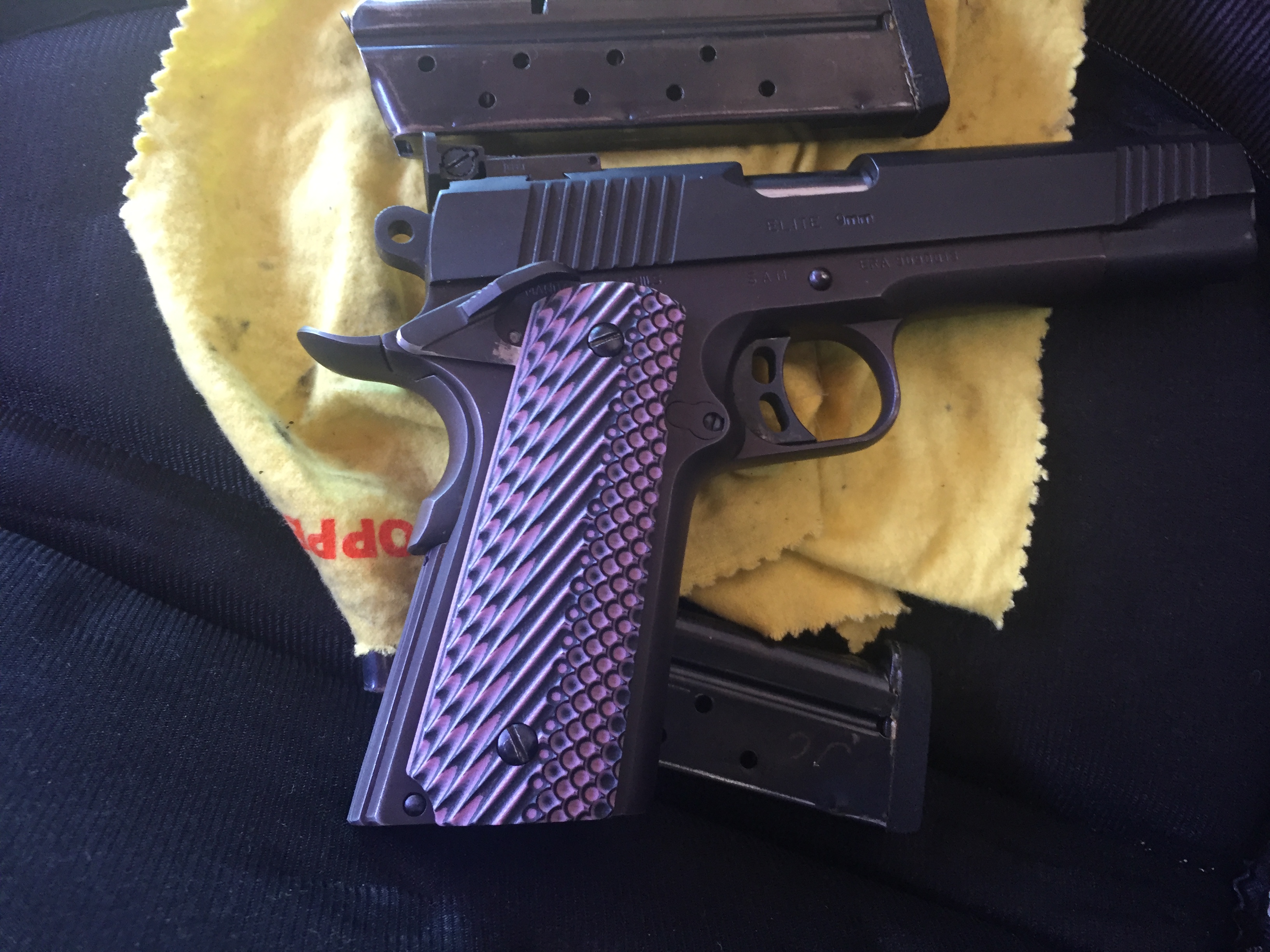

I went to the Terrey Hills Gun Shop this morning and picked up some new grips and went to install them. As with everything with a 1911 nothing is a straight swap and modifications are required.
The grips stopped the ambi safety from engaging so out comes the dremel and I remove about 1mm of material from the grip and still no joy. Not being able to remove anymore material from the grip I turned my attention to the ambi safety.
2mm of material had to be removed, however the safety engages and disengages with ease.
While I was there, the rear of the ambi safety overhung the frame and would cut into the webbing of my hand, so with dremel in hand I rounded off that part and cleaned it up with some 1000grit sandpaper.
Pretty happy with the result. Need to decide whether to get a bluing kit or remove bluing.
