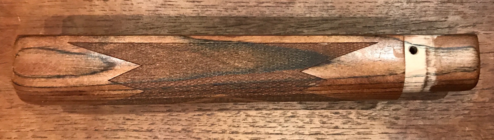

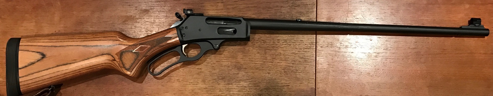

The road to accurizing my Marlin 336W
STEP 1 - Strip her down
So after disassembling the magazine and fore-grip, indeed the forend band was extremely tight around both the grip and barrel. I had difficulty getting it off. The front band was also very tight. Here is a photo of her fully stripped:
Just like the author did in this post: http://www.marlinowners.com/forum/336/5 ... 336-a.html, I'll test her naked to see how well she naturally shoots. This will give me a baseline accuracy to start with. I'll use my 9.0gns of Trail Boss under a 165gn hard-cast lead pill as these have proven to be accurate for me in the past, whilst being nice and mild (without generating any of that nasty heat). Trajectory is rather like a 22lr actually :thumbsup:
STEP 2 - Sand back that fore-grip
Actually I've already done this part; it's can't do any harm (besides aesthetic), and I'm hoping this is the main source of inaccuracy. Tight bands mean zero flex (equaling disrupted harmonics), worsened by a hot barrel. In a way we're floating the barrel somewhat inside the bands. Here is a photo of the sanded fore-grip:
Now the forend band slips on-and-off like a well lubricated, umm, you know what :P It just needs a bit of tung oil to get it back to matching the original stain. That can come later though - I'm really not fussed about looks right now.
STEP 3 - Test, document, add bits back. Test, document, add bits back etc
I'll incrementally add bits back on whilst gathering data about group sizes. Fingers crossed for some good results.
I'll post-back with the results once I get to the range.
TO BE CONTINUED...

looking at your picture compared to mine the barrel band is further up the stock on your gun mine is nearly right at the end I loosened the mag tube right at the end cause it was holding everything to tight tending to twist i thought
what I done was remove it clean used blue locktite and reinstalled to the position it was an backed it of .5 of a turn then let the locktite go off so when I grab the very end of the barrel and mag tube together I will feel rocking in the hand very slightly
pomemax
Posts: 1153
Re: Intrinsic accuracy of a "new" Marlin 336W
Post by in2anity » 10 Oct 2016, 12:23 pm
pomemax wrote:looking at your picture compared to mine the barrel band is further up the stock on your gun mine is nearly right at the end I loosened the mag tube right at the end cause it was holding everything to tight tending to twist i thought
Yeah sounds like a plan - I'll try this for the forend band. BTW what happened to your front band? Did you ever have it on? Do I even need to put mine back on?

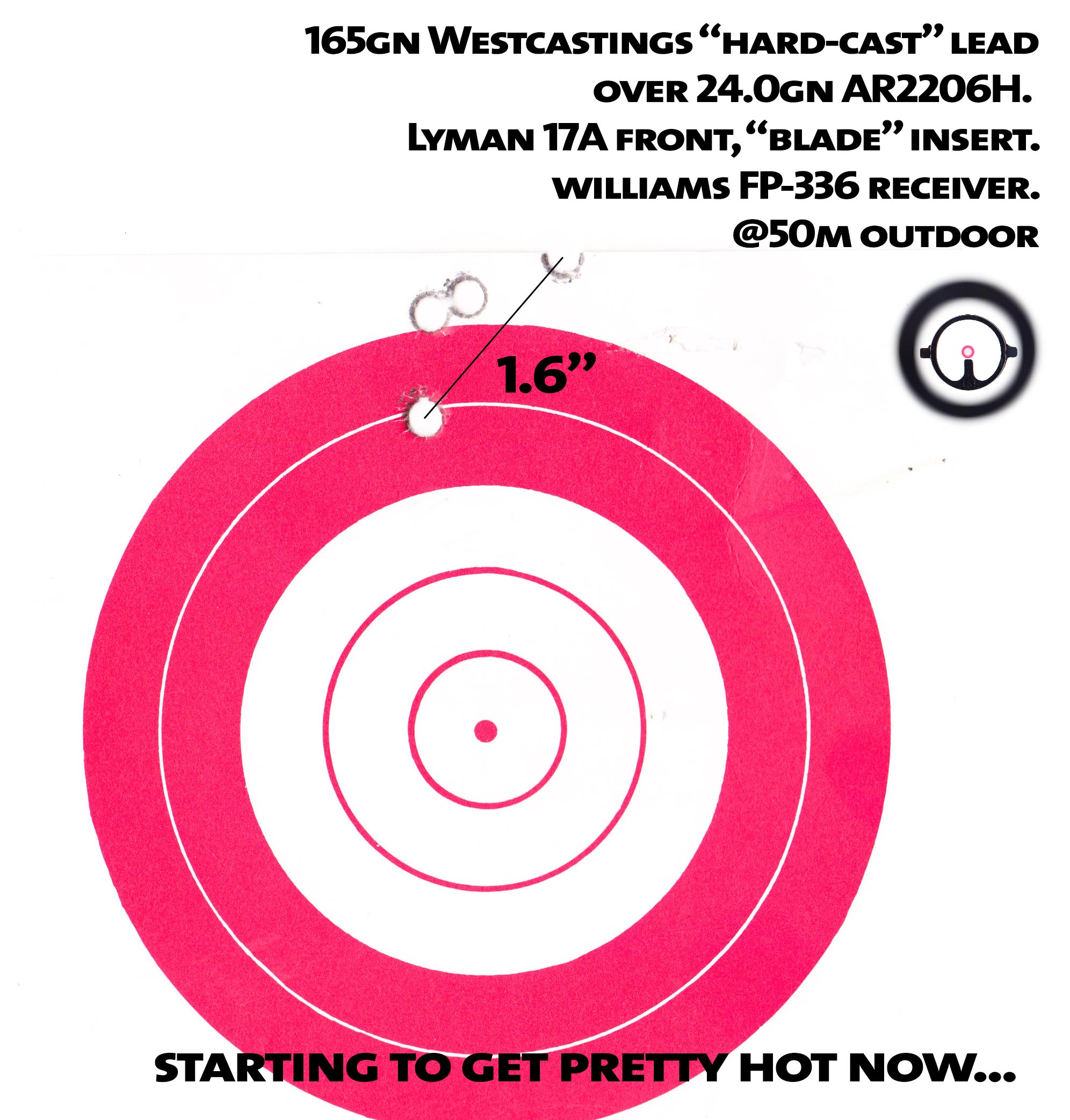

RANGE REPORT (ACCURAZING MY 336W)
Very disappointingly, I forgot to swap my front blade back to the target insert before heading off to the range. The difference between the realised (target) accuracy between these two sights is measurable, and all my previously data has been collected using the target insert. Take the following diagrams:
The "blade" is fantastic for hunting purposes (due to the maximised visibility), but it's not so great for precision target work. It works O-K when you have a square, highly contrasting target, but is particularly tricky to use with the red circular targets as currently provided by the SSAA at ANZAC range.
Here's what it looks with the target insert; obviously much easier to use in conjunction with the round targets. Very disappointing indeed that I forgot to bring it :(
Say la vie, I had to roll with the punches, so I'll report my findings anyway.
STEP 1 - NAKED
Nice and cool at this point, using my uber-pleasant Trail Boss loads. I could tell it really wanted to group:
This is just an example from a few samples. Whilst this is not sub 2moa, almost certainly it would have grouped under 2moa if I had the target insert or better yet, a scope. From how it felt, I feel completely naked it would have come close to 1moa.
STEP 2 - FOREND BACK ON
Another example from a few samples. Screws not super tight, and the forend was sanded back slightly to loosen the forend band (as talked about in my earlier post). Pretty similar accuracy, but rather interestingly the point-of-impact (POI) changed slightly down and to the right:
STEP 3 - FULLY REASSEMBLED
Magazine and front barrel band back on now, again paying attention not to over-tighten the screws. I took the whole "tight, then half a turn back" strategy. POI changed again, notably higher, but it's grouping just as tightly - YAY!
2206H HOT HUNTING LEAD LOADS
A side project is to also use my checkless lead projectiles as hunting loads - this was something I've failed at in the past using Topscore and Hawkesbury Rivers (as the lead was just too soft to push past 1400fps, a bit too slow to be ethical on deer). On the contrary, I was able to push the Westcastings projectiles up to ~1800fps whilst still maintaining stabilisation (without excessive fouling). At these velocities they're a rather stiff 800ft-lb of energy at 100m. They shoot practically flat enough to use at varying ranges inside 100m without much holdover. The rifle was getting pretty hot by this point (and I was rushing), so again, I'm confident they'd be much tighter in a cold clean barrel (with the target insert/scope):
These will be my go-to in the field, and I'll keep plinking with Trail Boss.
IN CONCLUSION
Whilst the results weren't consistently sub 2moa, I have no doubt that after the forend alterations my 336W is shooting measurably more accurately. As spoken about at the start of this post, it's quite difficult to shoot moa with a blade sight. I know from experience that the target insert will shrink my groups by 0.5moa - 1moa, so I am fairly confident in saying that my rifle should now shoot less than or equal to 2moa. Overall, a big success in my eyes!
If I get time, I shall post some more results using the target sights as proof - probably around mid November.
Post by Tripod » 17 Oct 2016, 7:34 am
How many shots in those first groups?"
Tripod
Posts: 265
Post by in2anity » 17 Oct 2016, 7:37 am
Tripod wrote:How many shots in those first groups?"
I went with three shot groups during reassembly. The hot 2206H experimentals at the end (after reassembly) were varying though, 4-5 shots (and shot a fair bit faster).
Post by Tripod » 17 Oct 2016, 8:06 am
In that case it looks like the projectiles weren't stable, Which is why you didn't get the accuracy you were after.

Yep... I can see the key-holing now that i'm on a bigger screen.
Post by in2anity » 17 Oct 2016, 8:52 am
Tripod wrote:
I don't agree with this. The projectiles actually are stable. It looks as if they aren't (because some of the holes aren't concentric), but relatively speaking, they are as accurate, if not more accurate than their semi-jacketed big brothers. Remember the word "stabilisation" is a relative term; at the end of the day, stabilization simply means accuracy. I've dealt with keyholing before and they're a very different ball-game (a very binary sort of a failure).
The reason I feel this way is because I've spoken to "swany" (the moderator over at http://www.marlinowners.com/ who is perhaps the world's most knowledgeable person when it comes to marlin rifles). His record-breaking marlin targets also show signs of non-concentricity for example: https://hoffos.files.wordpress.com/2014 ... target.jpg. These shapes seem to occur more with the fast burning powders such as Unique and Trail Boss, but it does not necessarily translate to poor accuracy.
Accuracy issues here are from me, not the rifle.

Consider this, what if they're all wobbling slightly in exactly the same way each shot; they just have slightly differing velocities, meaning the state of the projectile differs slightly when it impacts with the target (sometimes they are more straight). They are still "stabilised". Have you tried using powders at the fast end of the spectrum before (like Trail Boss, AP70N or AR2205) with checkless lead?
Post by in2anity » 17 Oct 2016, 10:16 am
Tripod wrote:I am a member on MO as well, I have many Marlins from .22 up to 50Cal, I shoot cast through them all and the only way my bullets make that shape hole is if the projectile is wobbling.
This is a relevant article:
" It turns out that coning motions are worse for long, slender, heavy bullets than for lighter and shorter bullets. The reason is that the long, heavy bullets have a large separation distance between the center of mass and center of pressure of the bullet. However, a bullet which undergoes coning motion, and even a little nodding motion at the beginning of its flight, is not unstable, that is, it will not tumble as it flies. The spinning motion of the bullet, which is caused by the rifling in the gun barrel, gyroscopically stabilizes the bullet in flight, although the stabilization is not perfect when the bullet cones. The cone angle is small always, and the nutation angle starts out very small and dies out very quickly."
http://www.exteriorballistics.com/ebexp ... 4th/46.cfm
Of course you are entitled to your onion, and we can certainly agree to disagree :drinks: There was a time where I would have agreed with your hypothesis, but I've been experimenting with lead for many years now and my views are based on my own evidence rather than speculation.

Post by Tripod » 17 Oct 2016, 1:44 pm
We will have to agree to disagree, The amount of coning they are talking about in that article is measured in thousandths of an inch and wouldn't be noticeable on the target, All I mean't by my original comment was to push them faster to stabilise them better or maybe go up another thou in bullet diameter which helps with the Microgroove rifling.
Tripod
Posts: 265
Post by in2anity » 17 Oct 2016, 3:02 pm
Tripod wrote:We will have to agree to disagree, The amount of coning they are talking about in that article is measured in thousandths of an inch and wouldn't be noticeable on the target, All I mean't by my original comment was to push them faster to stabilise them better or maybe go up another thou in bullet diameter which helps with the Microgroove rifling.
I get what you're saying. But if the (MAX) Trail Boss loads indeed consistently group to less than 2moa (which basically represents the upper capabilities of a 30-30), would you still consider the round to be "unstable"?
Post by in2anity » 17 Oct 2016, 5:43 pm
The effect we are discussing is often referred to as "yawing" see here: http://www.levergunscommunity.com/viewt ... =1&t=40746 and here http://www.levergunscommunity.com/viewt ... =1&t=49661 and is probably mainly due to imperfections in the bullets. Is this the same thing as keyholing? Nope. Does it mean inherent inaccuracy? not necessarily; there's a link, but not a correlation.
Post by in2anity » 18 Oct 2016, 7:03 am
What you say is true - pushing them faster reduces yaw. This is obvious if you look at my mid-burn targets - the good news and these are my hunting loads. There's not a whole lot I can do when it comes to my Trail Boss loads however - but I don't see this as an issue as they are only 50m plinking loads, and they are still quite accurate (irrespective of the yawing).
Post by Tripod » 18 Oct 2016, 7:27 am
Your 2206 load target doesn't show the instability that your Trailboss loads do which is why I suggested the load may be the problem.
I have been using Trailboss since it came out over 10 years ago and think it is an allright powder but not a great powder, It never gets the best groups but it shoots good enough to ring my gongs at 50 and 100 and like you say it is a great plinking load and a tub lasts for ages but it is also a dirty powder.
Are the Westcastings a coated type projectile or lubed? I don't shoot commercial cast projectiles.
Tripod
Posts: 265
Post by in2anity » 18 Oct 2016, 7:42 am
Tripod wrote:Your 2206 load target doesn't show the instability that your Trailboss loads do which is why I suggested the load may be the problem.
They are the "Black Premiums" which are a dry bonded polymer-like coating (not exactly sure, as they are pretty secretive). They are sized to .310" I haven't tried .311"s with Trail Boss - they might be a little a little more stable. Do you normally use 2207 under lead?
