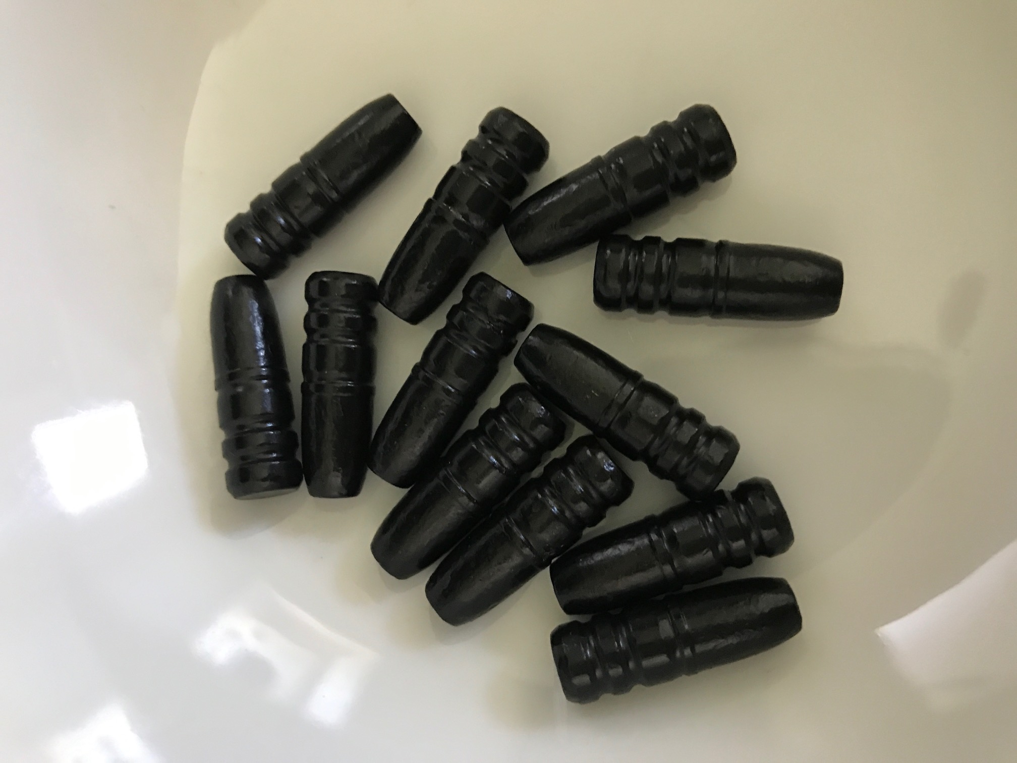

So a bit of an update on my progress with accurizing my 336W in conjunction with commercial coated hard-cast projectiles. My current batch of projectiles are Westcastings "Black Premiums", which have a BHN of around 16bh. I have about 600 of these left so I need to make them work (hence the motivation).

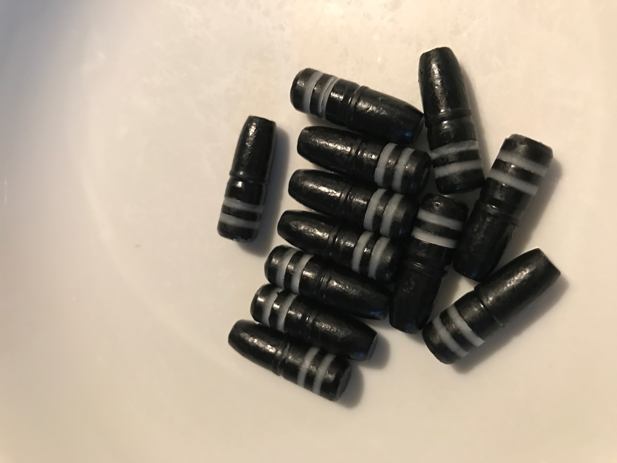

As suggested by Noisydad, I experimented with lubing these (already coated) projectiles; I pan lubed using his formula of:
1 part paraffin wax (candle wax)
1 part pure lard
1/2 part beeswax
Before:
After:
Finished:

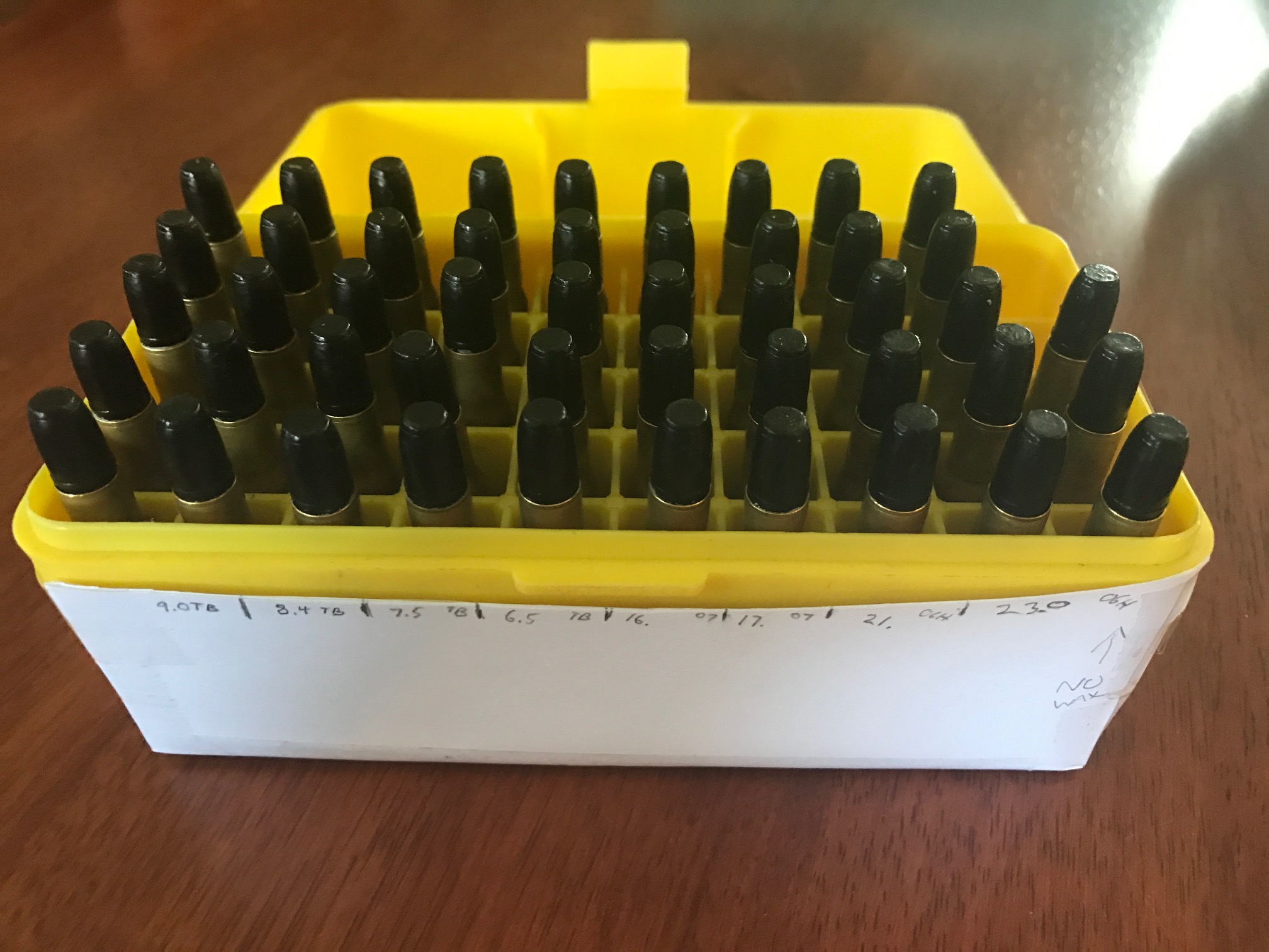

I tried three different powders and went back and revisited 2207 (as suggested) and 2206H. The results were mixed.
Trail Boss

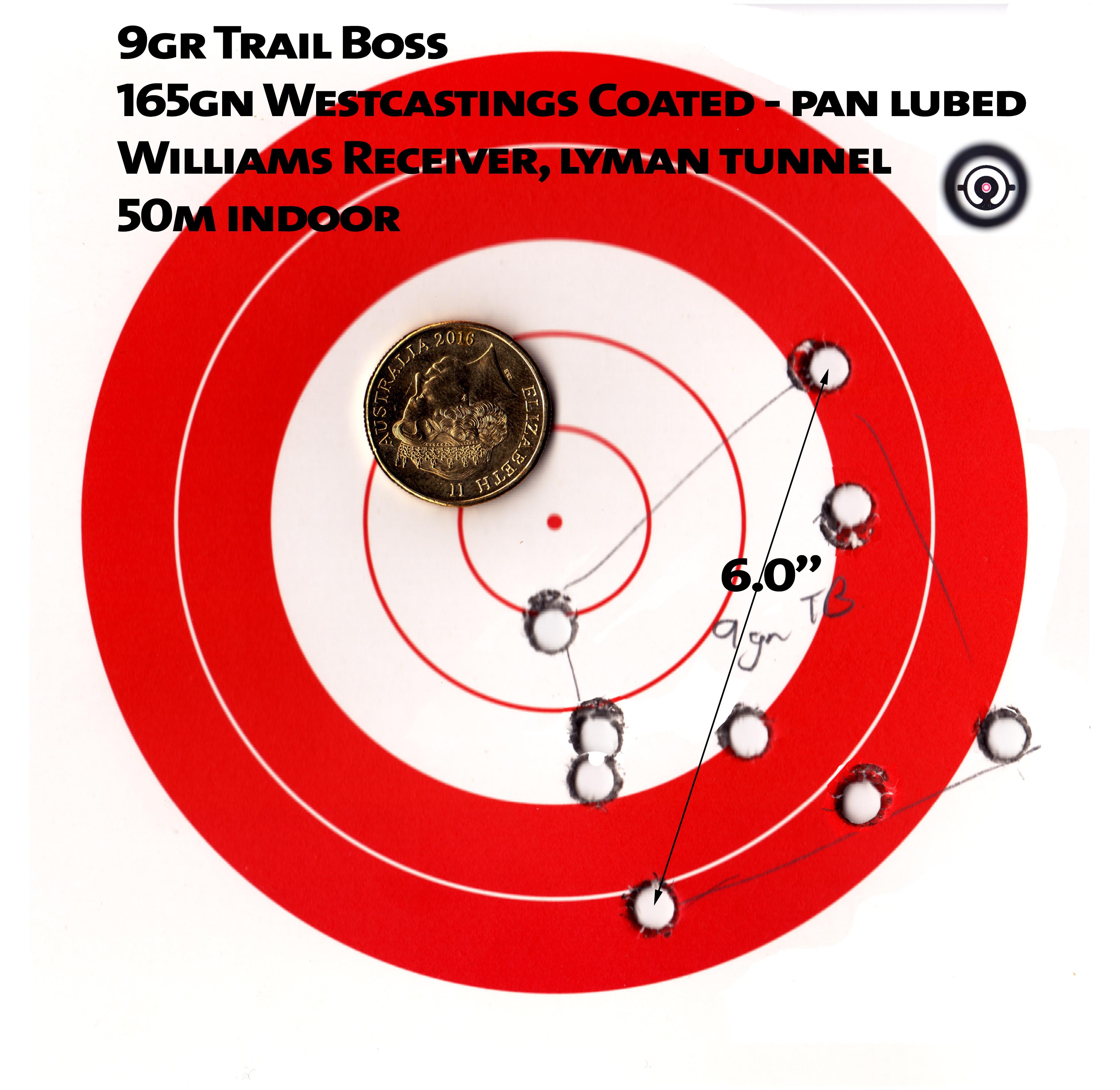

The long and short of it, Westcastings "Black Premiums" don't gel with Trail Boss. Max 9.0gr Trail Boss gives me an average of 6-12moa; my rifle certainly does not like this load:

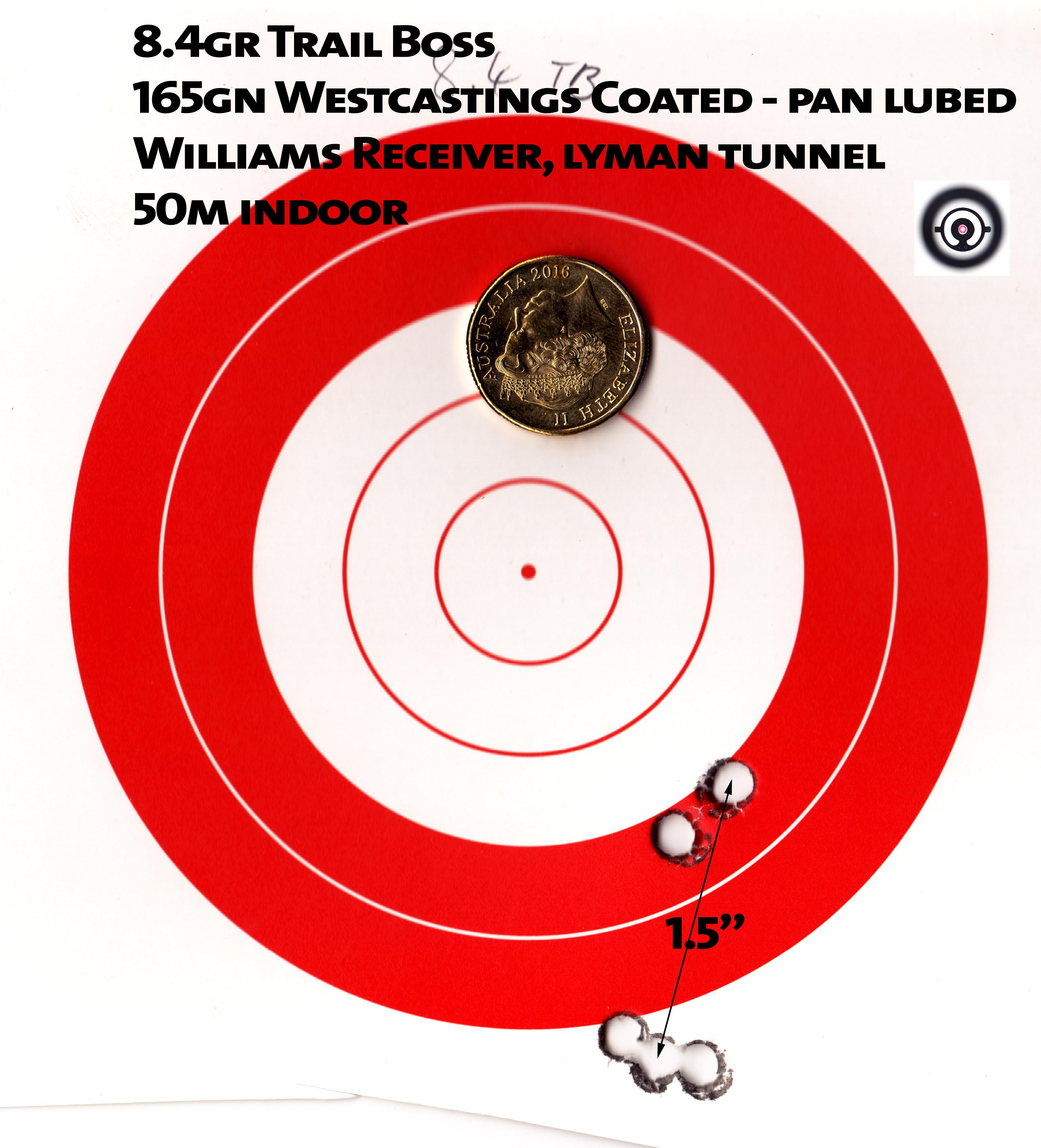

8.4gr of Trail Boss is a little better (at around 3-4moa), but still far from averaging <=2moa (my end-goal):
There is still evidence of destabilization on these Trail Boss targets - something I was really hoping to eliminate with lubing. This probably explains the sub-par accuracy.
Actually, I'm convinced my rifle favours 8.4gr Trail Boss regardless of the projectile manufacturer. Hawkesberry River and Topscore both also like 8.4gr Trail Boss; they grouped at around 2.5 - 3.0moa with this load. Still not great by any stretch, but that'll have to do, I do not want to waste my 1.5kg bottle.
