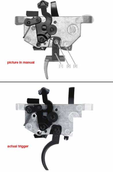

I'm looking for some help on removing the trigger creep on a new anschutz 1416D. There is quite a lot before it fires.
I have the manual for the '1400 series' which came with the rifle and it says this
2.2 Adjusting the optimum sear engagement on a single stage trigger by means of the sear engagement adjusting screw [2]:
> Cock the trigger
> Turn sear engagement adjusting screw [2] (second stage) clockwise until the trigger releases.
> From this setting, turn sear engagement adjusting screw [2] approx. 1/3 turn anti-clockwise.
The problem is the trigger pictured in the manual is not the one in the rifle. Picture attached below.
anschutz triggers
Like you can see, the housing is a little different and instead of a flat head screw in place [2] like the manual says there is a small Allan key instead.
Can anyone familiar with Anschutz confirm for me that this allan key should be the same? Or if it's different.
I don't want to just start screwing in or out without knowing, or just "give it a go" and stuff something up.
Thanks guys.

Post by Lorgar » 01 Jan 2014, 11:20 am
G'day,
Yep, I recently got the 1416D HB. Same action is the regular 1416 but just heavy barrel and beavertail stock.
Same trigger as your bottom picture as far as I can see.
Mine had quite a bit of creep too and I had the same "1400 series" manual which wasn't much help.
The trigger creep was taken out by turning the Alan Key socket on the trigger where the flat head screw is pictured though.
As I wasn't 100% sure when I started, I just turned the Alan Key a 1/4 clockwise then fired into a spent brass casing to feel if the creep was reducing. It took about a full turn to take it to where I was comfortable with it.
Should be the same for yours' just go carefully obviously.
After you've done your adjustments be sure to test the trigger thoroughly and work the bolt open and close, back and forth aggressively to make sure it won't accidentally discharge if knocked or if the bolt is closed quickly.

Post by 438 » 10 Jan 2016, 9:55 pm
My rifle is an Anschutz 1403. It has a 2 stage trigger. There are 3 screws on mine. I have adjusted 2 of them.The screw on the side adjusts the creep. In my case the travel to the second stage. The screw reached from the bottom adjusts the weight of the trigger pull. The 1400 series are sporting class rifles, They don't adjust down much below 1 lb. At least mine doesn't.
I am told that the match class, say 1700 series rifle triggers will fit the 1400 action. The trigger pull on these is set in ounces or even grams. The 4 I have fired discharge just as soon as you touch the trigger,called a hair trigger.

Post by Woofgear » 28 Dec 2016, 10:20 pm
Sorry for this green question..... I have the same issue; here's the question.... Do you have to remove the trigger from the stock to make these adjustments? I'm sure the answer is yes p, but wanted to make sure
Be kind to my mistakes, Cheers, Mark
Woofgear
Posts: 2
Re: Removing trigger creep on Anschutz 1416 (manual isn't ri
Post by Lorgar » 29 Dec 2016, 1:50 pm
I'm assuming you mean remove the action from the stock... yes, that's correct. (You don't remove the trigger.)
It's been a while since I adjusted mine but from memory you can adjust the trigger weight via the bottom screw while the action is mounted, but to adjust/remove the creep you will need to remove the action from the stock to access the hex screw on the side of the trigger.
My gun are at the dealer for storage while I'm away for the holidays, will check for you in a week when I'm back in town and pick them up.
