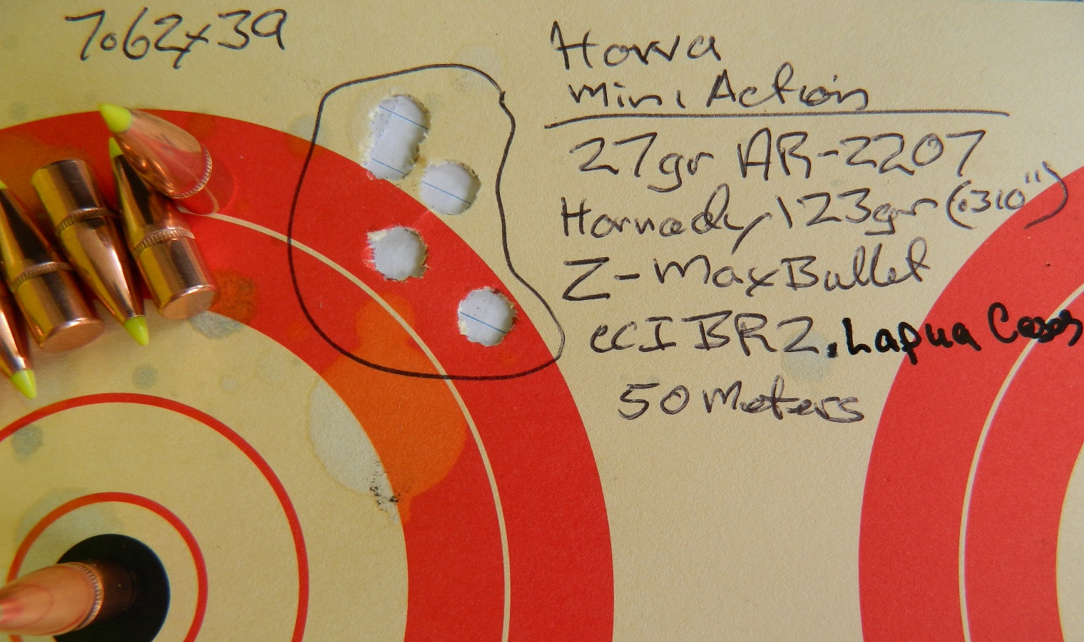

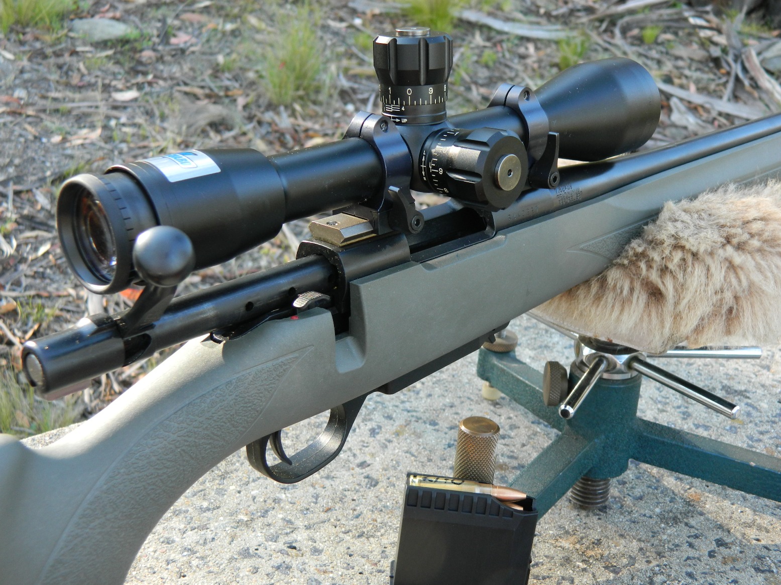

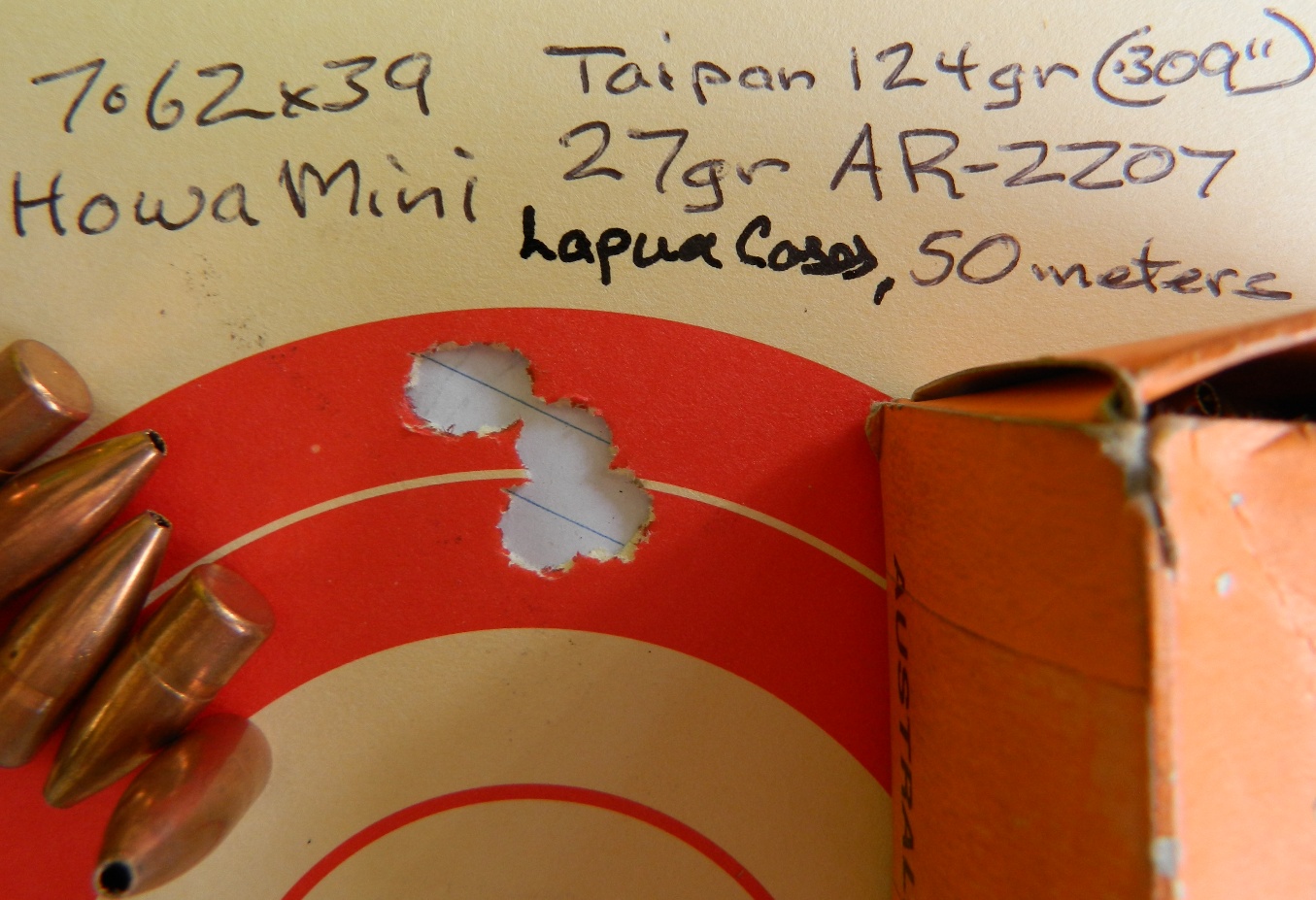

G'Day Fella's,
Finally got a scope on this little rifle.
and shot some (50 meter) groups.
I think the Howa Mini is a keeper and Homer is a Happy Lad!
Doh!
Homer

Re: Something a bit smaller for a change...
Post by bladeracer » 09 Jan 2017, 8:32 pm
I just noticed :-)
Go back to photos in the first post and note the bullet diameters Homer is using - .309" and .310".
Post by in2anity » 09 Jan 2017, 8:57 pm
bladeracer wrote:I just noticed :-)
Well damn it can handle the 309! I wonder what the official diameter of that barrel is!
