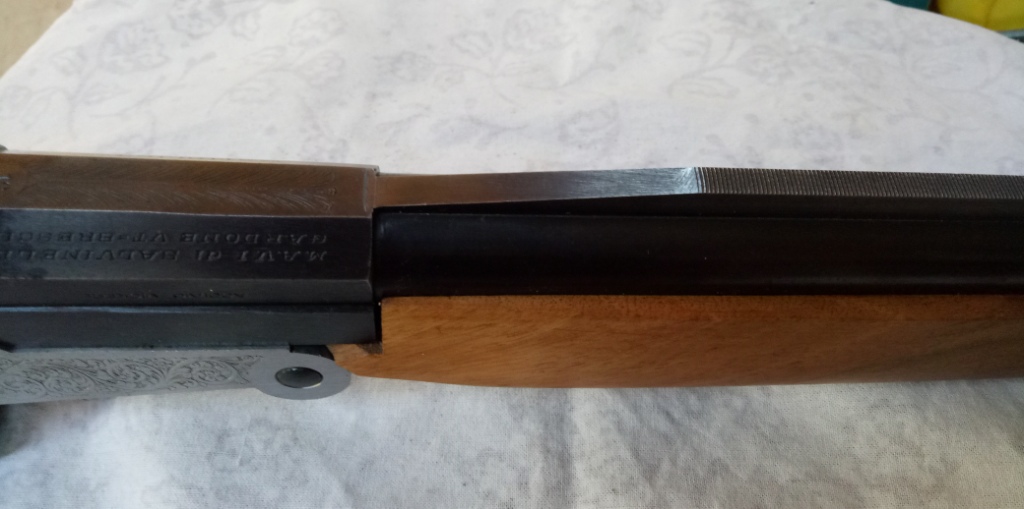

So, I have a 12 Sterling SB I'm thinking of fitting a reflex sight as my eyes are not improving. It will also allow me to use solids on deer in Vic if I wish. So How do you mount them? Is there an easy and cost effective way of doing this?
Image of chamber end of barrel rib below.

Is the rib 10-11mm wide?
If it is you should be able to use dovetail scope bases.
These fit my Stoeger Condor rib.
http://www.ebay.com.au/itm/2pcs-Picatinny-W-3-8-11mm-Dovetail-to-7-8-20mm-Weaver-Rail-Scope-Mount-OZ-/132025800613
I'm also using rifle sights:
http://www.ebay.com.au/itm/Truglo-Magnum-Gobble-Dot-Sight-Set-for-3-8-Vent-Rib-TG941XB-/361597170925

Yes, thats what I'm looking for. But my rib is 6mm. And the reflex needs to be a fair way along the barrel.
