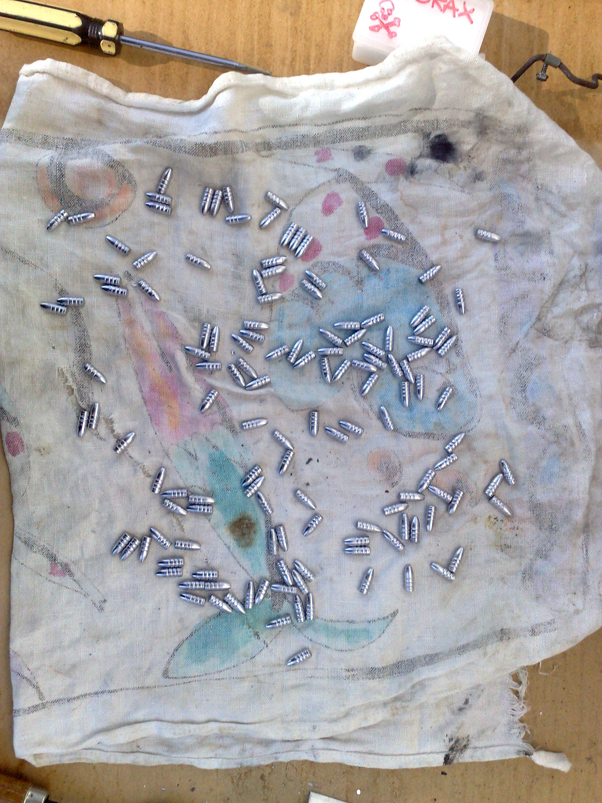

Even cheaper - 137 .243 bullets from $7 worth of lead shot :-)

Or you can cast your own from lead shot for around $10 a kg, or 110 140gn bullets- about 7c a piece.
