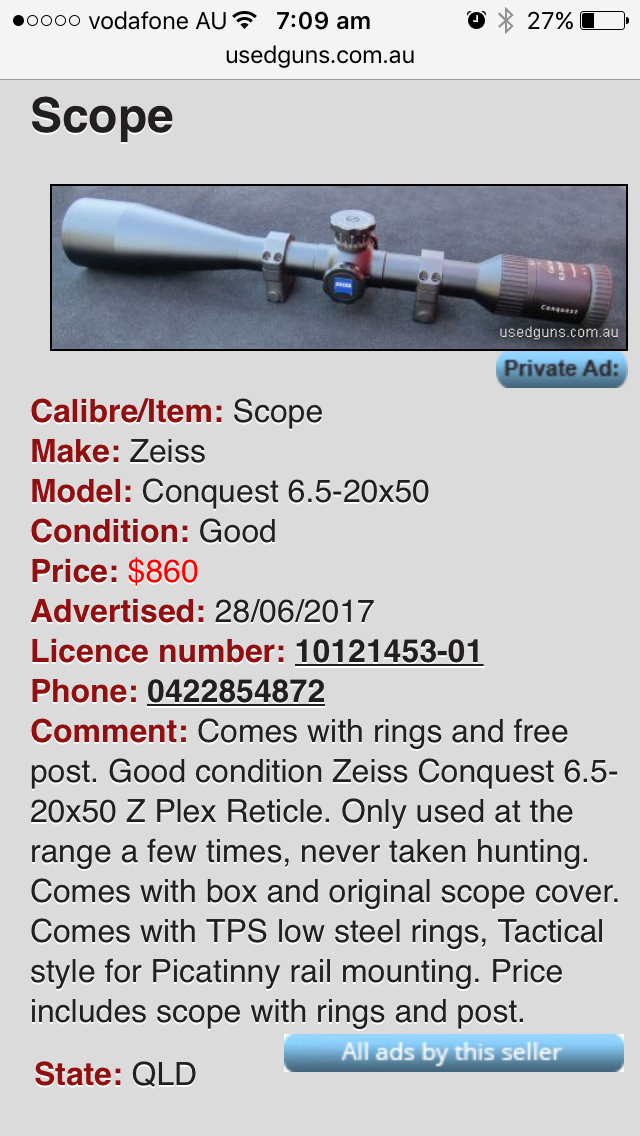

Post by Yipikaye » 26 Jun 2017, 5:49 pm

Re: Best scope $800-1000
Post by bladeracer » 26 Jun 2017, 6:12 pm
Yipikaye wrote:These are available at my local dealer.
https://www.usedguns.com.au/Product.aspx?p=91483
https://www.usedguns.com.au/Product.aspx?p=84099
What do you think?
The second one is First Focal Plane, might want to skip that one.
Post by Yipikaye » 26 Jun 2017, 6:14 pm
Oh i didn't notice that! Thank you :)
