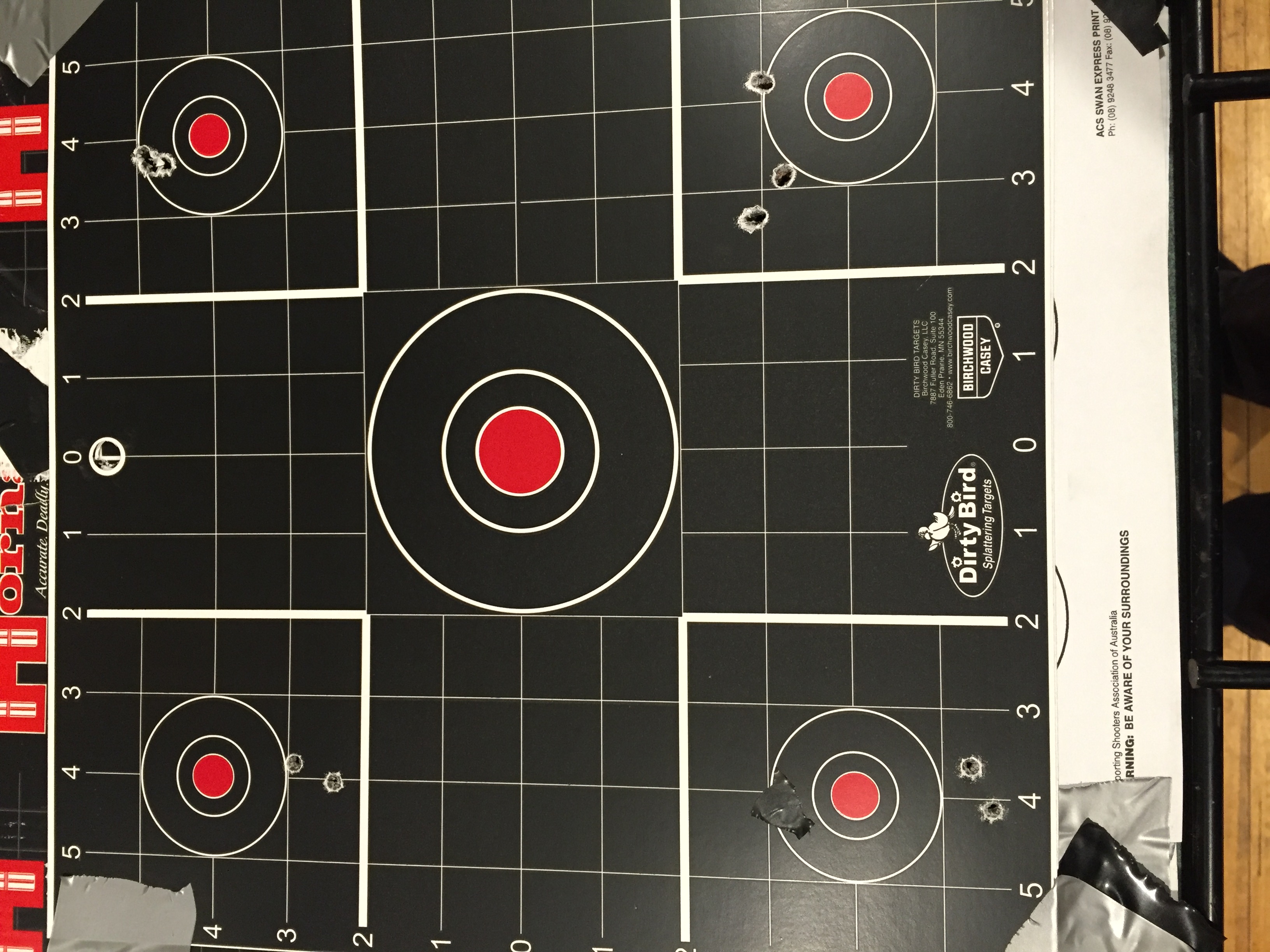

Well I'm glad I only loaded up 3 varmint gernades. Started at 27.7gr benchmark as per ADI manual. Bottom right target is Varmint gernades. Two left targets 32 Zmax with Trailboss and top right it my 32gr Zmax load with 27.3gr 8208.
I also tried varmint gernades with Trailboss. Couldn't hit the target at 100metres. Pretty clear the varmint gernades have a stability problem in my rifle. You can see if you look closely at bottom right target.
