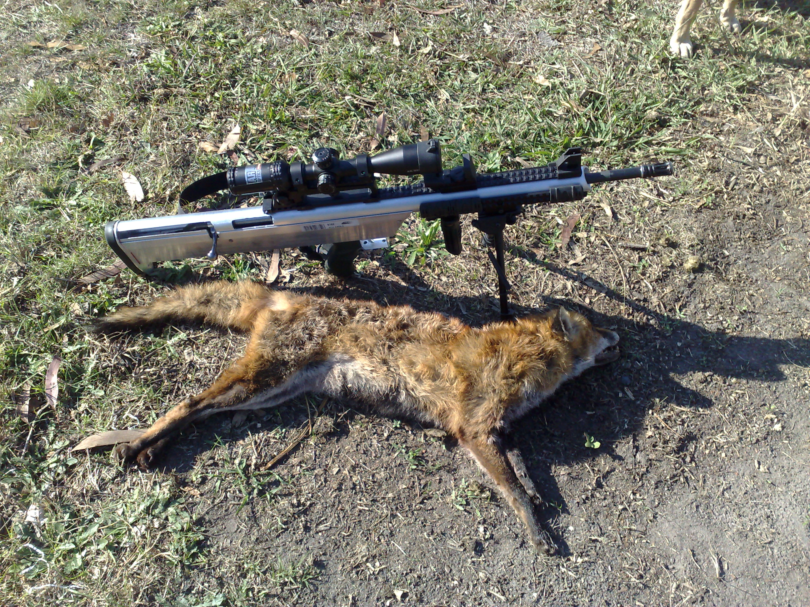

On my bullpup chassis I have a full-length tube from buttpad to front sight so I just put a pic rail on the top, bottom and both sides. The scope is no problem at all. This setup accepts all short action Ruger American Rifle/Compact/Ranch actions.

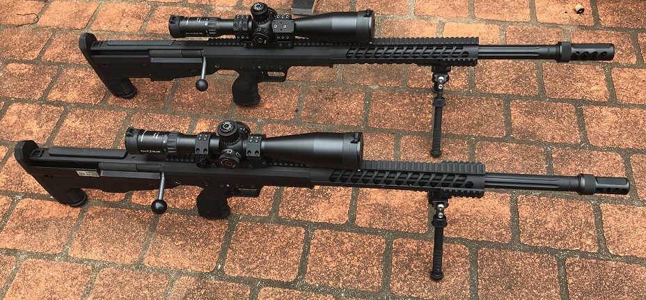

Bladeracer nailed the explanation perfectly and any BP conversion should have a rail long enough to obtain proper eye relief.
I'm a big fan of the bullpup design because I still get a full length barrel with a shorter overall length. Below is a pic of the "Flinchmaster" and its twin in .375 Cheytac. Not exactly light but still very compact.
