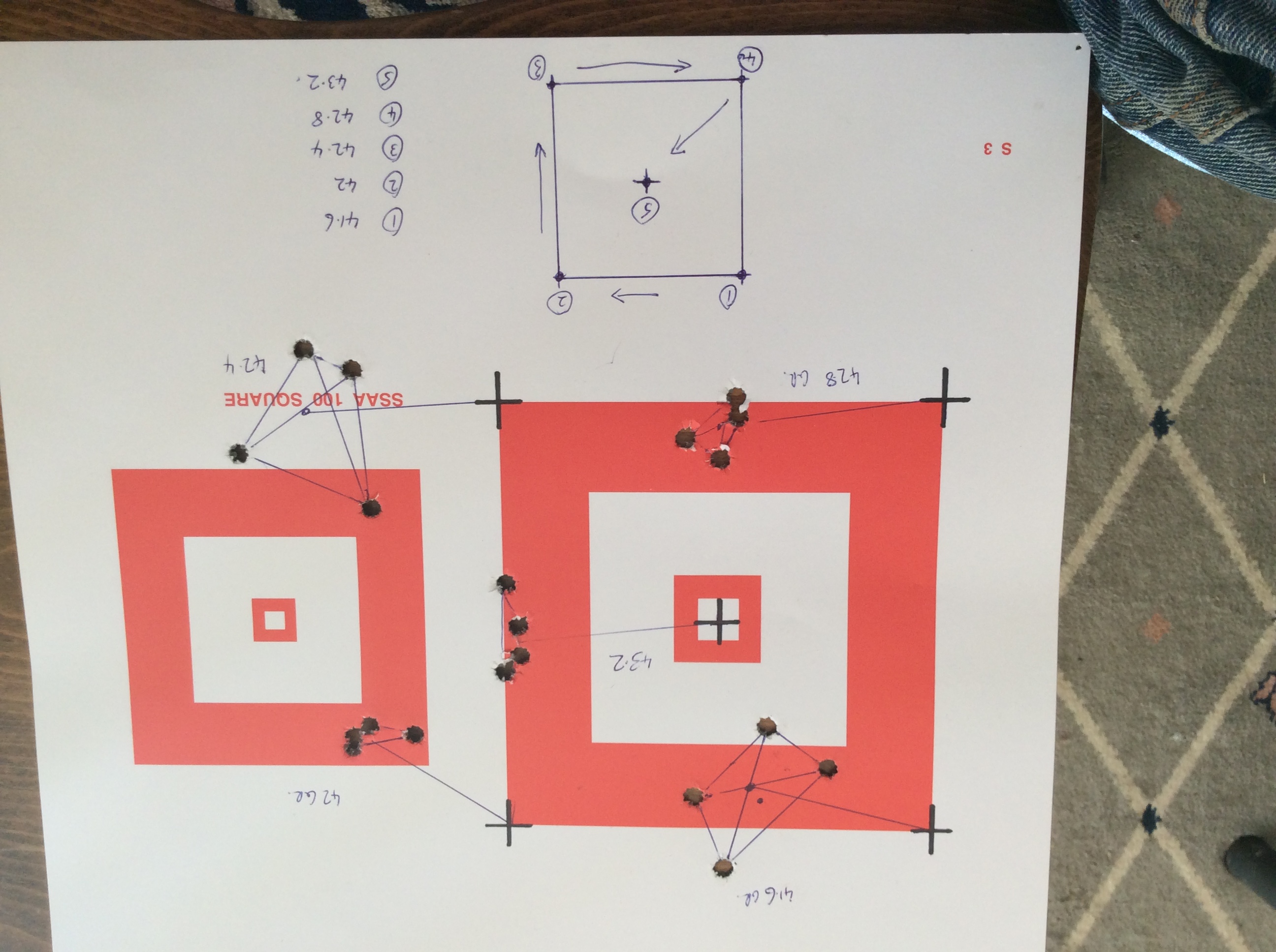

Hi guys I have been load developing and have come across an unusual situation with a group. The attached picture says it all. Details as follows.....
. Ruger M77 tang safety in 243 win
Testing at 100m, minimum of two minutes between each shot.
Once fired brass, neck sized only, federal large rifle primer, seated 10-20 thou off the lands. Ar 2209 powder
87 gr hornady Bthp
The round robin test shot off the bench started at 41.6 with a clean bore. The larger grouping here testifies probably to the clean bore which at around 2 Moa is poor. The second group at 42 gr has 3 rounds all touching with one flyer 1 Moa to the left. 42.4 gr shows the group going back out to 2 Moa. 42.8 gr the group is back to 1 Moa. 43.2 gr group shows plenty of vertical stringing. The max reccommended charge is 43.5 gr from ADI manual.
From the results I guess next testing should trial around 42 gr.mark. What I am perplexed is why is the 42 gr. load is grouping LOW in comparison to the 41.6 group ? Is it just the nature of a clean bore in this particular rifle this is happening?
Thanks for any feedback and advice

Wind/mirage conditions changing? Taking 2 minutes or more between shots means that your testing was over an extended time frame. Plenty of time for conditions to vary from group to group. Benchrest shooters shoot a "condition", when wind/mirage is the same as the sighters they were happy with. I've watched Stuart Elliot, ( one of our best shooters ), fire his scoring shots off as fast as he could. I asked him why and his reply was, " I liked that condition".
When trying to shoot groups you really have to be honest with yourself, "was that a good shot" is something you have to always think about.
Also, one apparent "good" group is not a true indication of accuracy. Load a bunch of cases up with that load and go and fire at least a half a dozen 5 shot strings. If it holds up, then you have a "true" indication of how it shoots. More over, the average of those groups is a better indication of how accurate it is.

FWIW, you have a great group with 42gn. No vertical stringing to speak of in the context of a hunting rifle anyway. Barrel harmonics put the group where it is. Simply adjust the sight to where you want the zero and go from there :thumbsup:

the reason your 42 gr group is lower is the load is clocking, just a different harmonic release of the bullet
do I understand that you are shooting groups at each load or shooting 1 shot of each load round robin like in ocw
I would only be shooting 3 shots at a time then letting the barrel cool down completely, maybe 15-20 minutes depending on weather while doing the test
the 42 gr group looks like you may have pulled the trigger to the side, depending on how fast it is going it would be the one to look at

Horizontal spread is ok, normally wind etc. Vertical is bad. Go 42 as it has least vertical

I like that 42.4 and 42.8 have little elevation change, could be worth looking for best accuracy in that zone.

Thank you all for your feedback it is appreciated. Yes this was a round robin ocw test. ....... first shot 41.6 top left square. 2nd shot 42 gr top right. 3rd shot 42.4 gr bottom right. 4th shot 42.8 gr bottom left. 5th shot 43.2 gr centre square. Clean bore, then repeat a further 3 times.
I will do further tests including 4 consecutive shots for each powder load. It is interesting that the harmonic sweet spot (42 gr) POI is lower on the target. Being a simple factory ruger hunting rifle I would be happy with 3 rounds touching at 100m

Hmmm...I think it was a mistake cleaning the bore for every shot in the one group. I wouldn't have cleaned the bore at all. Shoot some foulers first to warm the barrel up then shoot the test batch with just a few seconds between each shot to allow some air through the bore. You need the rifle to be as much the same as possible for every round. You don't want the barrel to get overly hot, but consistently warm.

yes that would be a mistake to clean while testing as you are trying to gauge the performance as the barrel gets some fouling so as to see what it will be doing while fouling and usually 3 shots at a time will put heat into the barrel but not any more than you will encounter hunting, you also get more of a round robin as you don't start and finish at the same load eg: 3-6-9-12-15 if you have 5 test loads x 3, I usually do 5 shots in the mid range for the test first to put some fouling in and to sight for centre bull.
when doing the testing this way I have found the 20 shots are easily done in around 2-2.5 hours and I'm finished by 9am before any wind or heat comes, either the recipe works or it doesn't, I have found that further testing to try and squeeze every bit of accuracy out of the load is normally not worth it,
if its not good enough big changes such as bullet and try again

Technically that is a precise rifle but you don't have it set up accurately because all three rounds missed the bullseye. :thumbsup: :drinks:
Re: Unusual grouping, round robin test.
Post by Gwion » 09 Sep 2017, 7:57 am
Re: testing statistical precision of a particular rifle, you get much better data firing 10x 5round groups and seperate target than you will firing all 50 rounds at one target. You'll get an even better statistical indication of true group size (precision) by firing one shot at those 10 target sequentially, five times (round robin style so you still end up with 5 round groups but with 10 rounds between each shot in each group). You then analyse the groups and average out, then you'll have a pretty accurate indication of what you and you rifle are capable of, precision wise.
I will try to find the paper again but the US military found that there was no statistical advantage in firing 10 shots in a group as 5 shot groups returned the same results as 10 shot groups, however there is a statistical advantage in firing more of those 5 shot groups, as in the example above, ie: 10x5shot rather than 5x10shots to give a true indication of a guns precision and zero for the purposes of finding that guns zero or sighting for a given range/distance.
