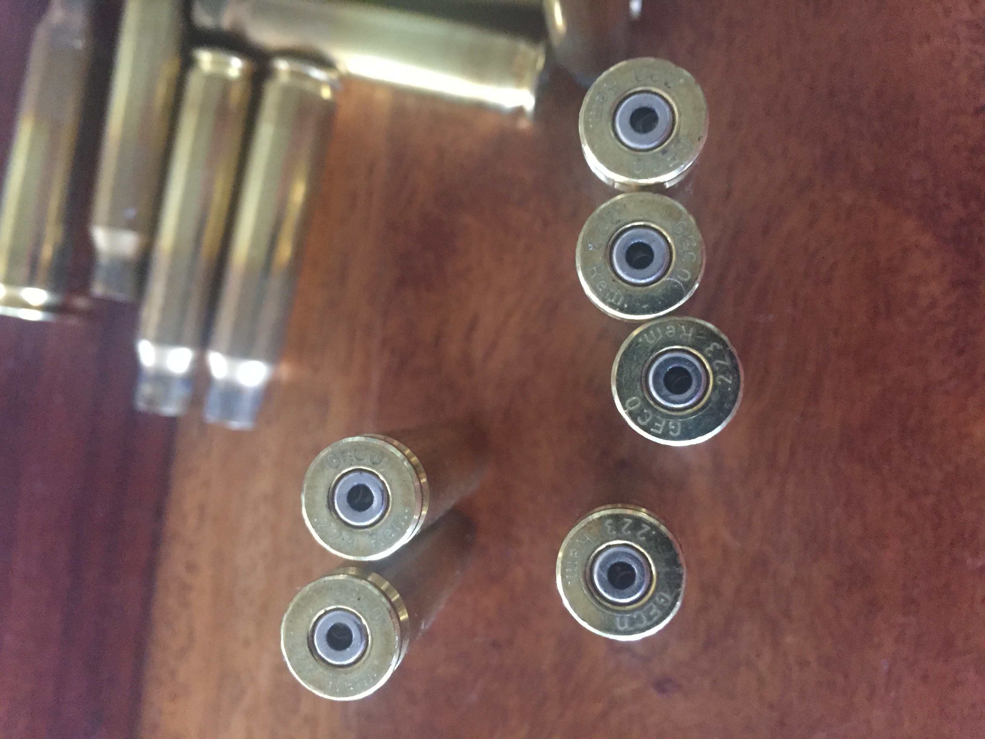

Post by Milesy » 08 Oct 2017, 4:05 pm
Hi All
At the range yesterday when RO pointed out excessive smoke emitted from breach after I fired.
Turns out the primer was being pieced by the pin.
All new to me but was only happening with the Geco 223 Rem recently picked up.
He suggested stop using asap.
Bugger have got 200 rounds.
Anyone seen this before?
Cheers Milesy

Don't use them. Way too hot for your rifle. Return them to where you bought them. That's assuming other ammo is OK.
If that is a drama for you dismantle them if you can and drop about 2 or 3 grains and try a group.

I would get a friend to fire a few through his rifle and if there aren't any problems, get a REAL gunsmith to check out your rifle. If he can't find anything strange with it, either take them back or swap them to your friend.
If they don't work in the friend's rifle either, take them back post haste.

sungazer wrote:It could be a firing pin issue. It could be overly soft primers. The round could be too hot. Given that it is factory ammo. I would be looking very closely at the rifle first.
I would tend to agree how many did you fire that penetrated the primer ?
When did you last clean the chamber ?
other ammo IS ok at the moment , if not I would strip the bolt .
If you do not know how to strip the bolt take it to a gunsmith looks like the retaining pin may have broke and letting the pin to far forward https://www.youtube.com/watch?v=o6evHnnnVw4
