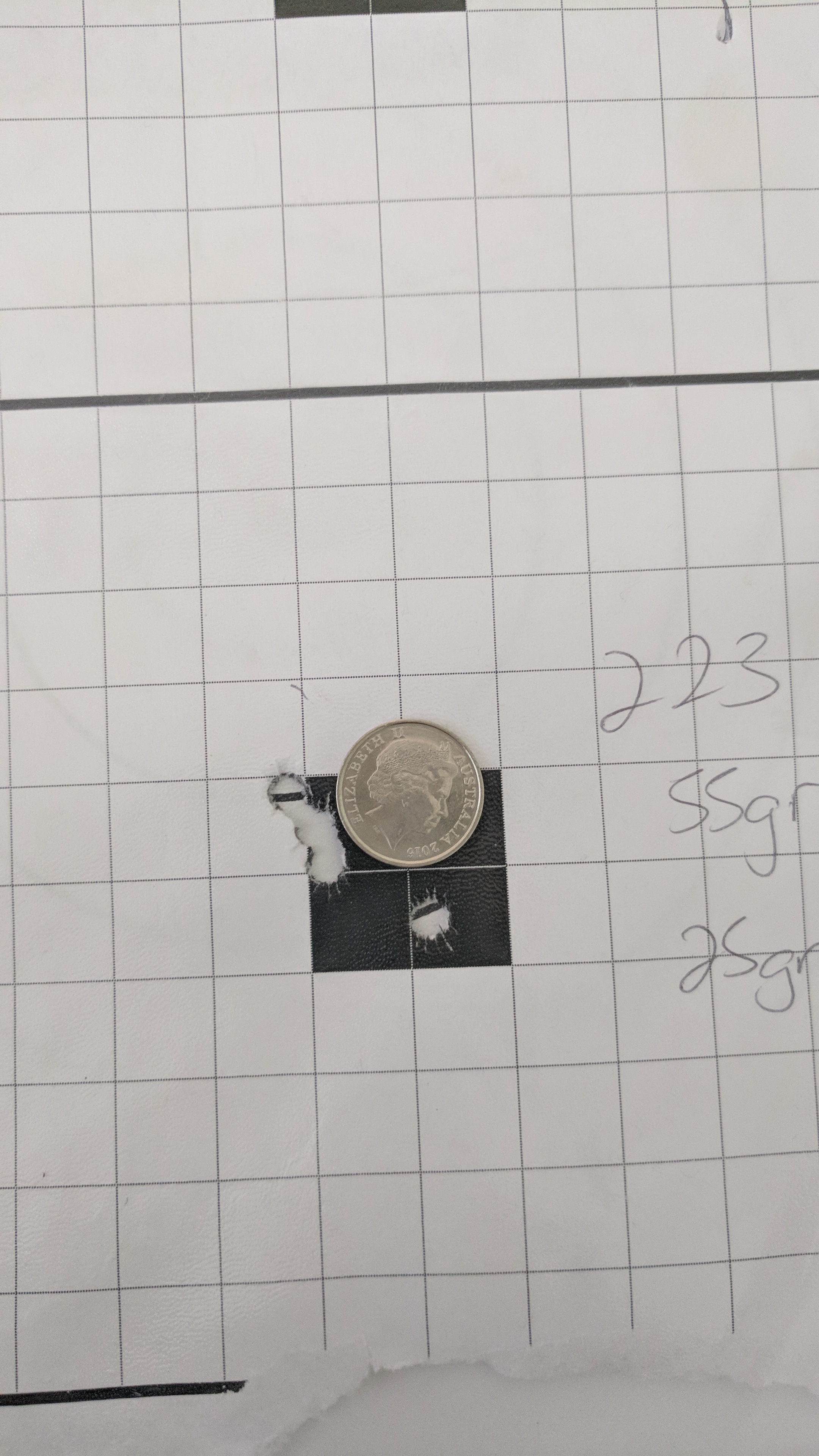

re the 223 group
What happened to the lone shot, in the black, at about 5 o'clock to the coin?
Posts: 1816

Wm.Traynor wrote:re the 223 group
That's my fault, squeezed trigger at the top of my breathing. I knew I've stuffed that shot just as I pulled the trigger.

Post by Wm.Traynor » 13 Nov 2017, 2:24 pm
Thanks for clearing that up mate. in view of that, it could be that your "grouping problem" is more complicated than it appears at first glance and is comprised of two things:-
1) a crook rifle, for instance the loose screws
2) shooting technique: the lone shot above.
If you own a rimfire, practice your follow through. This skill degrades with each shot fired (sorry) and you have to be conscious of it before every shot. Recoil will spoil it; for instance you fired a crook shot with the mild 223 after the unsatisfactory 308 session. My guess is that a poor shooting habit followed you to the 223. that happens. It's some kind of memory thing. If you don't have a rimfire, try dry firing. Maybe get snap caps but always remember to follow through. You have to make a conscious effort :) :thumbsup:
Posts: 1816

Wm.Traynor wrote:
The 223 group was done after the 308, I think I understand what you mean by bad habits. I must be more conscious of my shooting posture. I find that when I shoot 223 my eyes are able to remain open, but 308 is harder to do that. In saying that, when I shoot factory, I get 0.5moa consistently. So I don't know if it's me or my reloads, hence the confusion.
