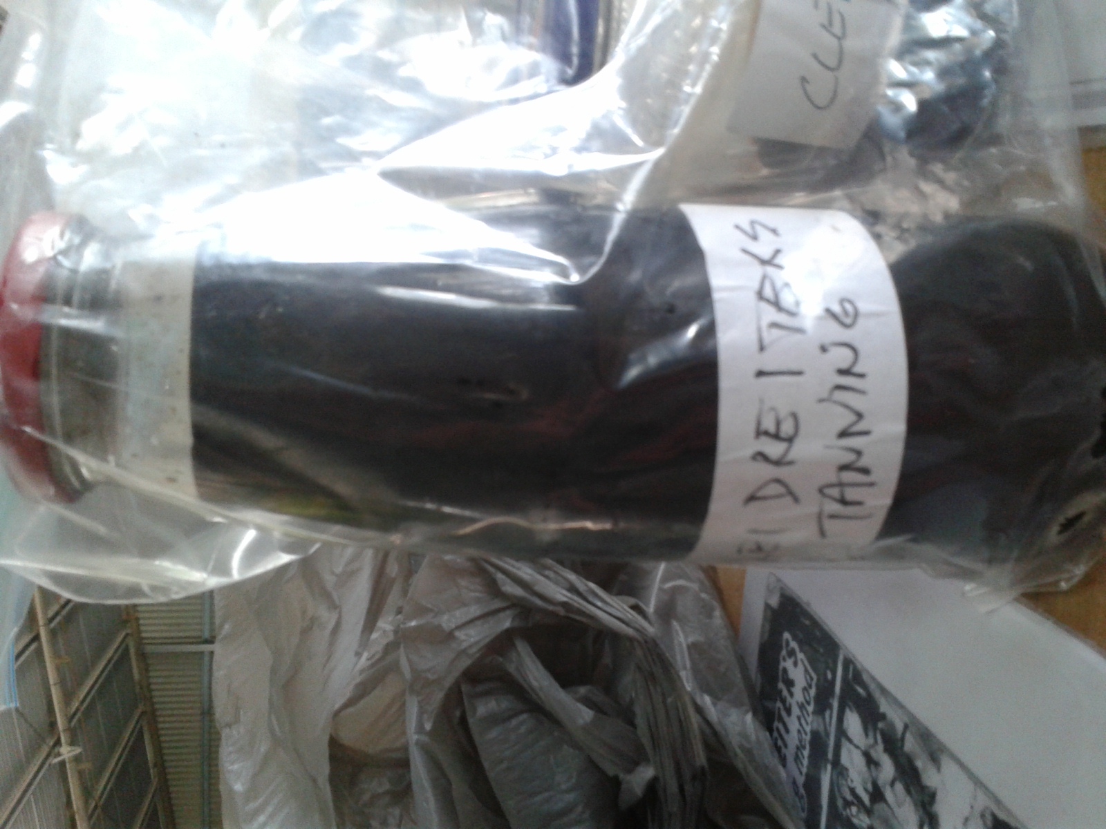

As some may remember a couple of months ago I had a little kid goat walk out of the bush that we ended up keeping. Last weekend it made the mistake of waking the missus up at two in the morning so that night we had kid for dinner!!! Anyway we fleshed and salted the hide and one of the ladies that works for my wife gave us some
Leidreiters tanning solution. Has anyone else used this? any tips or advice is appreciated!!

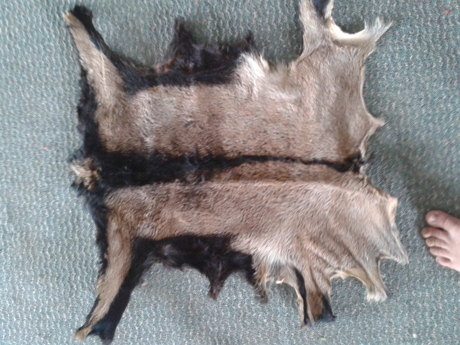

Post by Daddybang » 30 Nov 2017, 8:08 am
First attempt has come out good.. no slip so just got to trim it!! :thumbsup: thanks for all the advice :drinks:
Re: Tanning skins
Post by marksman » 30 Nov 2017, 9:30 am
really nice skin, good job daddybang :drinks:
