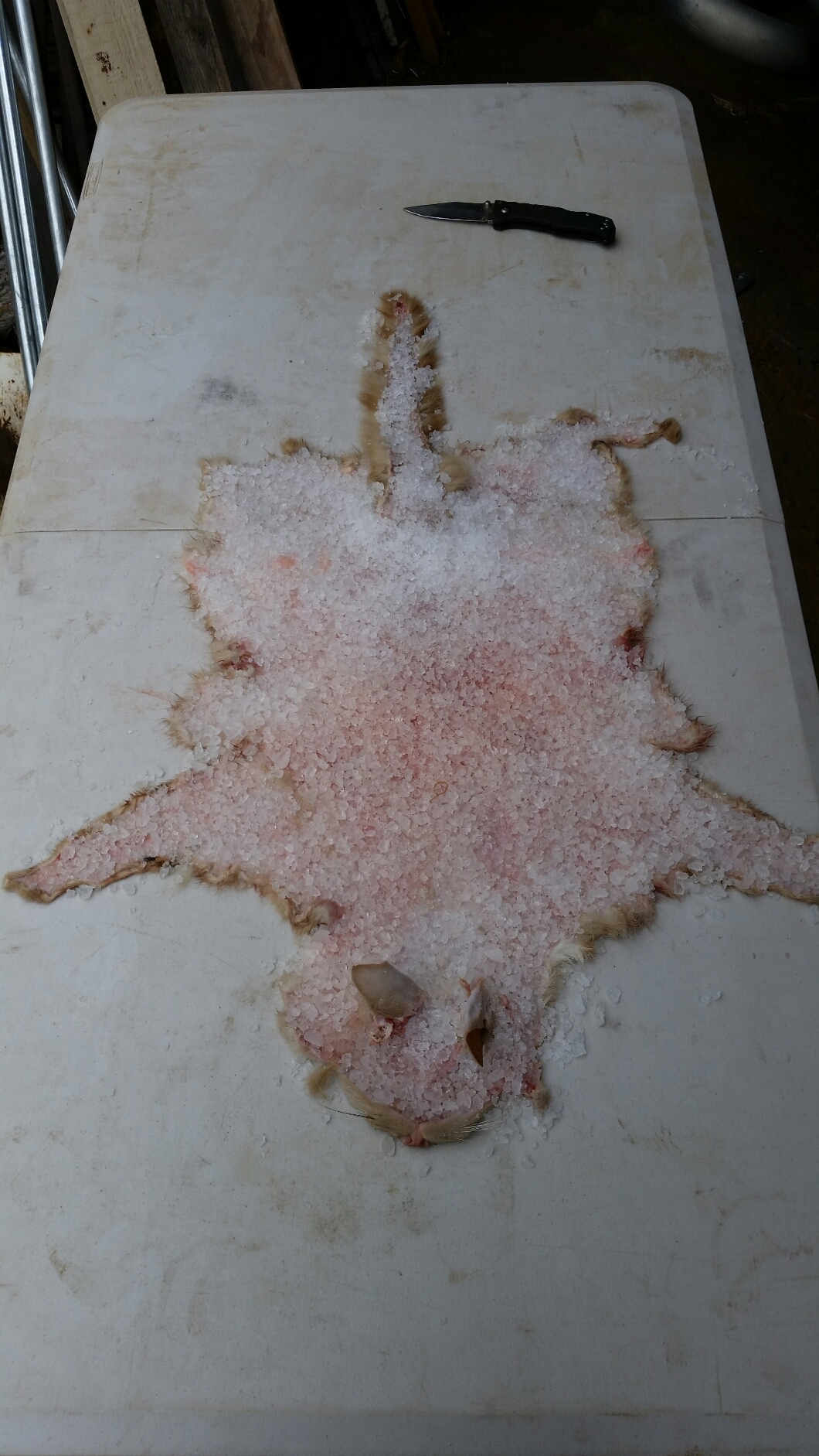

The day i salted it & started this thread, i ended up putting the salted skin in the freezer...
I did notice when folding it up, there was a fair bit of liquid run out the pelt through the bullet hole (entry right flank just behind shoulder-no exit).
The liquid, a pink colour very similar to what people mistake for "blood" that seeps from a rare cooked steak when resting, had run out onto the table & 'wetted' a fair chunk of fur (probably a good 5" patch).
You can see the pink colour under the salt in this pic...
Moggie may
2018-02-22 10.30.30.jpg (1.27 MiB) Viewed 11786 times
From memory on a youtube vid a yank did, he mentions the pink colour under the salt on his hides is a bacteria, & he wasnt too worried about it, however im guessing unlike this pelt, his weren't left for 36+hrs before being salted.
Im assuming this is the bacteria that will make the fur slip, so i hold grave fears this pelt is ruined.
This pink colour was not at all on the skin when i pulled it out of the fridge to salt it, so if it is the bacteria, its multiplied at an unbelievable rate once out of the fridge.
I was going to buy a decent tanning kit, but given i may loose the fur, ill do this one the cheap way...
Ive managed to track down this "alum" stuff at bunnings so ill give it a crack.
Its a shame i wasnt better organised with salt, because this fur really is unbelievable to touch...as soft, if not softer than a baby bunny...
And in my tiredness at 2.30am when skinning the mog, ive missed some of the back left leg...
Ah well...see how it goes...

"So im going to buy a 20kg bag & container of finer table salt & leave them on each farm from now on.."
My understanding is the finer grades of salt are better. But the coarse will do the job if that's all you have.
The pink MAY be the same algae that often grows in salt lakes. Only way to tell though would be a microscope. It's a primitive type of plant. Only time will tell.

Oldbloke wrote:"So im going to buy a 20kg bag & container of finer table salt & leave them on each farm from now on.."
The reason for the coarse stuff OB is because im like Daddybang...a tightarse...!!!...a 20kg bag for niks mate...
As i said, ill also have a container of the finer stuff on hand...
I gave this one a sprinkle of fine salt, & used it around the edges & head to ensure contact it the tight spots... :)
