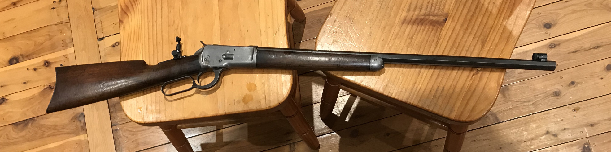

I finally got my mittens on a 1905-built genuine article:
1892 Half, 32-20
Resleaved + fine front blade
What's its purpose?
Pistol-cartridge, metallic silhouette + light-game hunting
What makes it so suitable?
Due to the following reasons:

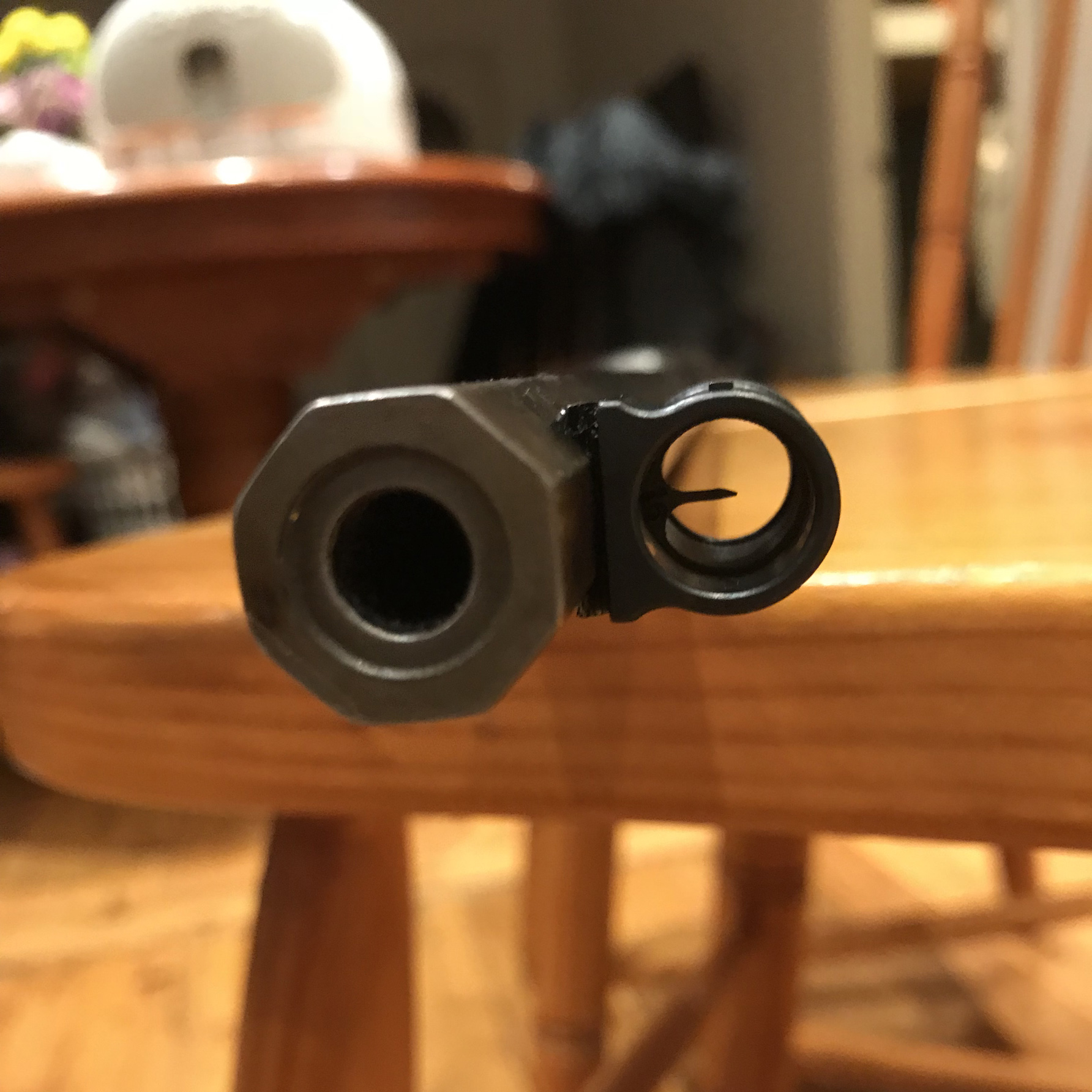

    1. 24", (heavyish) octagonal barrel
    2. Half length magazine (no barrel bands)
    3. Near new (resleaved) barrel
    4. Chambered in the light-recoiling 32-20
    5. Natively takes a tang receiver
    6. Very reasonably priced
How does it shoot?
Incredibly; not only is it inherently accurate, but more importantly, the long sight radius, super fine front post and low recoil equates to easily the most user-friendly (iron-sighted) lever gun I've shot to date. I see now why old Winchesters are so popular, and also why the 32-20 is sometimes categorised as a varmint round.

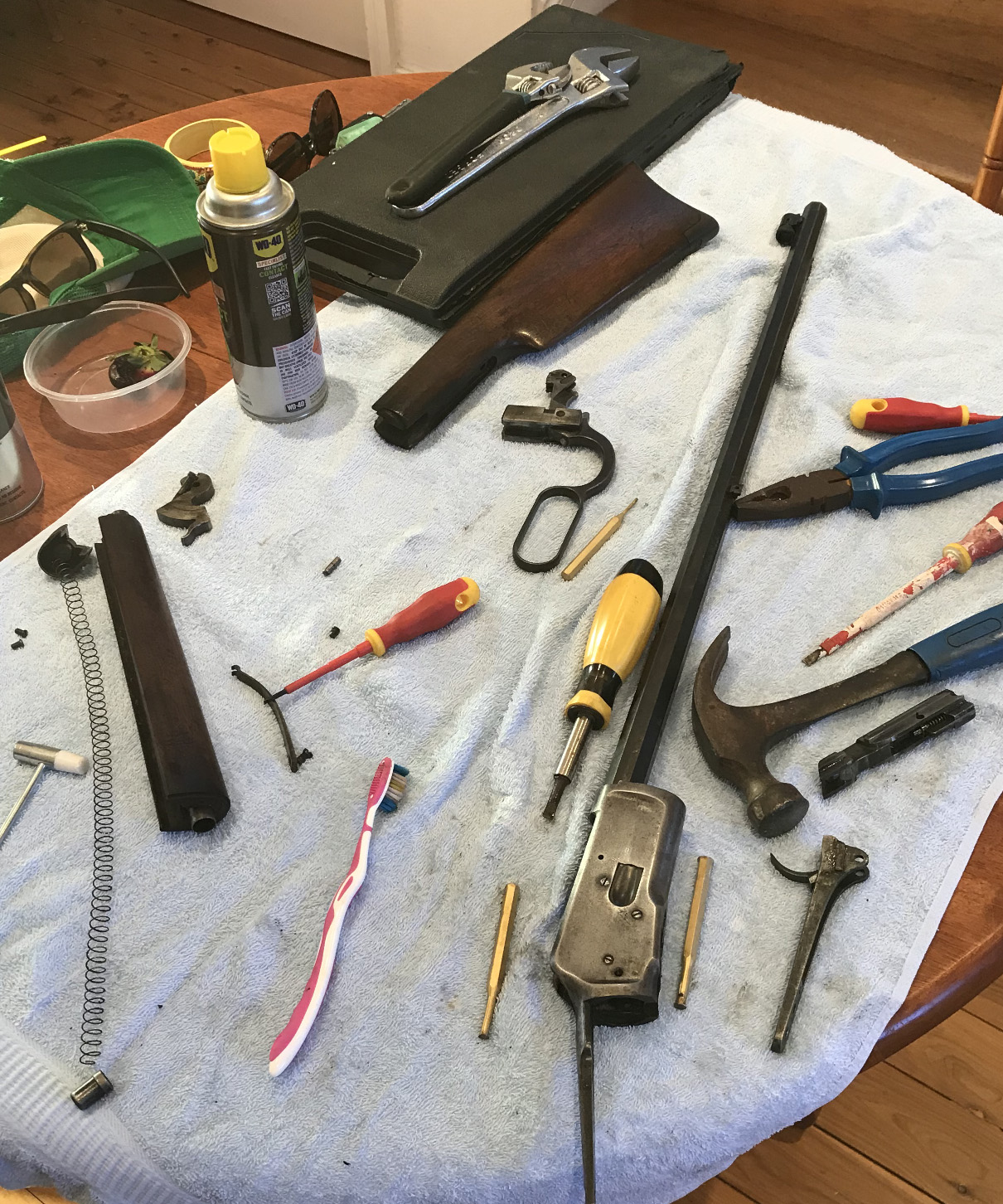

What condition is it in?
The barrel is immaculate, but the action was absolutely PUTRID, like it hadn't been cleaned in 113 years! So I firstly tried just spraying out with carb cleaner:
Sprayed with carb-cleaner (no dissasembly)
Then after realising how disgusting it was, a full disassembly saw a phoenix rise from the ashes:
Yikes

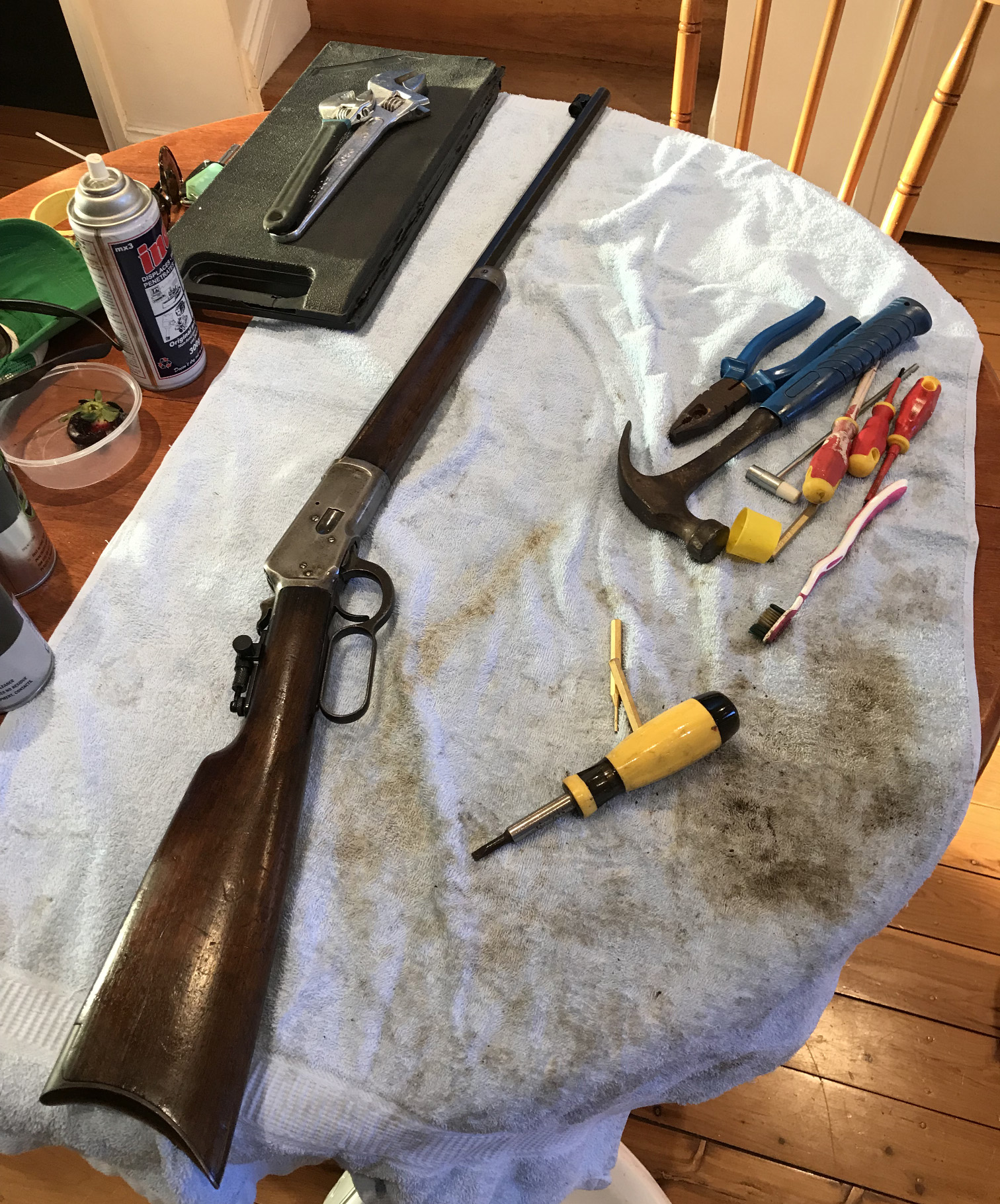

Post re-assembly

Nice job, what was the hammer for?
Re: Finally bought a Winchester....
Post by in2anity » 09 Jul 2018, 12:38 pm
SCJ429 wrote:Nice job, what was the hammer for?
Knocking the lower tang out (with a brass punch) - it was as if it were glued in place (from all the grime!)
