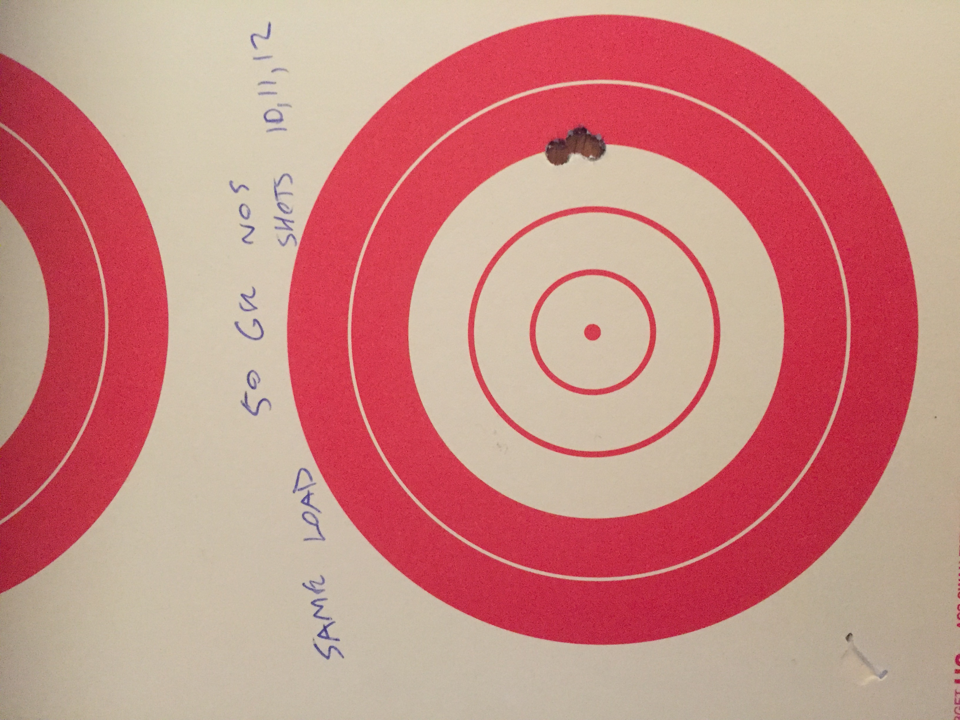

hey all, got a odd occurrence i want some opinions on. my old 222 Winchester shot some reloads this morning, the first 8-9 rounds were about a 1 1/2 " at 100, after that the same reloads were making one ragged hole groups at 100. this is a regular occurrence with this rifle. i can only conclude that the bore must be a bit sad and it needs a bit of copper fouling to tighten it back up. might just nylon brush the powder out and swab it without any bore solvent and see how it goes straight up next time . opinions anyone ? :unknown: :thumbsup:

i generally shoot three shots in the space of three minutes, then put it down for a while and shoot 22lr before going back to it. it seems odd, maybe it is me , i might get onto a mate who has a borescope and have a look. i can generally pick up my other rifles and shoot respectable groups straight up, maybe the barrel is a bit so-so :unknown: :thumbsup:

Bedding or barrel harmonics comes to mind. Maybe the barrel is touching the stock initially then slightly moving upwards with heat. The barrel channel is hotter than the top of the barrel making it curl upwards. Expansion and Retraction. Therefore becoming fully floated. Just a theory :D

theory proved correct. barrel not floating, just. barrel warming would make it full floating, bringing back accuracy. dunno why i didn't think of something so simple, duh ! thanks to professor stoney :drinks: now to find someone who can bed and float my old chinwester :thumbsup:
